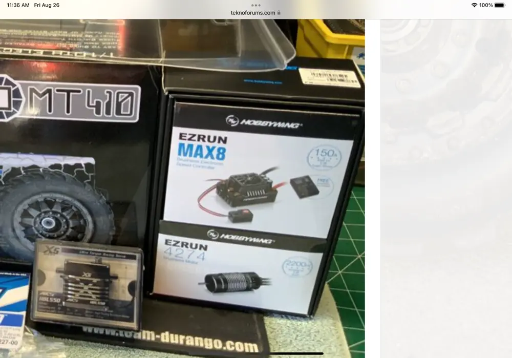

Have you looked at the new Max8 G2 with 2250kv motor..!!
My MT410 is getting a refit soon, I think I'll go with a MMX/TpPower setup or the new HW Max8 G2😎
The new motor is a 4278… 78mm long. As opposed to the traditional 74mm long truggy cans. Not sure it fits without ESC relocation.
Oh, that's a pain, I also noticed the sensor cable comes out the opposite end of the ESC making that wider too....😩

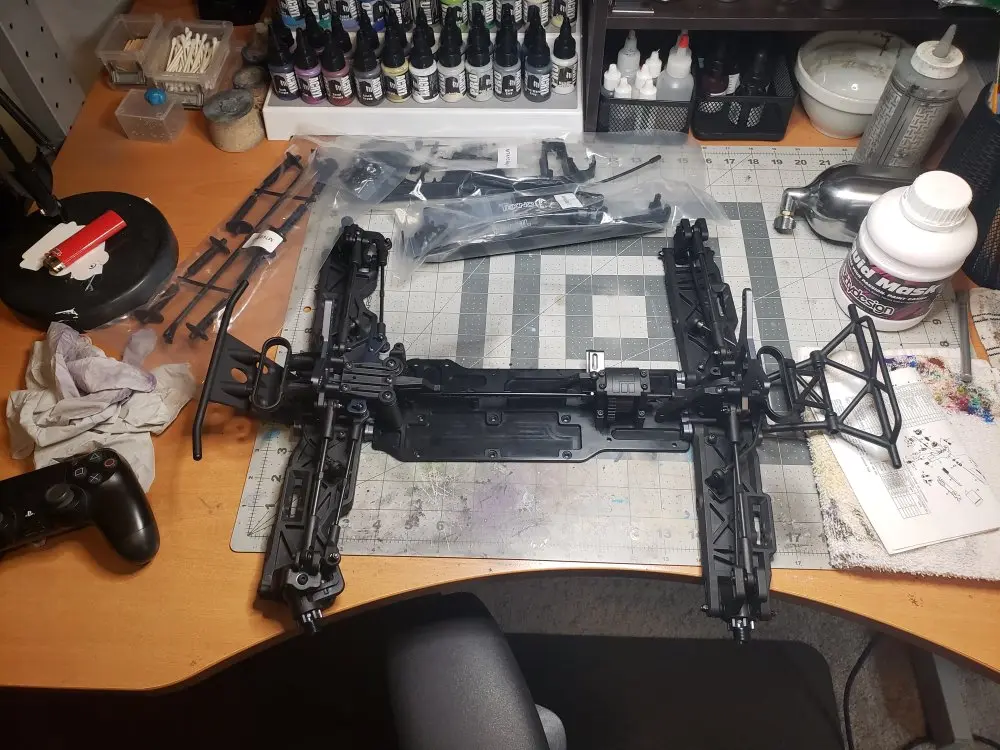

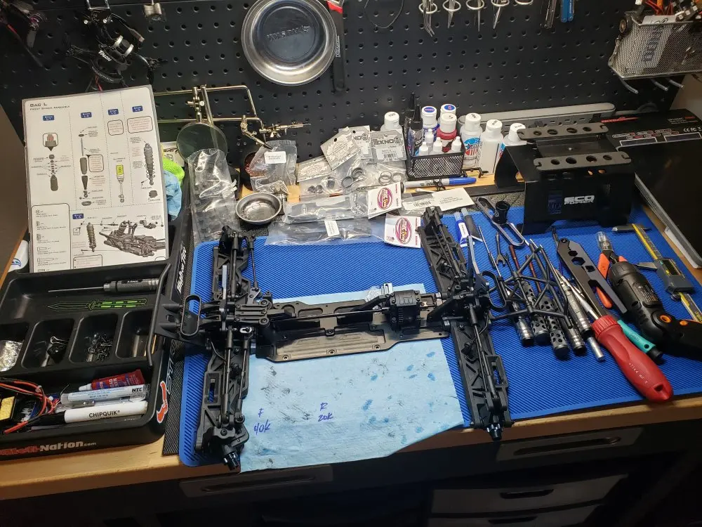

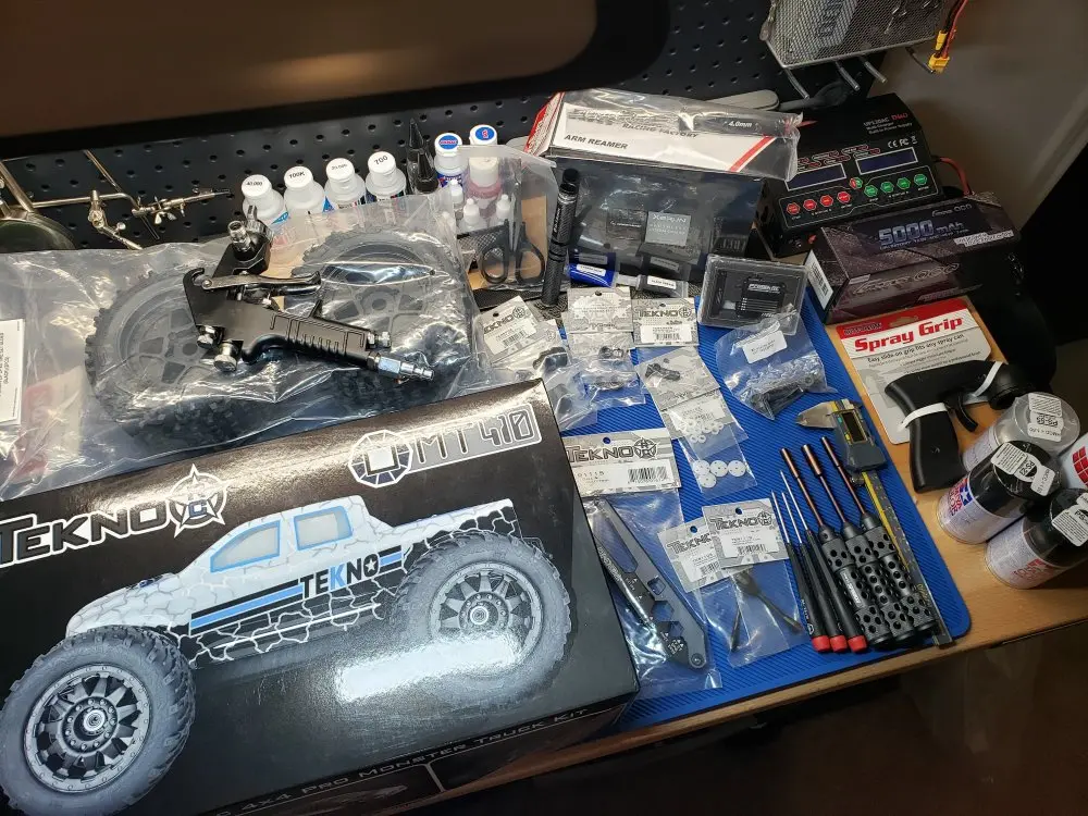

Everything is finally here!
Some progress shots!

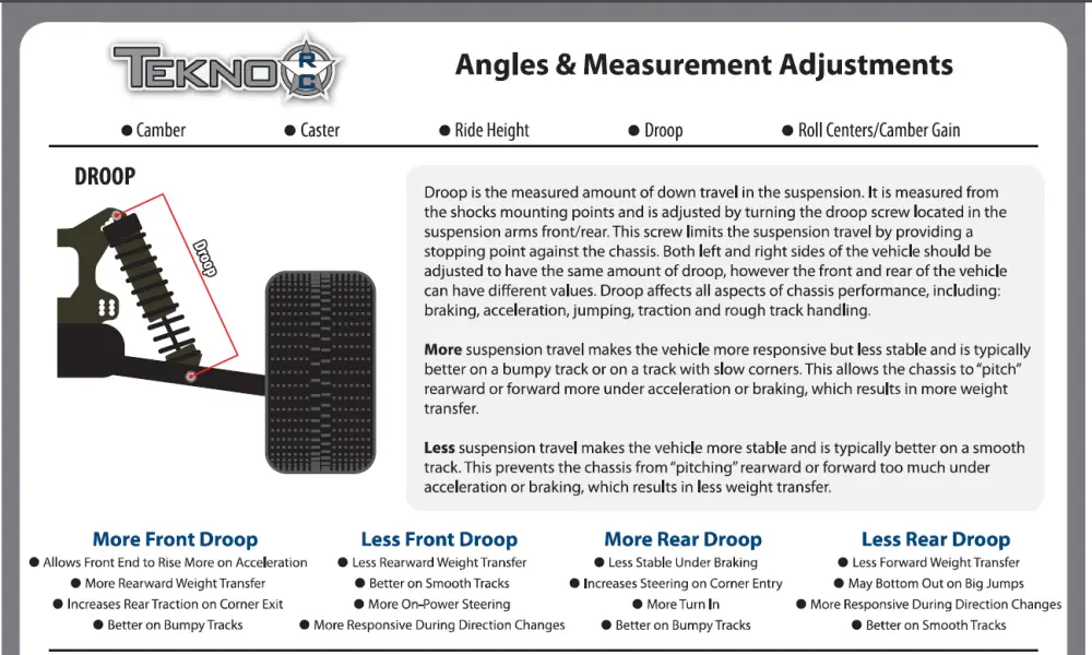

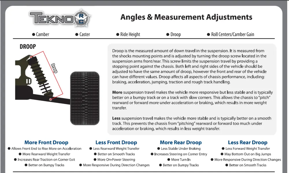

As I'm finishing up the build I'm looking up the droop settings. I can't seem to find a good diagram of how/where to measure the recommended 115mm from. I have 4s backflip tires that I'll be using. Can someone post a picture of what this measurement looks like? Some of the pictures I've seen are just the shock, which tells me nothing. I also saw some posts where the droop tabs are cut off or the screws are not even used. I want to build it up as stock as possible first to get to know the truck.

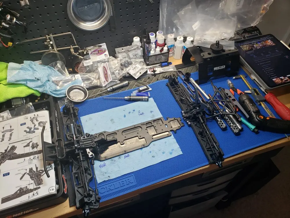

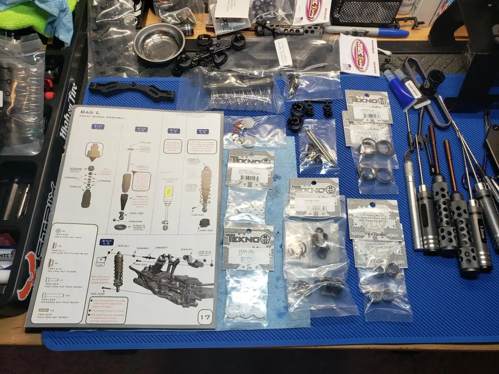

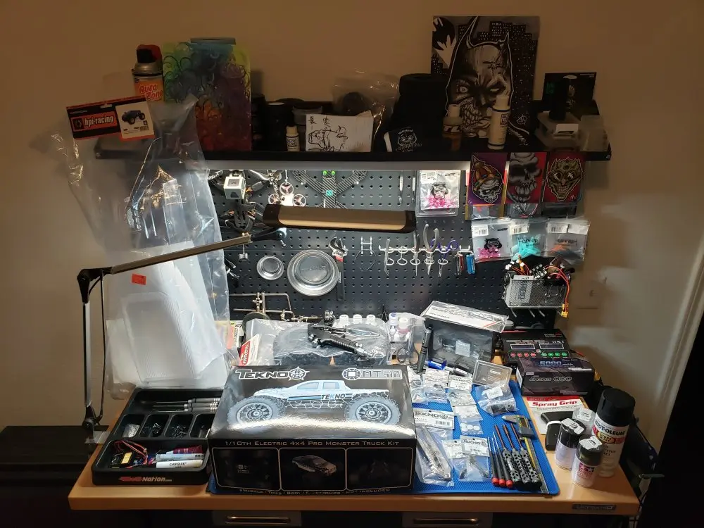

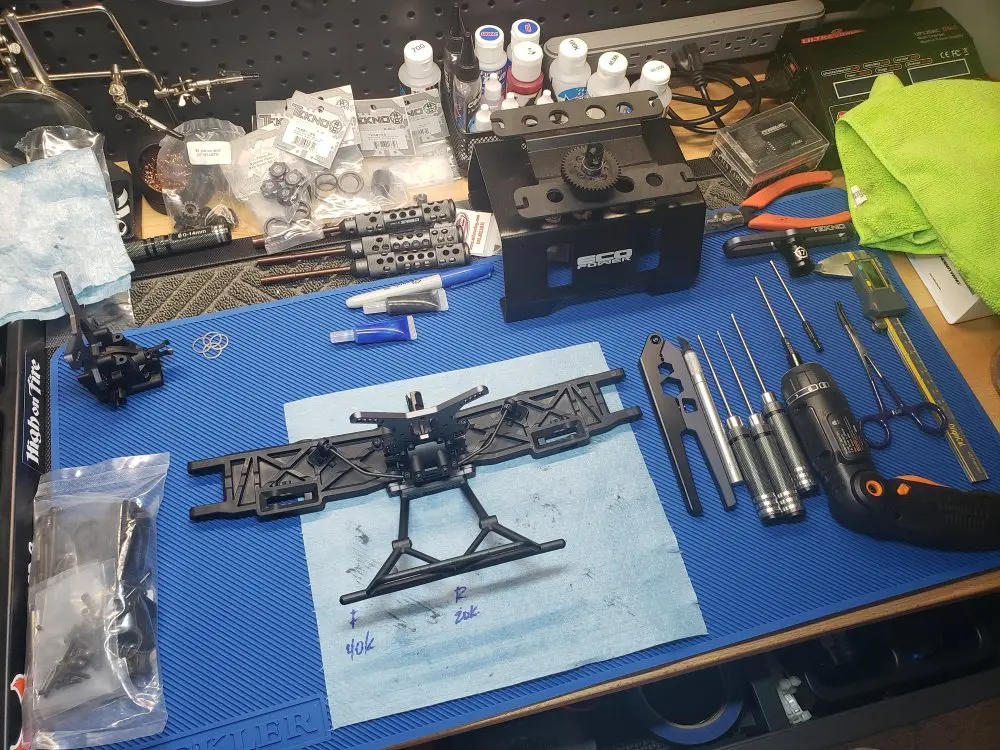

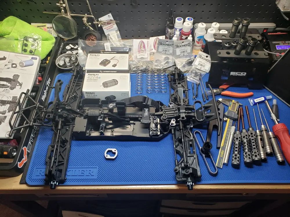

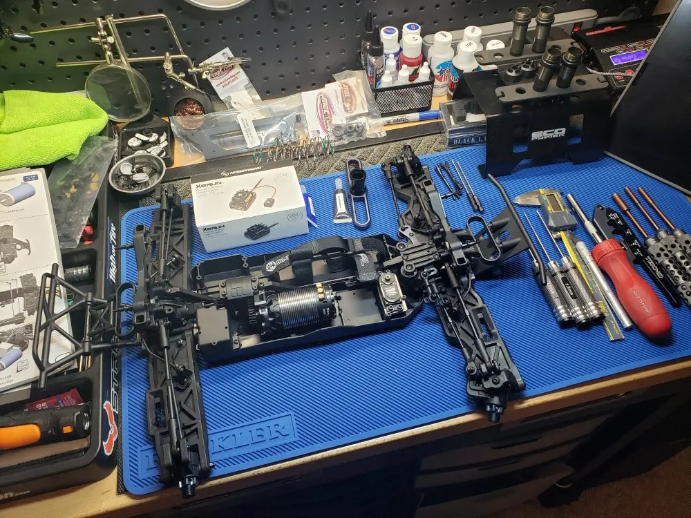

She's almost done!
Thank you! Is this also measured with the truck suspended or on the ground. Would i have to adjust the shock collars to hit the 115mm as well? Right now just lowered them so the shocks springs aren't sliding up the shaft super loose.
You would measure droop with the suspension fully extended. The shock collars add or remove spring preload to adjust ride height. These are two different things. Adjust the droop with the screw in the arm. If you can't get to where you want to be a small amount can be had shorter or longer by loosening or tightening the lower shock mounting eyelet on the shock shaft.
