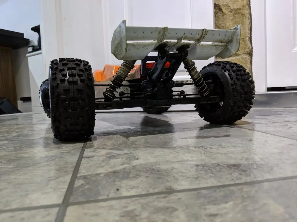

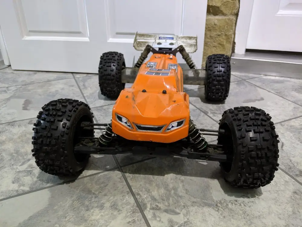

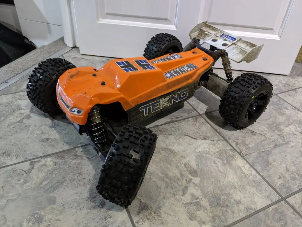

Just fitted a set of badlands 3.8's to my ET48.3 as the Dboots Katars I had previously had all ripped from a bit of 6S action!
These tyres look absolutely awesome and give the truggy a more aggressive look and a bit more ground clearance as well as a lot more traction I'm sure.
The tyres have all been taped with duct tape so hopefully they hold up this weekend!
To note; to fit these wheels you need the 2mm offset hexes #5071C the wheels will not fit properly in the standard width hexes as the hex fitting in the wheels is too deep.
