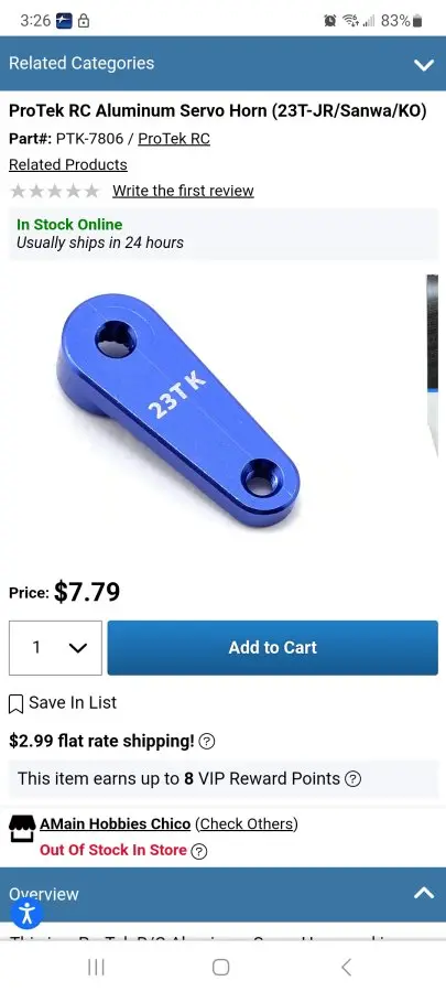

This one looks close and might be worth a shot for $8. I didn't realize how low profile it needs to be... still in the process of building my et410.2
ProTek RC Aluminum Servo Horn (23T-JR/Sanwa/KO)​

I don't remember why but I used a similar clamping version of the Protek horn. I had to clearance the Akerman plate a little to get it to clear the horn. I think I might have been trying to spend the money with my LHS when I bought my servo and that's what they had.

The problem with the 1/8 horn is that the arm will be too long and will not clear the bulkhead on the EB410.
I've seen many folks attempt to run aftermarket horns with limited success, if it were me, I'd find a 25T servo and use the TEKNO horn to play it safe. Most aftermarket horns will place the linkage at an odd angle which will jack with the geometry making the steering progressive instead of linear.
