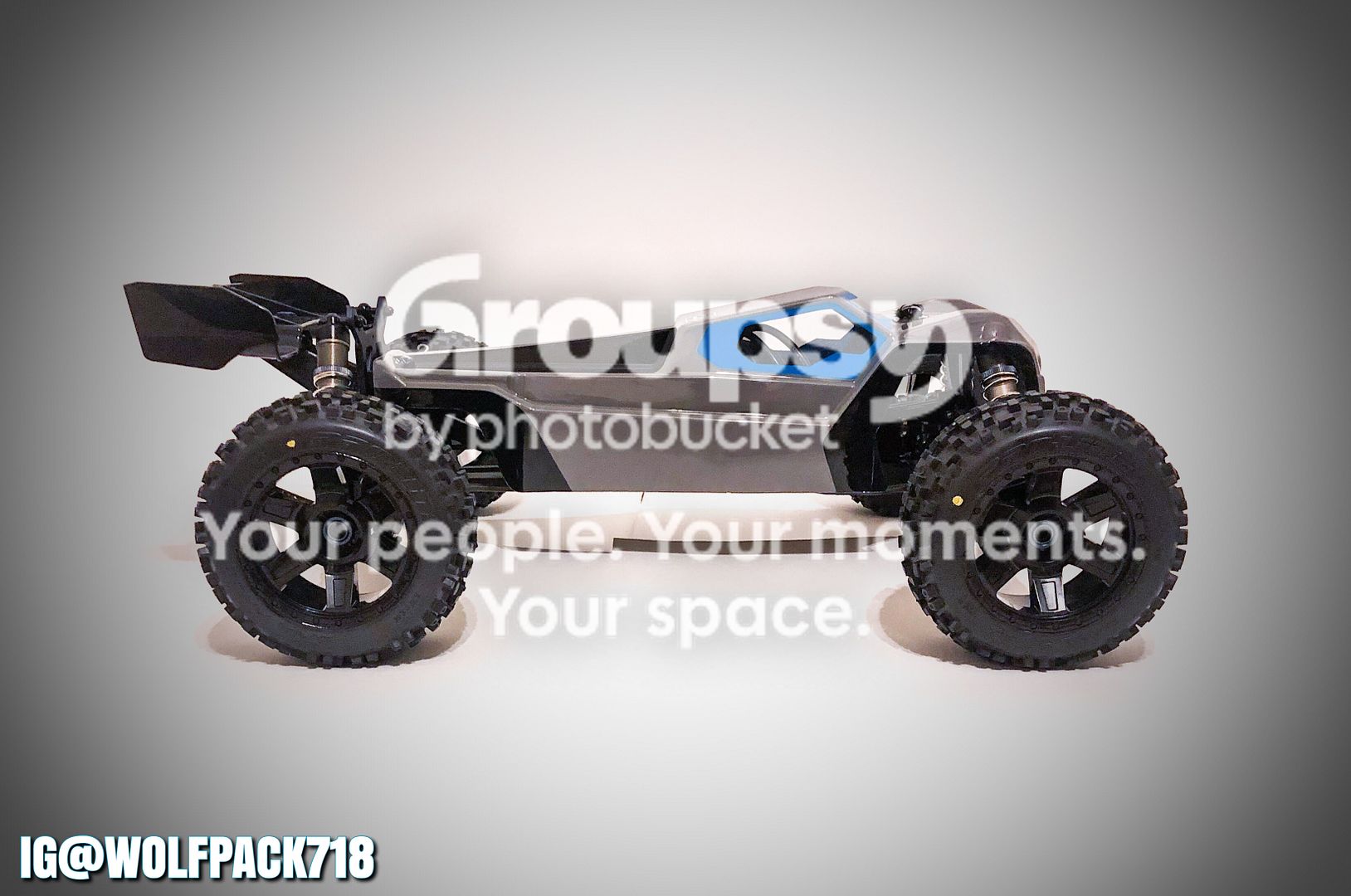

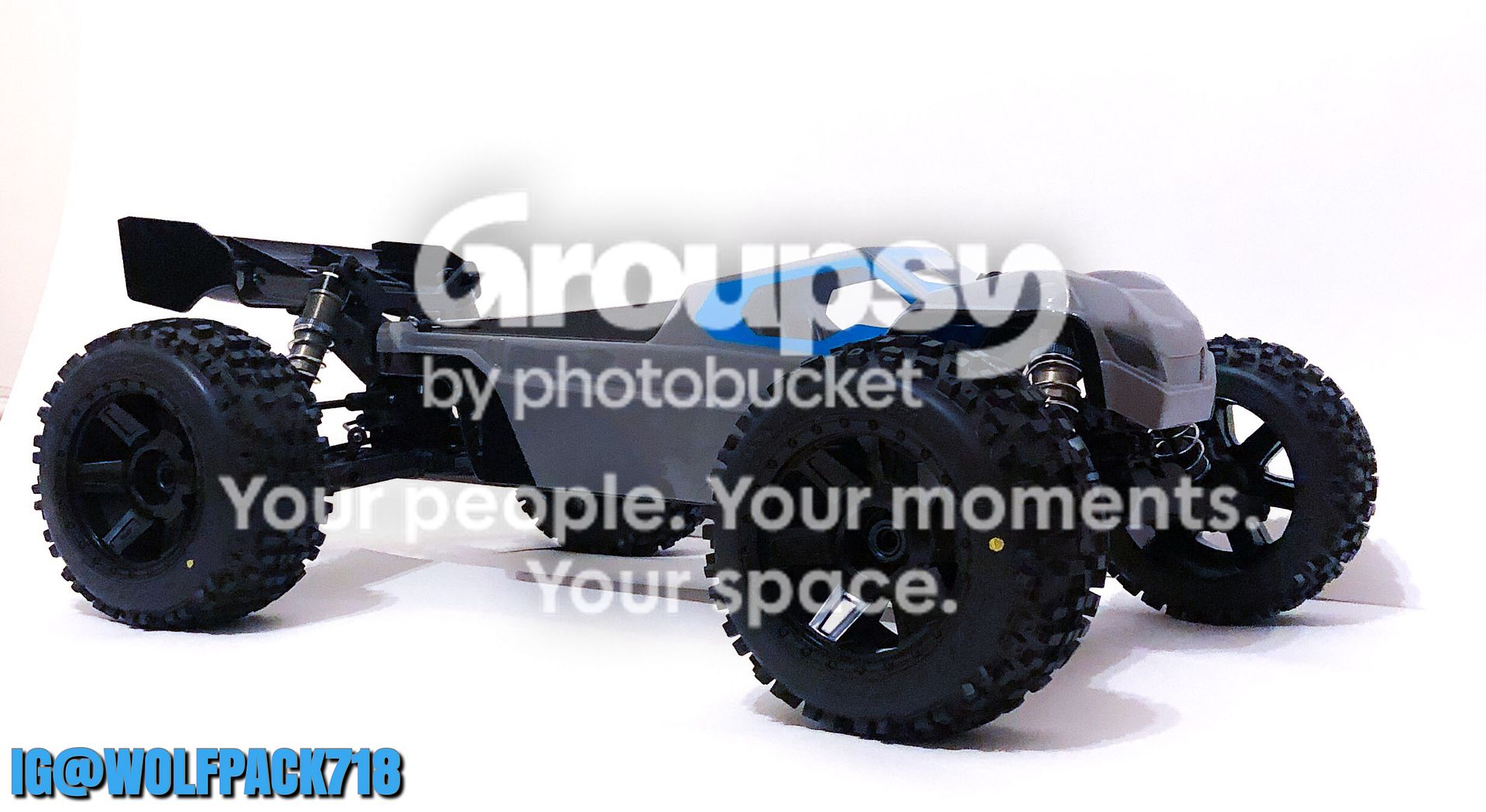

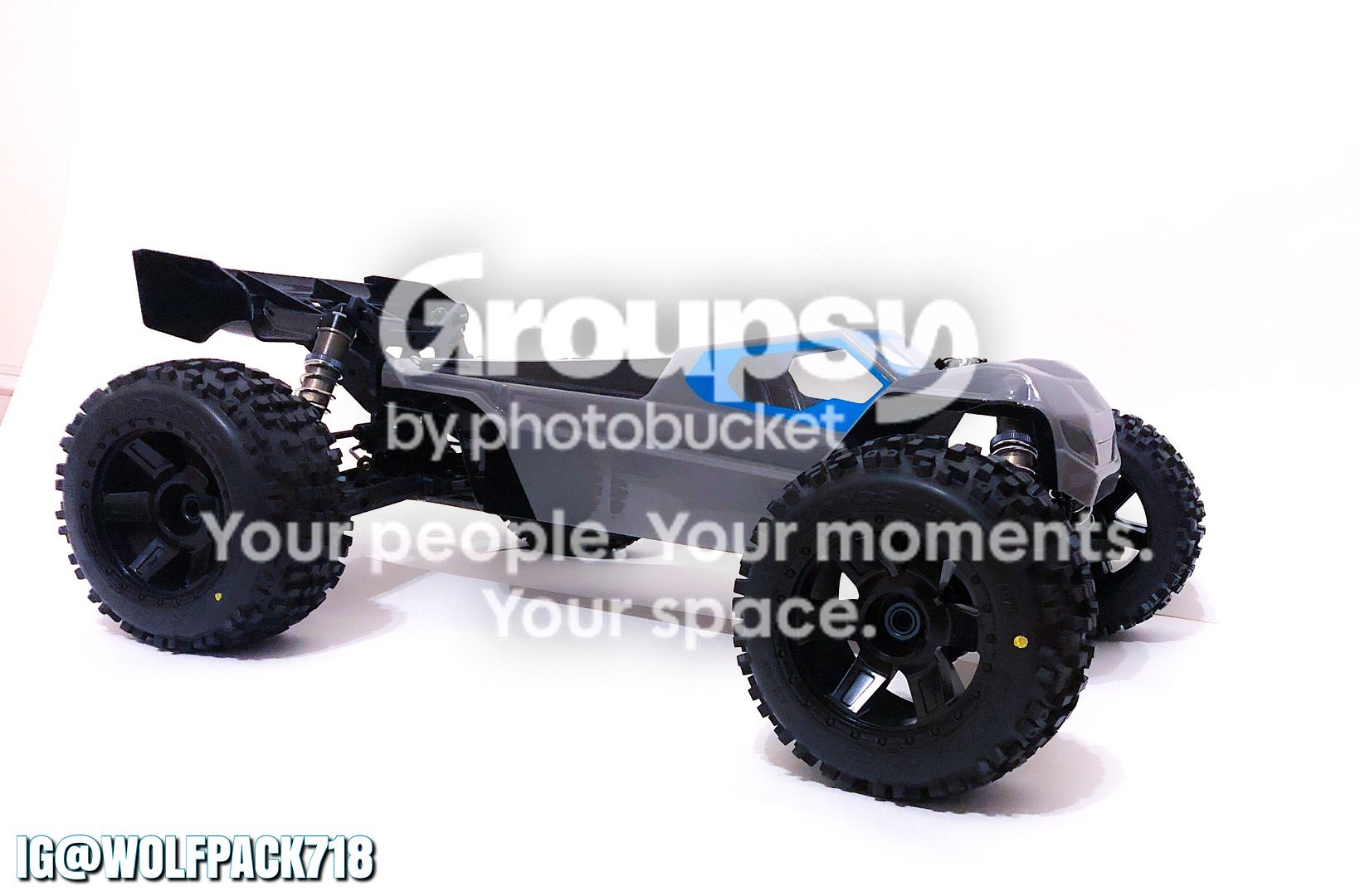

Well I’ve built my truck but it is still missing electronics and mods so here I will update with that stuff.

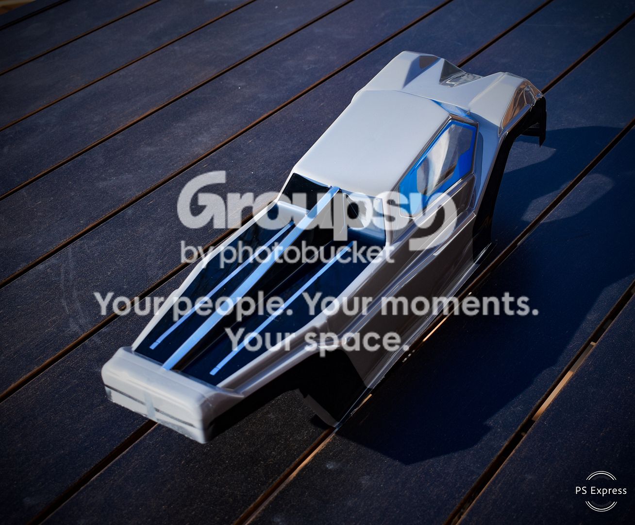

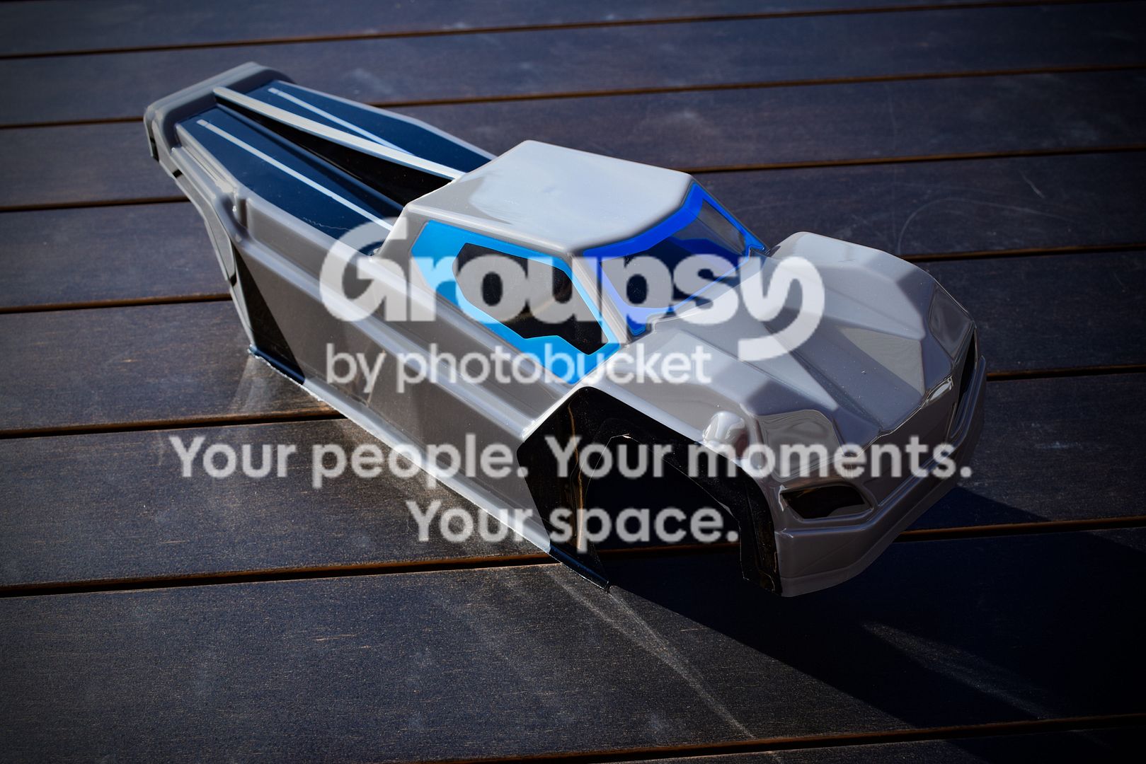

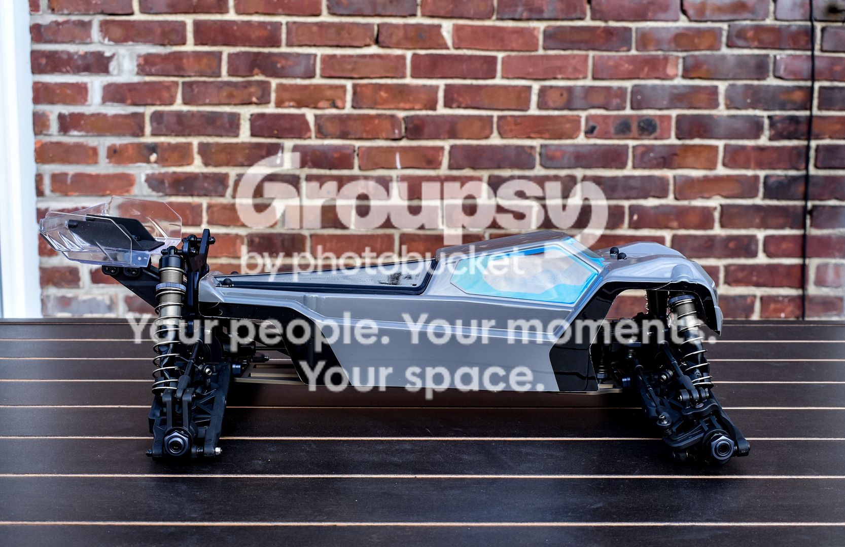

The body:
Stock
-secret Nardo Grey ;)
- Tamiya light blue
- Spazstix mirror chrome
-Tamiya black
- Tamiya 3mm & 6mm masking tape
- Tamiya Grid mask

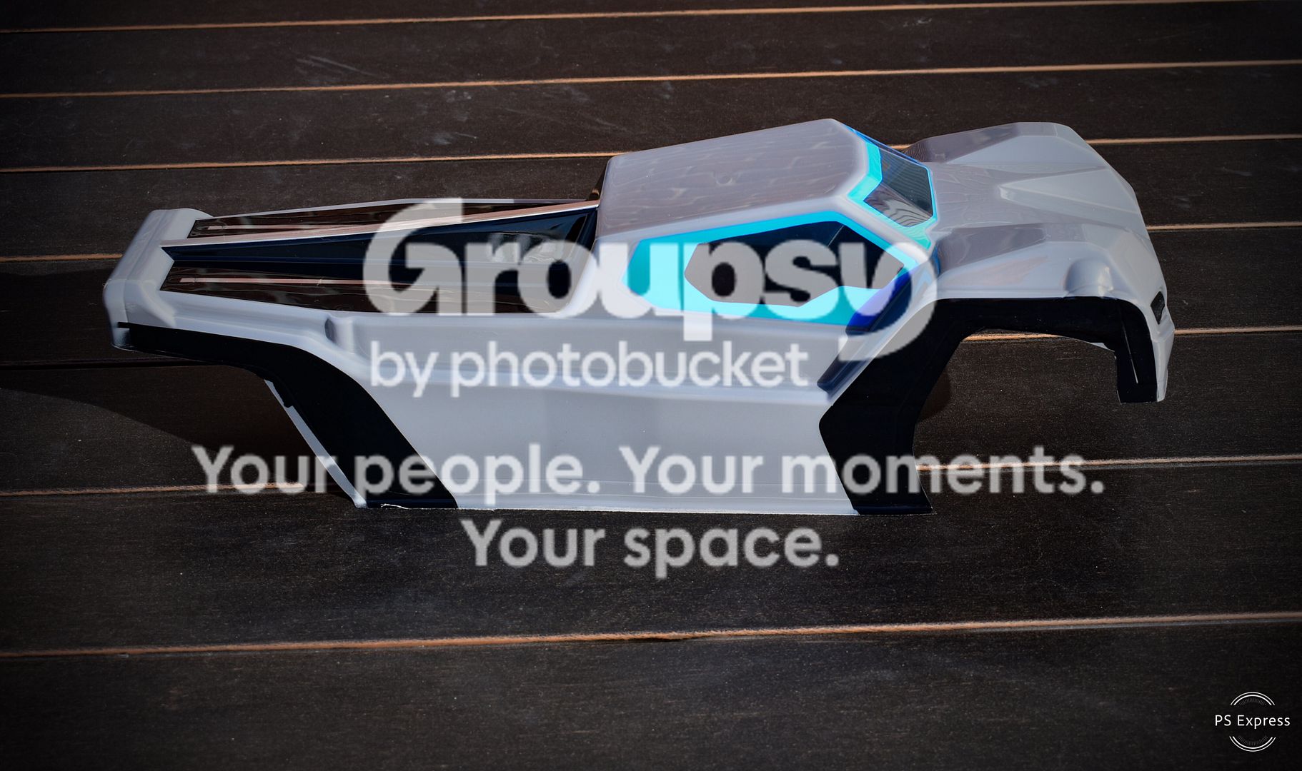

“How to make the most hideous body in RC look sorta cool” was my goal
I will cut and shape it soon and update mounted

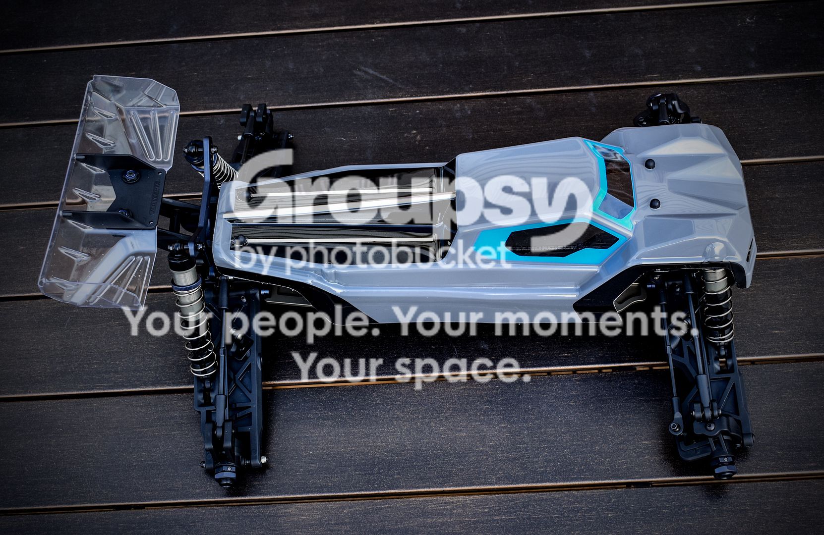

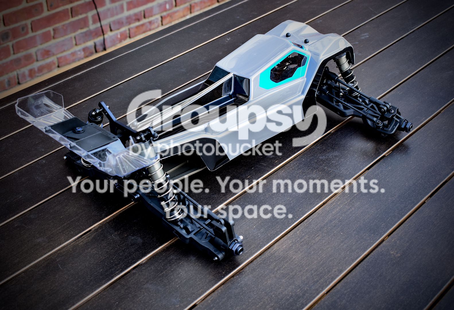

Test fit on chassis with wing that will soon match the scheme
The Grey and the blue have color tonal effects in the sun and out of it. I focused on taking out the length of the body and playing on the “military” theme of the shapes. I was going to matte most of the blacks but I think it looks sleeker glossy.

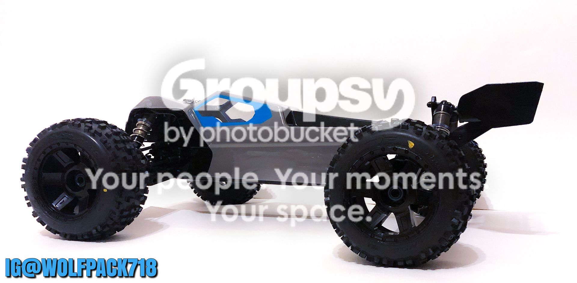

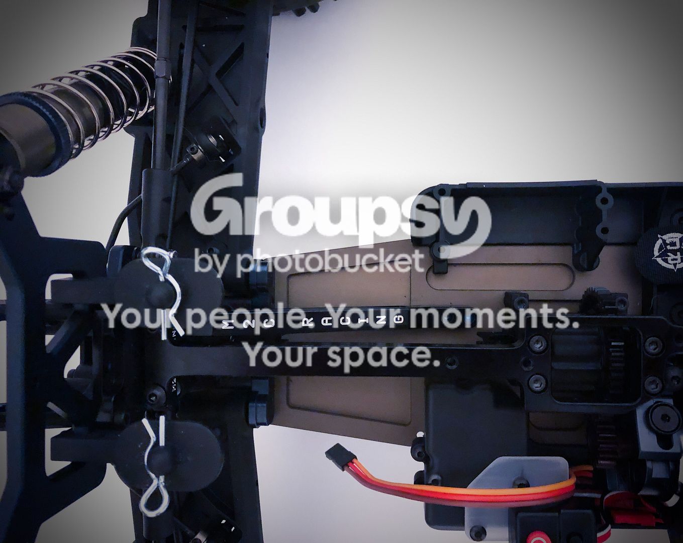

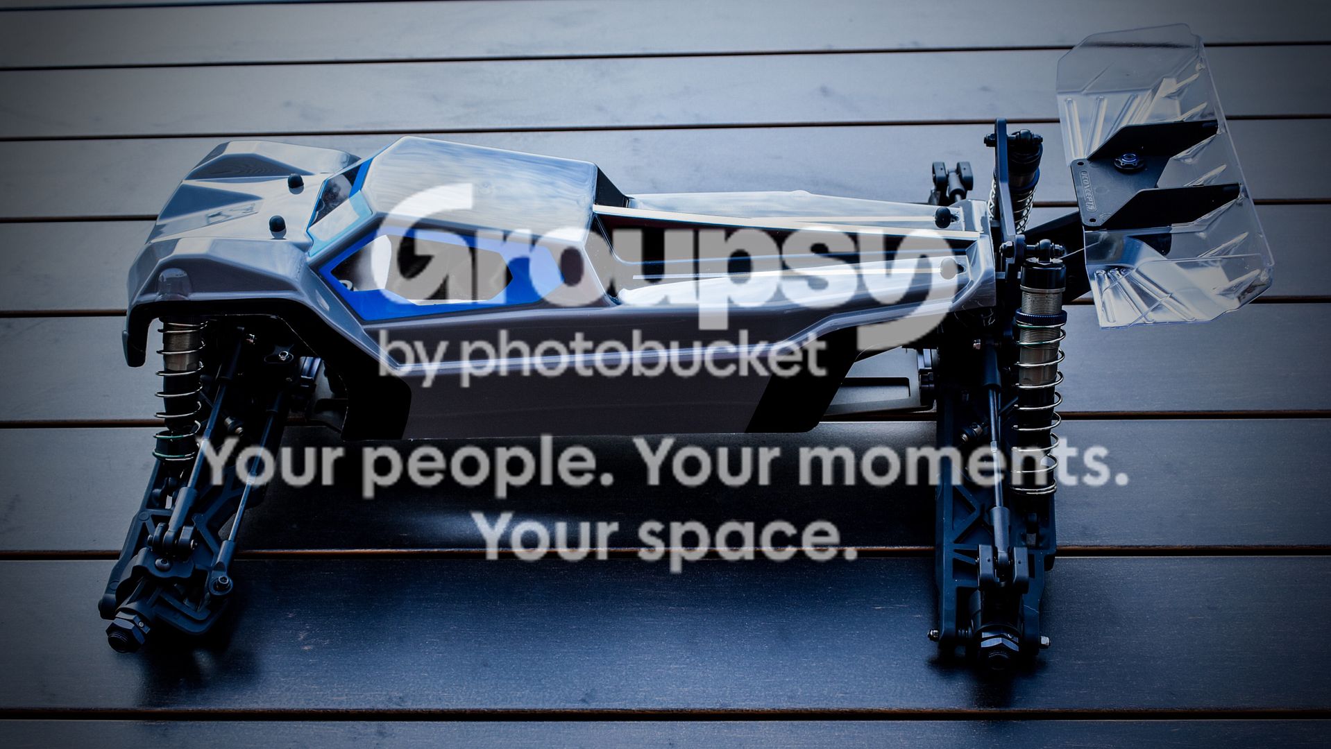

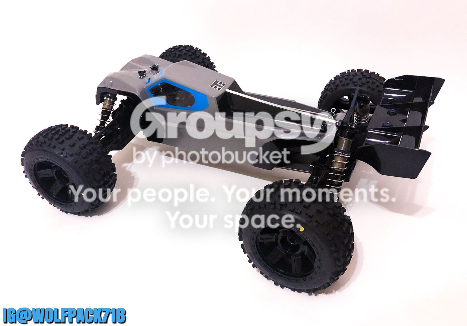

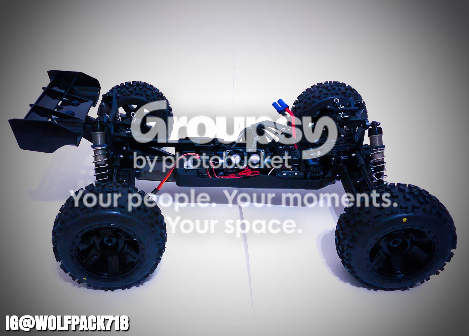

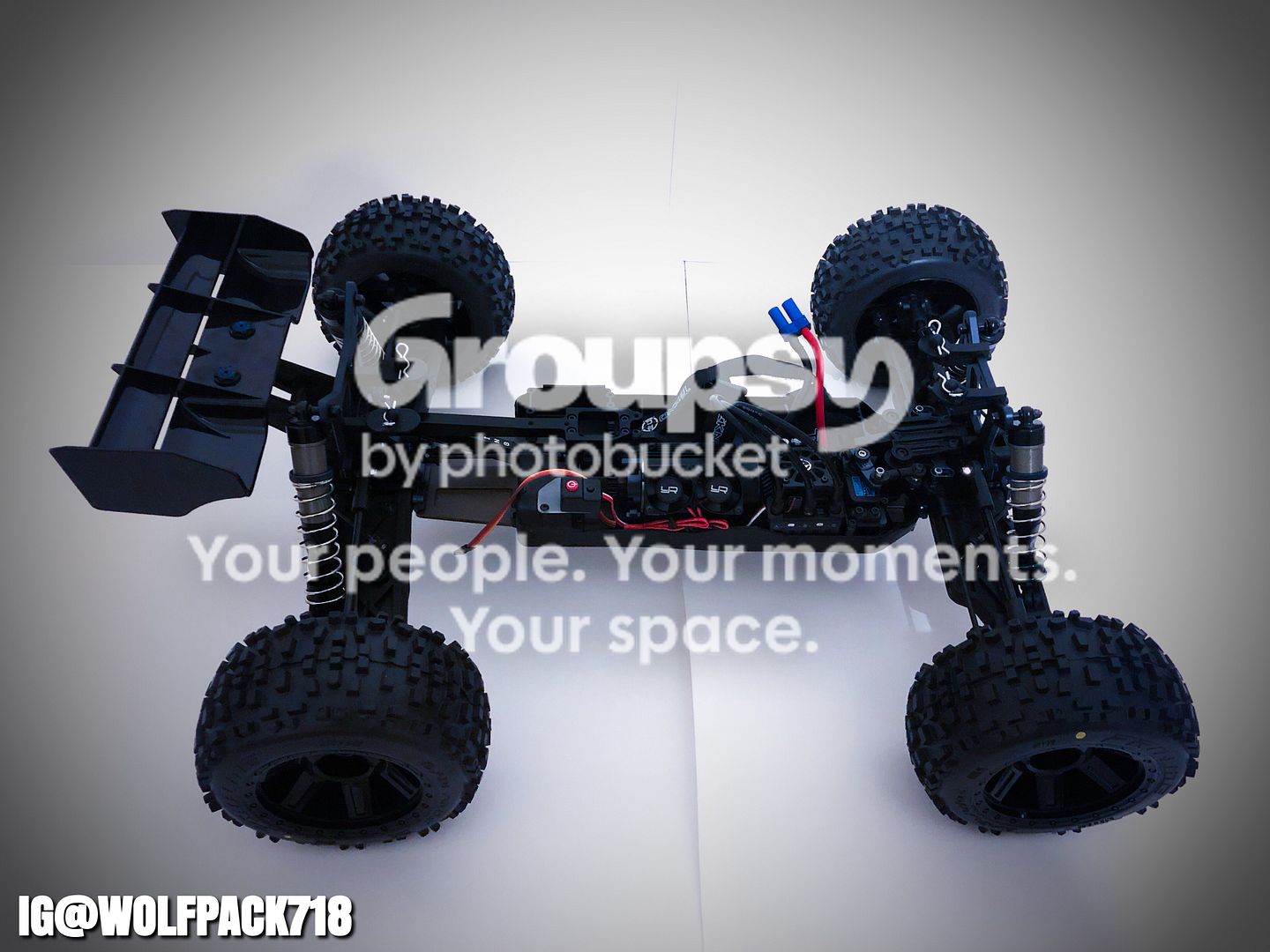

Finally some photos of the build it’s almost complete .... for now.
-Stock diffs and Fluids for break in, will switch after a few packs.
Mods : (I’ll add part numbers soon)
-Tekno lightened steel spur gear 44T
- Spring steel pinion set
-M2C rear center brace
-M2C rear chassis brace v3
-M2C shock tower brace/ mount
-Tekno +2mm offset lightened hub axles
-Tekno aluminum servo horn
-Sumo HD stainless steel Skid pads.

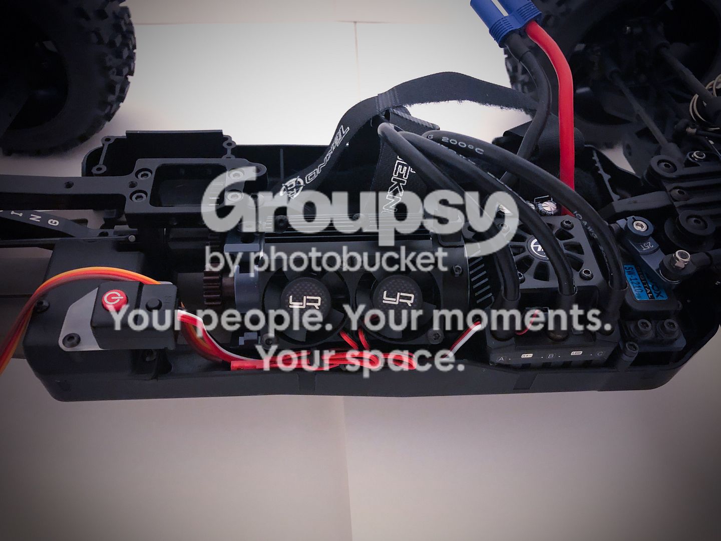

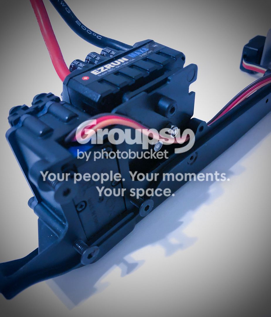

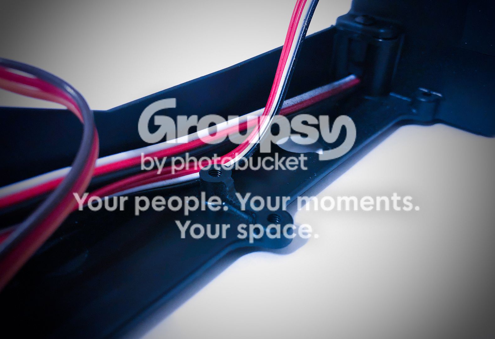

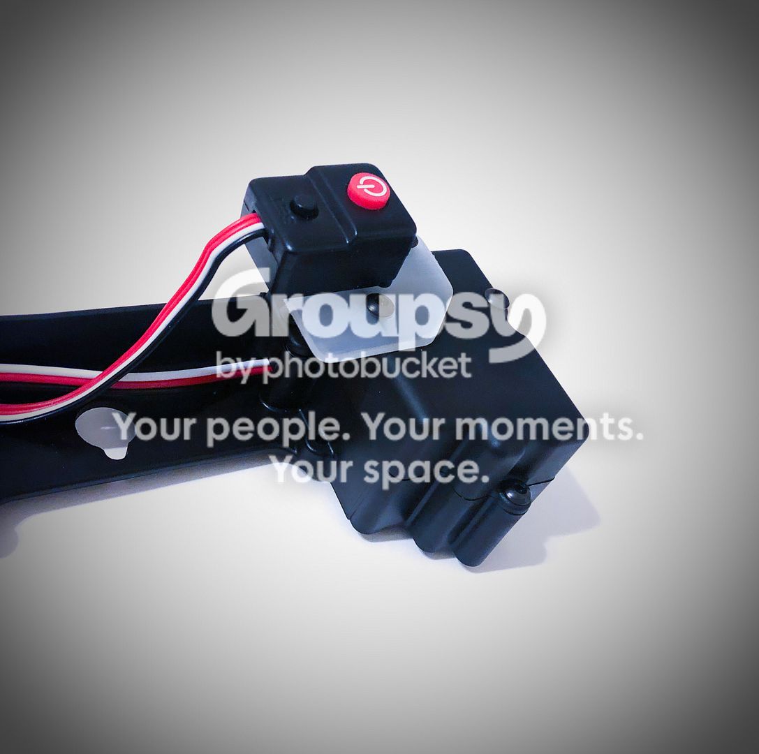

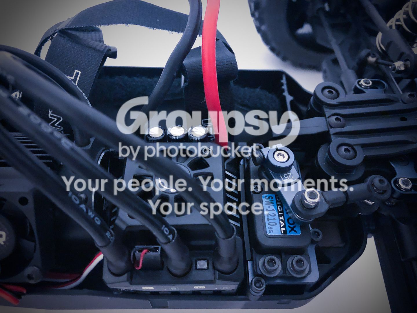

Electrics :
- Hobbywing Max8 combo 2200 KV
- Savox SW 1210 SG servo
-EC5 connectors
-Turningy Graphene 4s Lipos
-Yeah Racing twin fans with heatsink
-Airtronics M12 TX

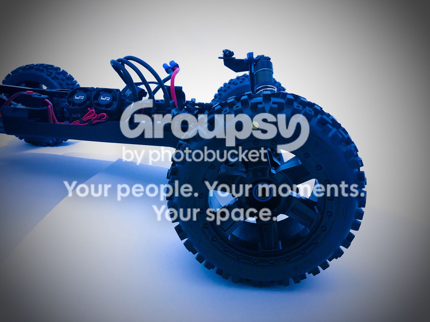

Wheels/ Tires :
-Proline 3.8 Badlands mounted on Desperado wheels (Revo size for ref)
