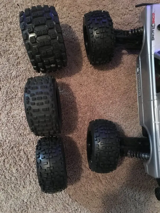

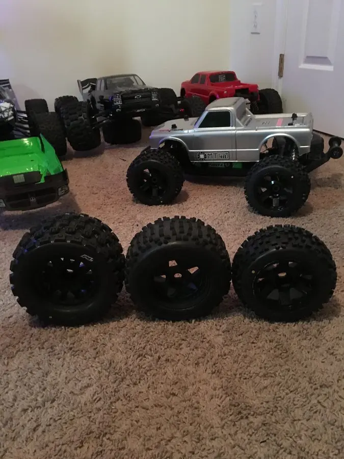

Here is a little size comparison of the mx38 badlands, dboot backflips, and original badland 3.8 for anyone trying to decide. The difference in size and performa is huge. Different tires really change the handling of this truck. I cant believe the size difference just between the 2 different badlands. Does anyone else have a different tire you like on the mt410

Due to the difference in diameter, moving from the Badlands 3.8 to the Backflips adds about 14% more gearing/speed. The equivalent of going from a 15 to 17 tooth pinion. The MX38 add about 18%. That is a lot more load on the motor, and doesn't yet account for the difference in rotating weight.
Backflips are great with a few changes in the shock setup. They allow full steering while being 0 offset, are not too heavy and don't balloon as much as mx38s.
Rims are ugly af though.
