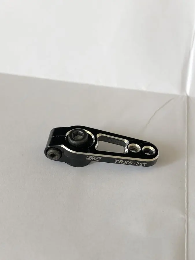

I’ve got this SRT servo horn which isn’t really needed from my Pro MT 4x4. Do you reckon this would do the job?

@Chevys10zr2003 thanks for the advice (y) I was leaning towards the Backflips as they seemed a happy medium between the big MT wheels and the standard Badlands.
It will work but you will have to use some spacers to get the Ackerman steering link back in line. Nice to use parts you have but i would put this on your next order.

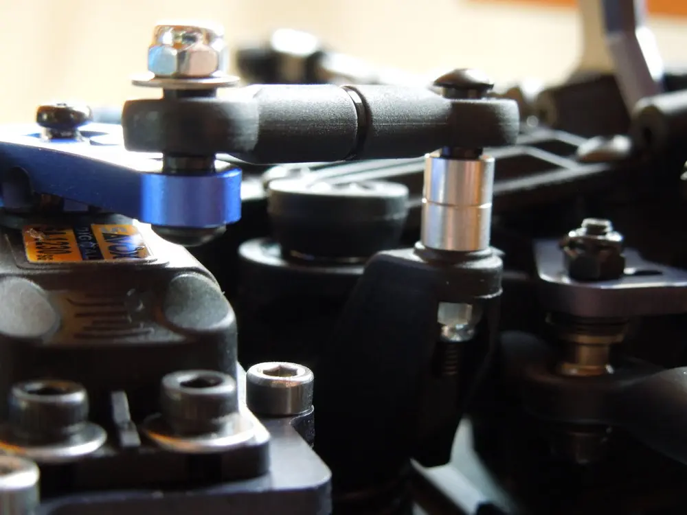

Tekno Aluminum Servo Horn (25T)

@Cmbscx10 beat me to it lol. My little humans were asking for breakfast so I figured I should make that LOL. I was going to say it should work as long as the tooth count is right and you may need to shim it.

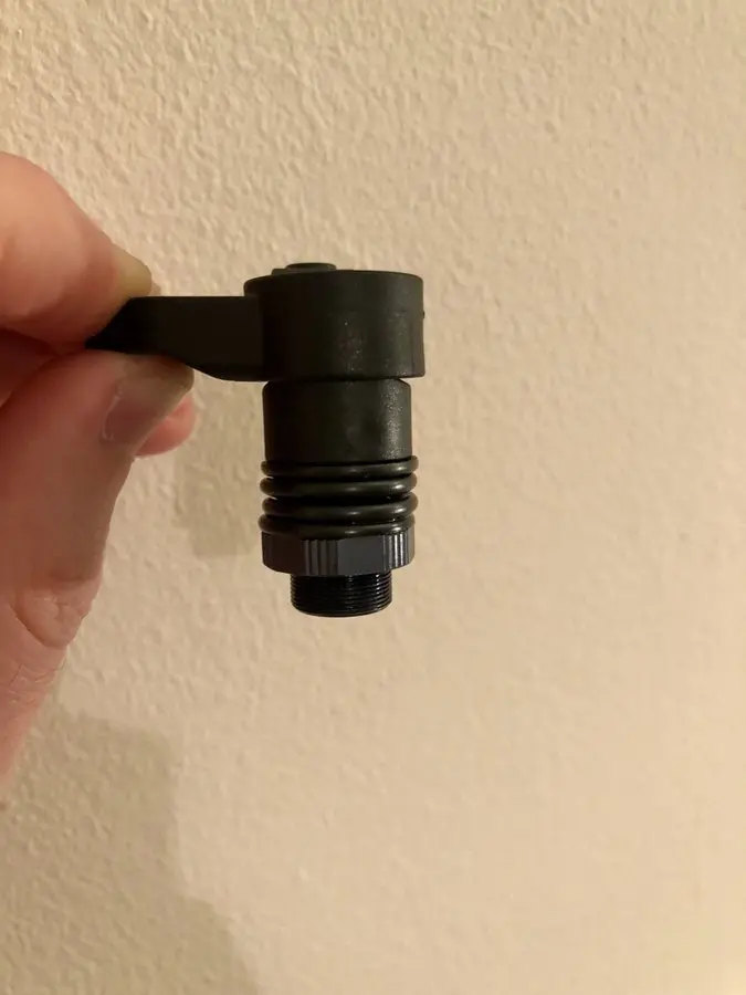

Progressing well through my build, currently doing the servo saver and got a quick question.
The instructions say tightened the nut all the way down and then back it off 3 complete turns. Which looks like this...

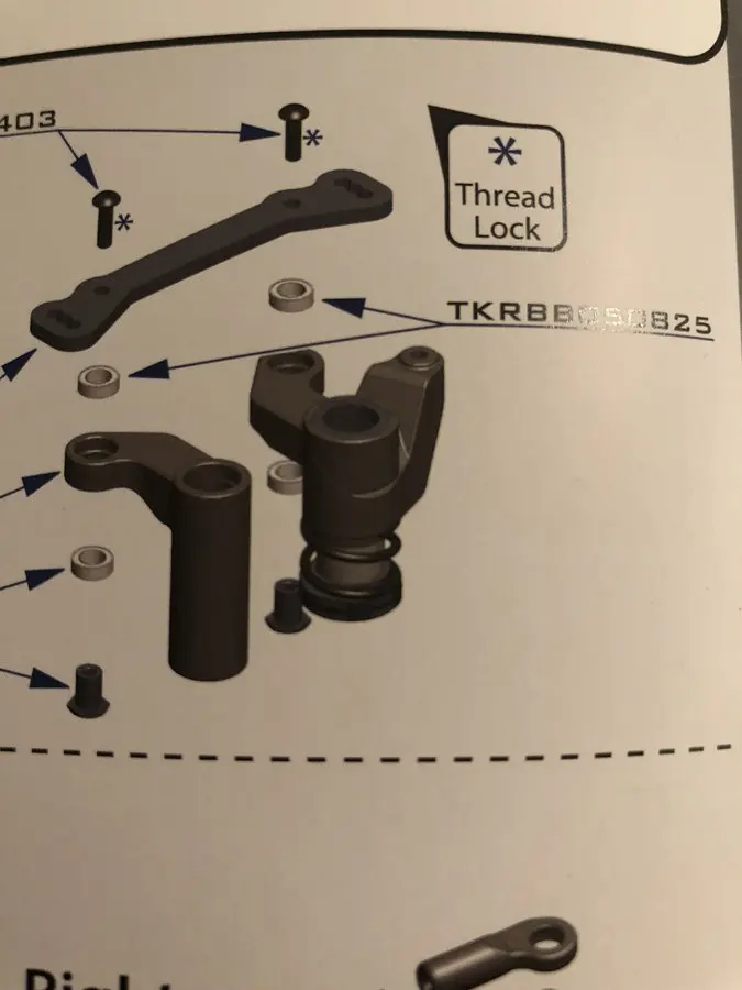

But on the next instructions steps it’s show backed all the way off.....
Do I stick with current 3 turns setting or back it right off like the picture?
Thanks guys (y)
For my SCT and MT I followed the written text over the shown image. I haven't had any issues with it, but both of mine are less than a year old. I'm sure the image is just taken from a 3d model and that's just how the assembly of the model on the computer works.
