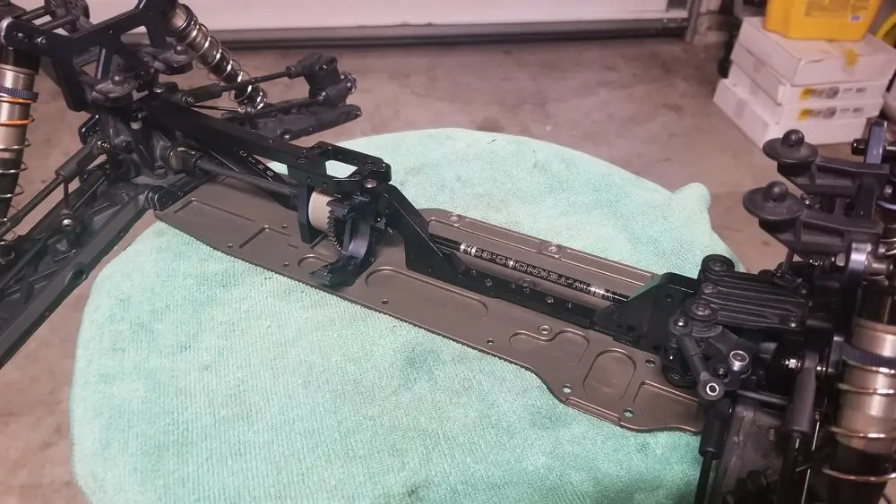

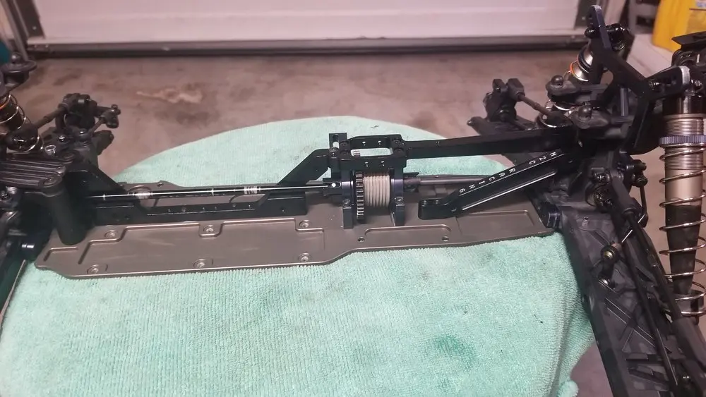

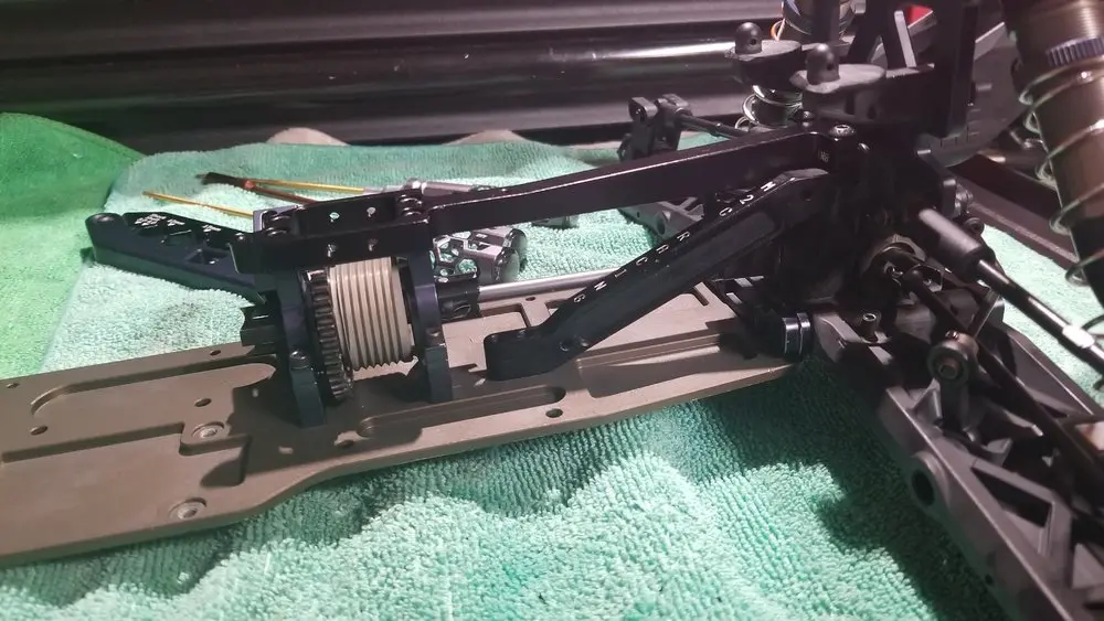

I run the aluminum split center diff in all 3 of my Tekno's, as well as the M2C Aluminum diffs, front center and rear. I did it mostly to be able to run 2.5 times the amount of fluid more than because I thought the original would fail for some reason. The center diff cup also has a heat sink built in to help keep temps down. I also run the rear aluminum chassis braces on all 3 rigs, but you need to run a longer screw on the rear housing end of it as the stock one is too short and I stripped it out a couple times before I went to screws that are 6 or so mm longer. Never had an issue since. If you ever run the longer ET chassis I would recommend the M2C center diff to rear bulkhead brace also as that really beefs it up. On my ET I have that, the M2C rear chassis brace, (long), the M2C rear shock tower brace and their one piece brace that replaces both the front and center stock braces. That will fit any of the 1/8th scale rigs as well as the SCT. Combining all of them makes the chassis super rigid, great for bashing but noticeably stiffer for rough track racing. I got back to the stock plastic braces and remove the top center to rear bulkhead brace when I race. One other nice thing about the big rear brace that goes on top is that it comes with an aluminum plate which mounts on top and just behind the center diff giving you an option to mount your ESC there
