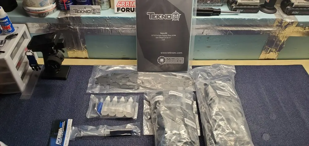

hello tekno fam! My mt410 if finally here ? so I figured I'd start a build tread. As everyone else has already stated about this kit, the quality is outrageous!! When I first opened the box, it smelt like a pair of nikes but better? gotta love that new rc smell. Im going to begin the build tonight. I went through the whole manual and I gotta say, im a bit intimidated ? I've never built a kit before so I hope I didn't get in over my head. Hopfully you guys can help me out if and when I get stuck. Thanks guys and I'll be sure to include lots of pics as I work through this kit. ??

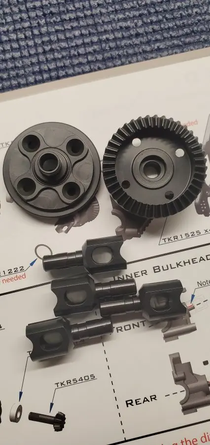

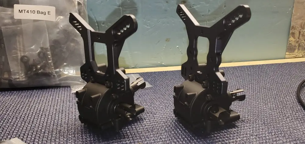

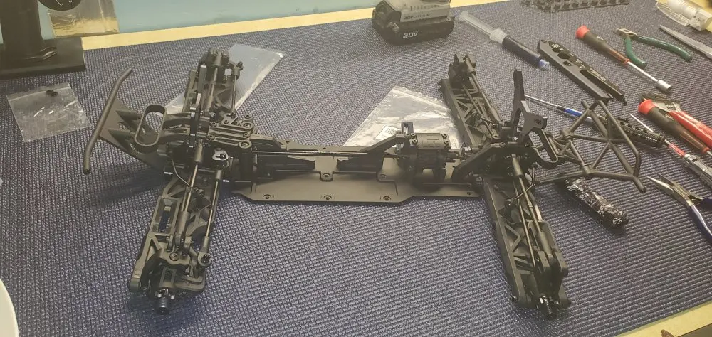

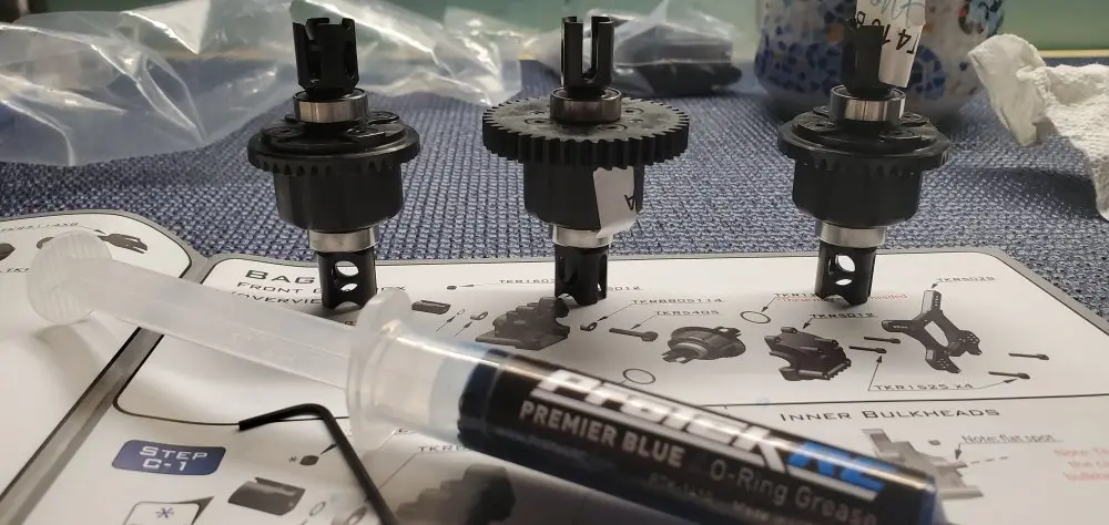

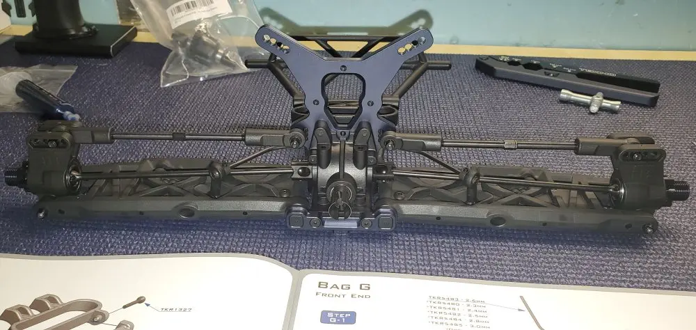

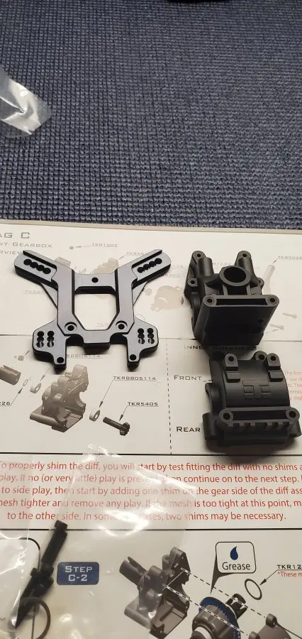

the build thus far has gone VERY smooth. The manual is so clear and concise. I took particular notice to the qualty of the diffs. They're gorgeous! I used lots of premier blue for the o rings, put 50k diff oil in the rear 500k center and 100k in the front. The thing that was slightly irritating was putting together the rear turnbuckle. It gets a little confusing since they screw on to the posts in different directions than how you would think they would. Another thing i though was weird was how the rear A arms slanted inwards. I though I did somthing wrong but I gues that's what all those different pills do.??‍♂️ anyways, here some pics of my progress. Thanks for checking out my build guys! ??
the build thus far has gone VERY smooth. The manual is so clear and concise. I took particular notice to the qualty of the diffs. They're gorgeous! I used lots of premier blue for the o rings, put 50k diff oil in the rear 500k center and 100k in the front. The thing that was slightly irritating was putting together the rear turnbuckle. It gets a little confusing since they screw on to the posts in different directions than how you would think they would. Another thing i though was weird was how the rear A arms slanted inwards. I though I did somthing wrong but I gues that's what all those different pills do.??‍♂️ anyways, here some pics of my progress. Thanks for checking out my build guys! ??View attachment 4727View attachment 4728View attachment 4729View attachment 4730View attachment 4731View attachment 4732

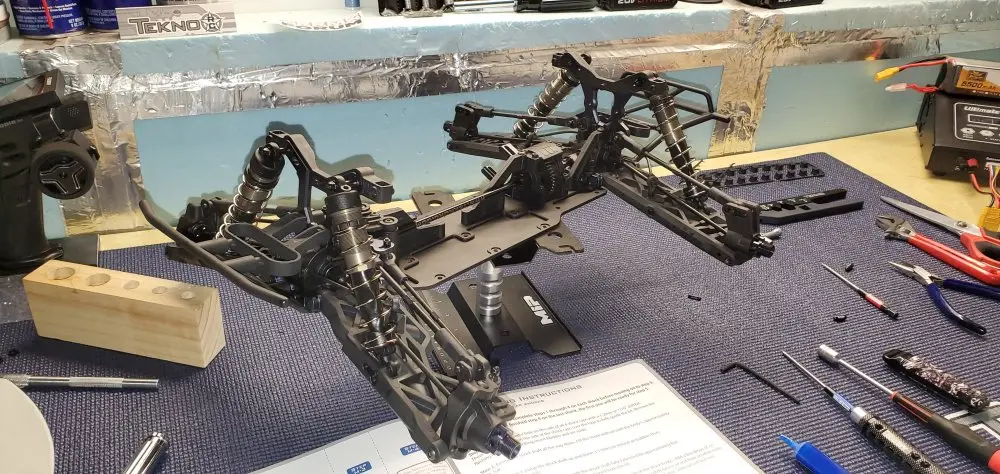

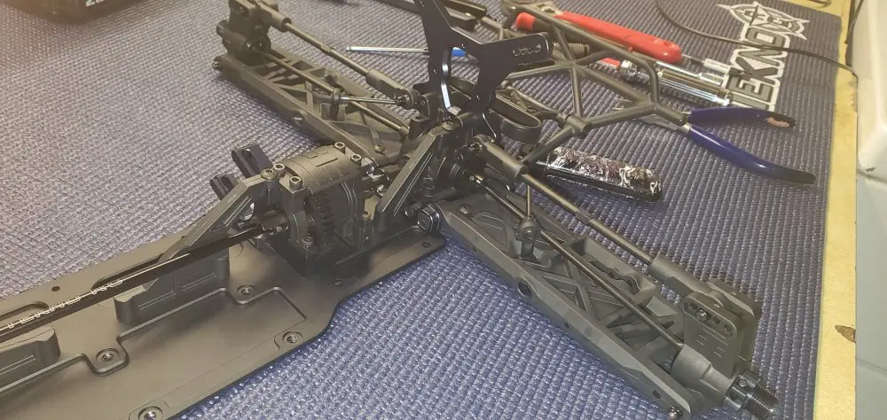

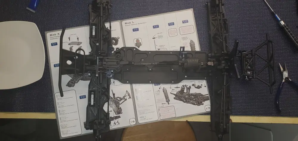

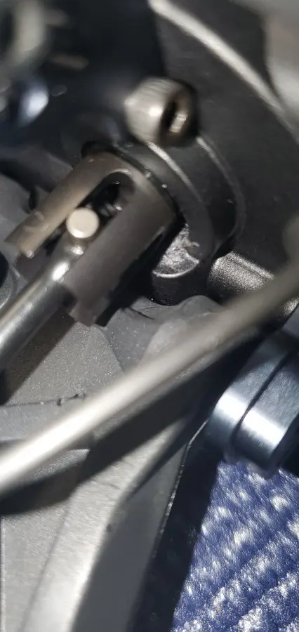

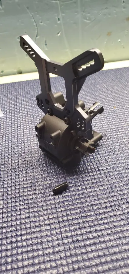

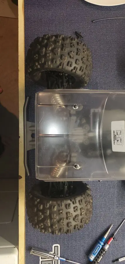

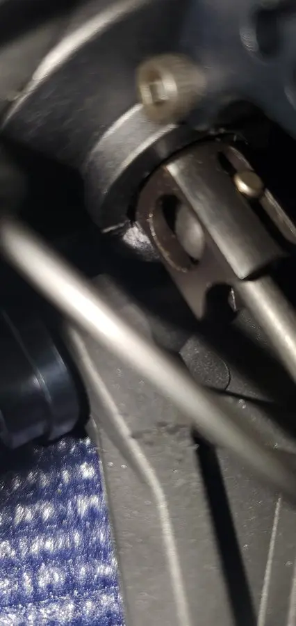

Update: the build has been going awsome. Things got slightly irritating when i got to the steering rack and center diff though. I must admit, I definitely prefer arrma's diff case design over teknos. The center diff is a bit "fiddly" as my fine British friends here on the forums would say ? also, I made a pretty stupid mistake and screwed in the front of the truck to the chassis without the bumper put on. Csn anyone guess what happen ? well, if you said the screws went through the chassis, into the the front diff straight through the diff and into the putdrive, you'd me correct!?? I backed the screws out and had to get rid of a bit of plastic that got pushed up into the outdrive. Everything works fine now, but I AM NOT HAPPY! Also, I should of shimmed the front A arms as they're a bit sloppy. Next time. Heres some pics of where I'm at in the build and the incredibly stupid mistake I made. ??‍♂️

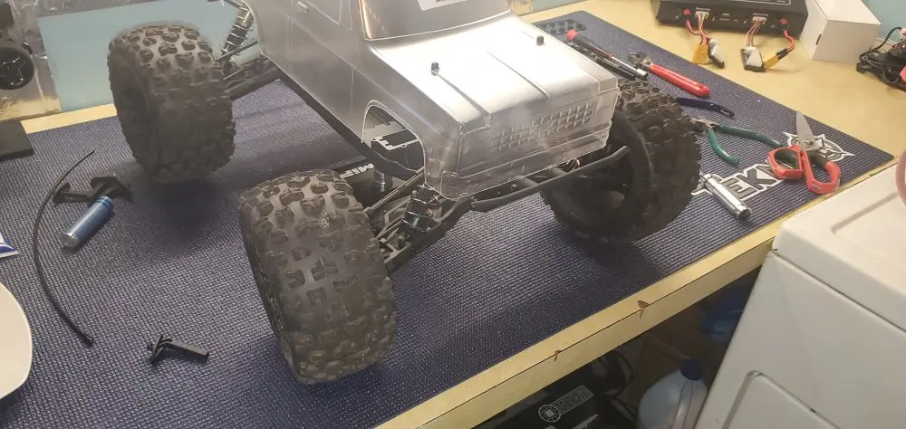

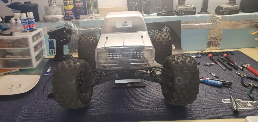

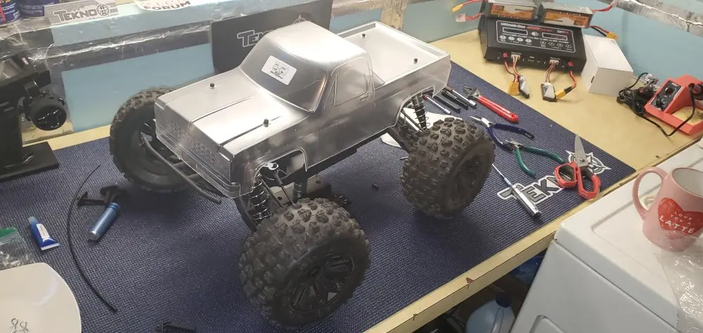

Hey tekno bros. I got the shocks all built up and installed on the mt410? and man oh man are they sublime!? all I have left is the chassis side skirts ,battery tray and servi mount. Body will be painted up this weekend. I throughly enjoyed this build! For my first kit, I'm pretty proud of myself. My fiance doesn't seem that impressed though? I ordered a 4092 hobbystar ,1730kv motor for my kraton so I can pulled the blx sysyem out and put it into twkno. I can't wait to drive this thing! It is literally rc perfection ?

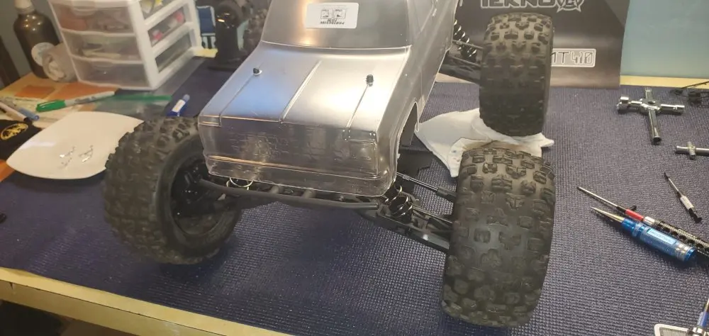

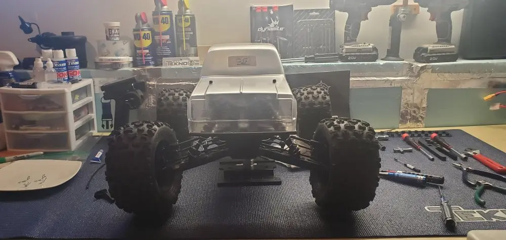

hey, youmgiys got picks of your camber and toe? I feel like mine is a bit much?
As long as you built it to manuals specs, then you don't want to measure and adjust things until it is RTR...meaning all electronics, batteries, wheels and body, ready to run.
There are no electronics in your truck that I can see from the pics. It will sit a lot lower once you add that extra weight.
