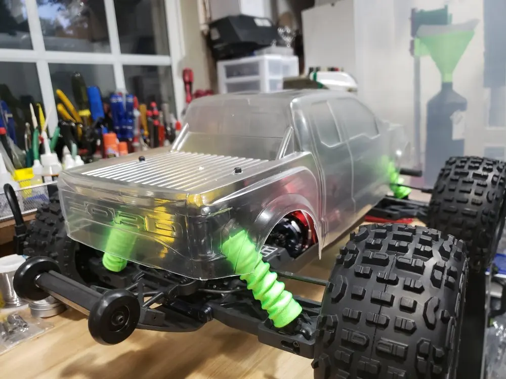

I started my build last night and worked on it a bit more this morning. Stopped at bag 'I' (need to do paint a bathroom ceiling this morning).
I think I have settled on getting the Hobbywing XeRun XR8 1900kv sensored motor combo and leaning towards the Savox SB2290Sg servo.
Are those good for this rig? I'll be mostly running 4S and 6S once in a while, backyard bashing and stunts and some road cruising.
Still haven't figured out what tires to get.

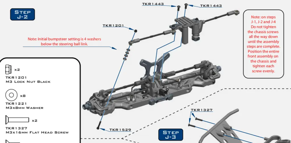

I noticed in the instructions it says to put the lock nut connecting the toe link on top of the steering block but there's clearly a molded space for it underneath.
? I just noticed that a few days after having ran it a few times. Was thinking about changing it but just left it the way the manual says to build it.
X2 After I found that I was wondering how I managed to put that on upside down and had to double check the manual. It calls for it to be that way ?‍♂️

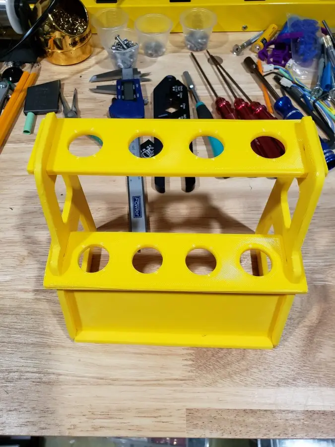

Ready to assemble the shocks, printed up a shock filling stand I found on thingiverse.
It doesn't make sense. Why would they mold a place for the nut to fit perfectly and then tell you put it on the other way? Silliness. lol
That is funny...they got it right on other manuals.

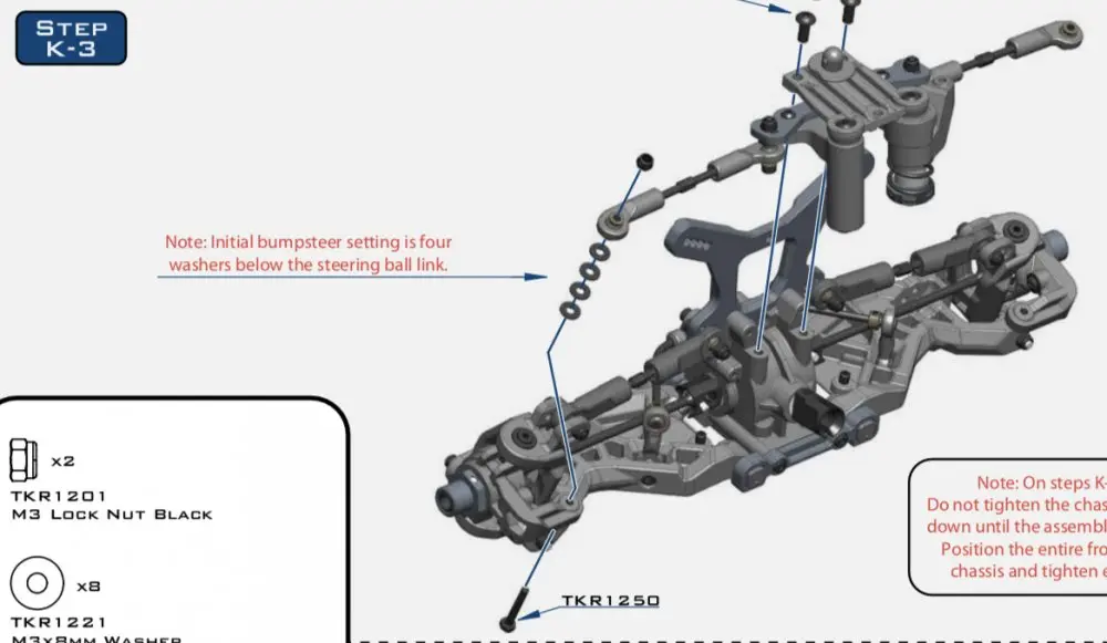

EB48.3
MT410
It doesn't matter really though...infact looking at it now it would definitely be easier to stack the washers on before securing the link end.
EB48.3
MT410

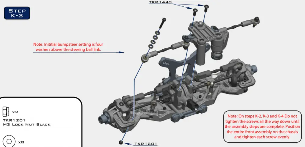

EB48.4 instructions:
3278
I put the screw in from the top on the EB because it helps clear the smaller wheels. The screw head being shorter than the nut and screw tip.
It is unlikely to matter with 3.8 rims.
Looks like they couldn't make up their mind on how to install this screw, LOL.
Thats a good point on the "clearance" aspect for the buggy wheels.

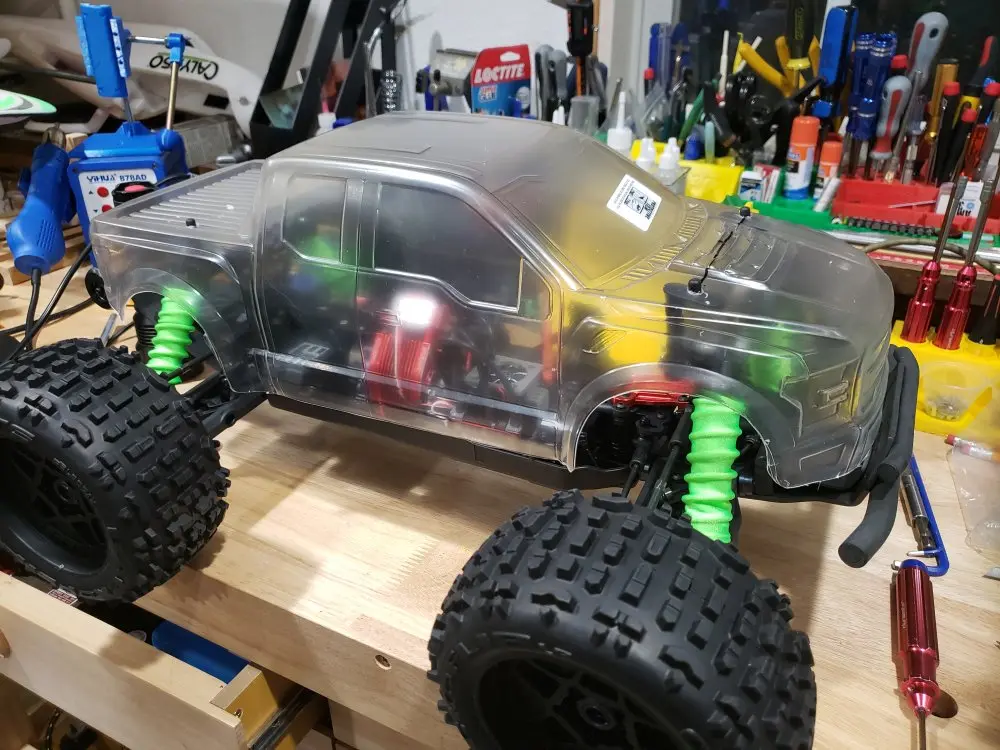

The build is done. Need to do the mesh and align the front wheels. And paint the body which I hope comes out good.
