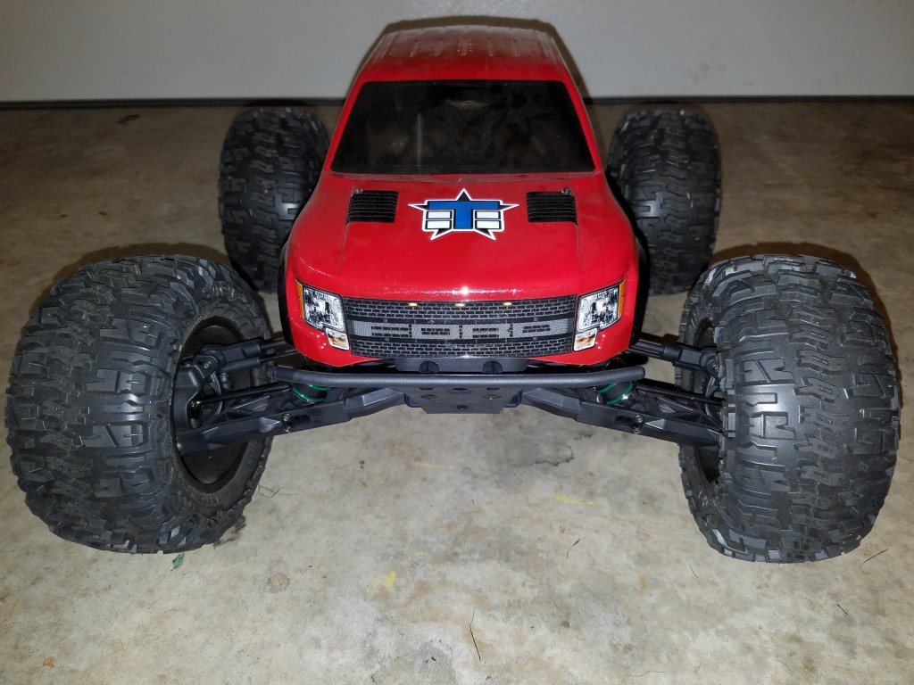

Hiya everyone. Woodie was kind to invite me here so I'll share build details on my current rig, the MT410. I was very active on the URC forums (RIP) where I had multiple build threads, unfortunately they were also posted on photobucket and I angrily closed my account with them before I discovered there was a way around their new free image hosting limitation so I lost all of my past images too. So I'll start over with the MT410 here!

The #1 reason I bought this rig is because it's the only rig of this type (1/8 competition truggy class) I know of that has the suspension travel to bottom out a 7" tire. I've had a couple of other truggies and most of them are engineered to use standard 1/8 truggy size wheels/tires, which is understandable, as they are primarily for competition where you're bound to the kind of tire/wheel you run. For some reason Tekno designed these things to have far more suspension travel than a normal 1/8 competition rig. I wanted something that I could run huge tires and just drive up over curbs if I need to, yet be a 1/8 comp style vehicle. I had a monster truck in the past and while it was great, it was very heavy and used a lot of weird parts and aftermarket support was almost zero.

Let's cut to the chase. The little Tekin T8 Gen2 2000kv Truggy motor was never designed to push these HUGE heavy 7inch wheels/tires. They are like triple the weight of a 1/8 Truggy wheel/tire. This motor gets warm very quickly. So it's time to upgrade.
Tekin T8 g2 2000kv Truggy motor vs Castle 1717 pull from a Traxxas XO-1.
Luckily the Tekno factory motor mount can support this beast. I've done this same upgrade on an old RC8Te (with an aftermarket motor mount needed), and AE Rival (had to modify the factory mount and add additional motor support) and the Rival weighed a lot more and still this motor never got over around 135 degrees on 4s and did around 45mph. Needless to say this is my favorite motor! Never worry about temps again. There are quite a few people who upgrade to the longer can motors like the TP series, those are also great from what I've read. I just wanted to stick with Castle and not have to relocate my ESC (but did have to flip it on its side to fit.)

2. The motor can size being larger means I can't move it close enough to the center to run smaller than around a 21T pinion (I have a 22T), that means 55mph speeds even on 4s, which is a little faster than I need. Shooting for 50. The motor doesn't get hot (you can rest your hand on it!) but the ESC gets warm real quick.
To "fix" the space/gearing problem I just recently grabbed the m2c center brace.
Reasoning behind this, I hoped it was a little more 'slim' and would give me a millimeter or two of extra space to move the motor in closer so that I could fit a smaller pinion. After installing it I know I can go down one tooth to a 21T but I think that will be it, so I'll order one up to try to reduce the temps on the MonsterX. I'm not sure if the factory braces were the same space limitation, I forgot to check it before I took it out (I've got a 22T.) Another possibility is just removing the front center brace completely. Tekno is the only 1/8 brand I've seen that has those center braces, I'm not really sure why they are there, I guess there must be more chassis flex there due to the "lightened" areas where they cut away. I'm thinking alloy top plates would stiffen it up enough so that we wouldn't even need those center braces. If i remove it then i could easily fit around a 19T pinion, which is what I was running with the Tekin 2000kv motor.
