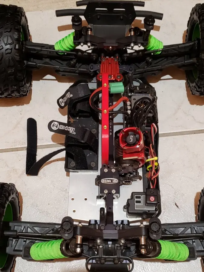

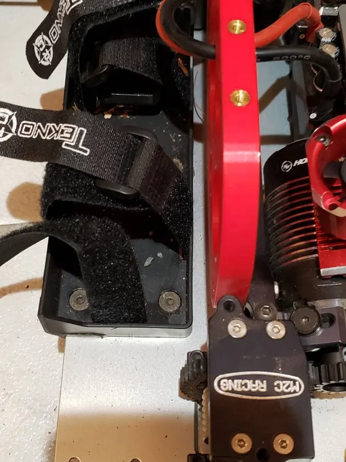

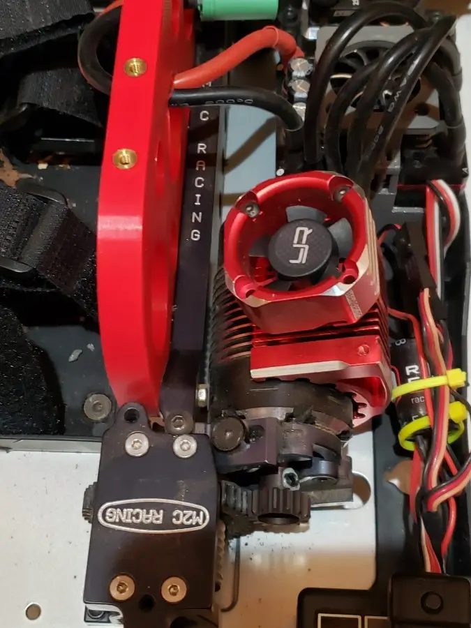

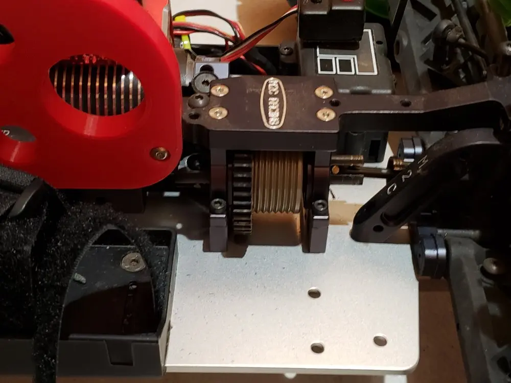

Could you post some photos of how much space you have on the chassis now? I'm curious about space around the driveshafts.
Thanks!

Hey just seen this post can you tell me what is the red brace you have on there and what it's from please?
Ok thank you I appreciate it.
