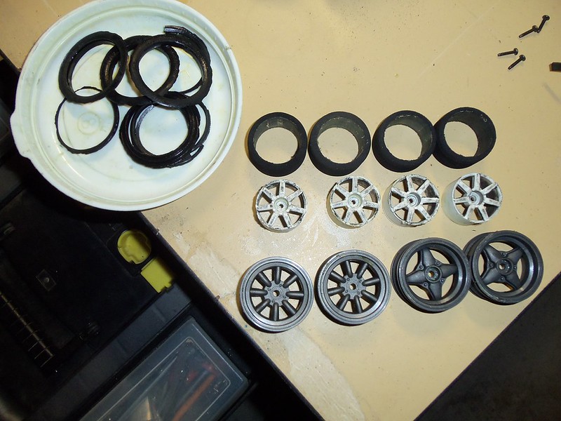

Another thing I like to do is recycle my foam inserts, I'll only run new inserts in the rear to get more rear stability, and then run old inserts up front which helps balance the grip while keeping costs down ;)

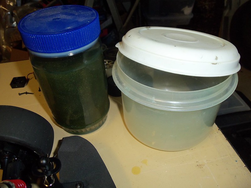

I'll cut the old treads off with a hobby knife to pull the inserts out, then submerge the wheels in a sealed tupperware bowl filled with acetone for a few days, then the beads will peel off effortlessly, wheels can last indefinitely provided you don't strip out the hex or crack a wheel in cold weather.
For long term storage, I'll pour the used acetone in a sealed jar and strain it with a coffee filter, eventually so much glue dissolves into the acetone that it begins to lose it effectiveness after a while, maybe after 10-20 sets of wheels?
