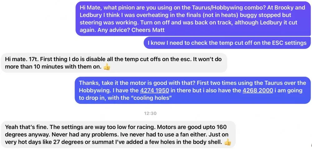

Managed to get some great help from one of the UK team drivers.
See the attached screen shot.
Might help.

Don't think its the ESC, ran several XR8 plus with HW Motors, in a couple of JQs, with same settings, no issues. Only seen this with the HW/Taurus combo so might be the Taurus just runs hotter as per the advice I got.
Might help. View attachment 6589
Appreciate this was a while back.
I'm UK based. I just got a 40mm fan and mount. My HW1900 with 17t was hitting 95c.
Turning off the protection is an answer, but I pay for my gear, and there is a enough out there to suggest the stator and rotor ain't gonna like 100c+ temps for long periods before it either demagnetize or cracks..or both.
With a fan it now doesn't go above 65 ish!
Team drivers probably do whole replacements every year, maybe twice in a year so it might be less of a bother for them.
Not suggesting they have given you the wrong advice at all, it's just not something I'm happy to test. Lol
