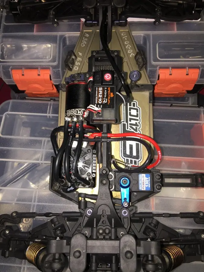

The XR8 SCT will fit, if you relocate the receiver to make the room. I am running the XR8 SCT with tekin pro4 4600kv
I run mine on what is considered a 1/8th track. Its hard packed dirt with lots of loose dirt and rocks on top. I have enough power to clear almost all the same jumps the 1/8 scales can. I can hang with them as long as I don't get bump out of the way. There is no holding your ground when you are running this against the 1/8 buggies and truggies, LOL!

ok so XR8 SCT back on the cards :) might just get it , noticed your tekin is 52.3mm long the HW 4300kv is 62mm , that might be a bit tight.

The XR8 Plus and XR8 SCT speed controls will both fit, but you will have to find alternate place to mount the receiver. I run an ESC in my mini truggy that is bigger than both the XR8 models. I had leftover NIB gear for my 1/8 scale buggy and rock racer. Call me crazy, but it works.

I run a 3652 (4300kv) with an XR8 SCT and fit everything with the normal receiver placement. Had to dremel 1mm plastic off the front brace to make it work, but pretty simple. I think a higher kv might be better but this works fine with a bigger pinion (19T).
