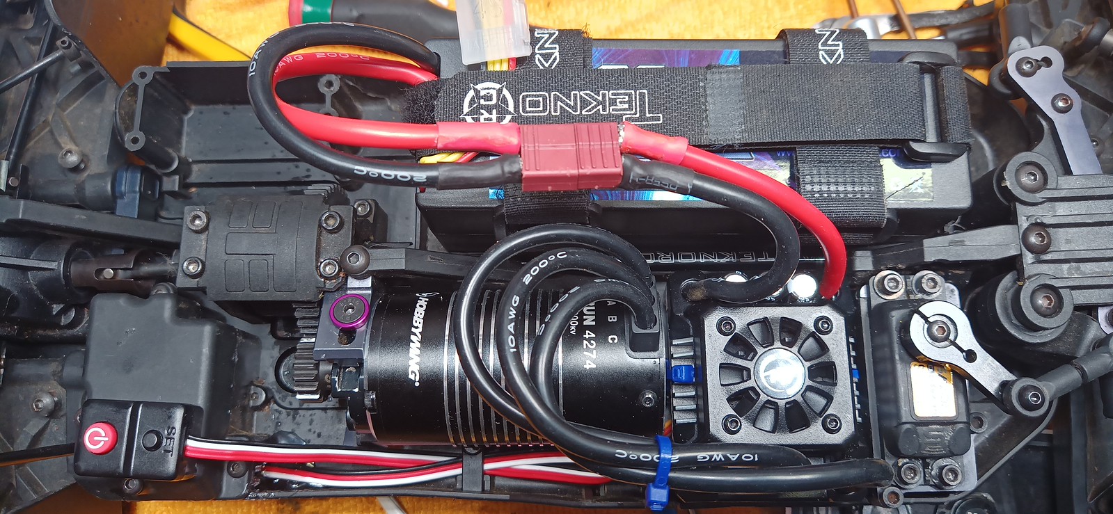

you can fit a 4274 can in the SCT410 chassis if you wanted, here is the 4274 in the MT410 which is the same chassis as the SCT410:
Hi new to registering here on the forums, but have been a silent follower for some time. Don't want to derail the topic, but wouldn't you risk having the 4274 motor jamming into your esc during chassis flex? I ask, because I want to run a 4274 motor in my sct410.3 converted to DB as well.

...wouldn't you risk having the 4274 motor jamming into your esc during chassis flex? I ask, because I want to run a 4274 motor in my sct410.3 converted to DB as well.
The amount of space in this area to mount the 4274 can is no different between the ET48 and SCT410, the extra chassis length is extended behind the center diff. You would only risk chassis flex if you remove the center chassis braces... I have never had any issue with damaging any of my electronics in the ET48 that I used to race, the only chassis brace I removed was the rear brace to get more rear traction.

Now I just need to find out if I can mount that 1/8 motor to the motor mount supplied with the SCT 410.3 kit.
The parts are the same between the ET48 and SCT410 for the motor mount, and electronics, you can install up to a 4274 can in the SCT410 if you wanted, that is the picture I posted above, but for the MT410 which is also the same space as the the SCT410. They all share the same center drive line parts.
