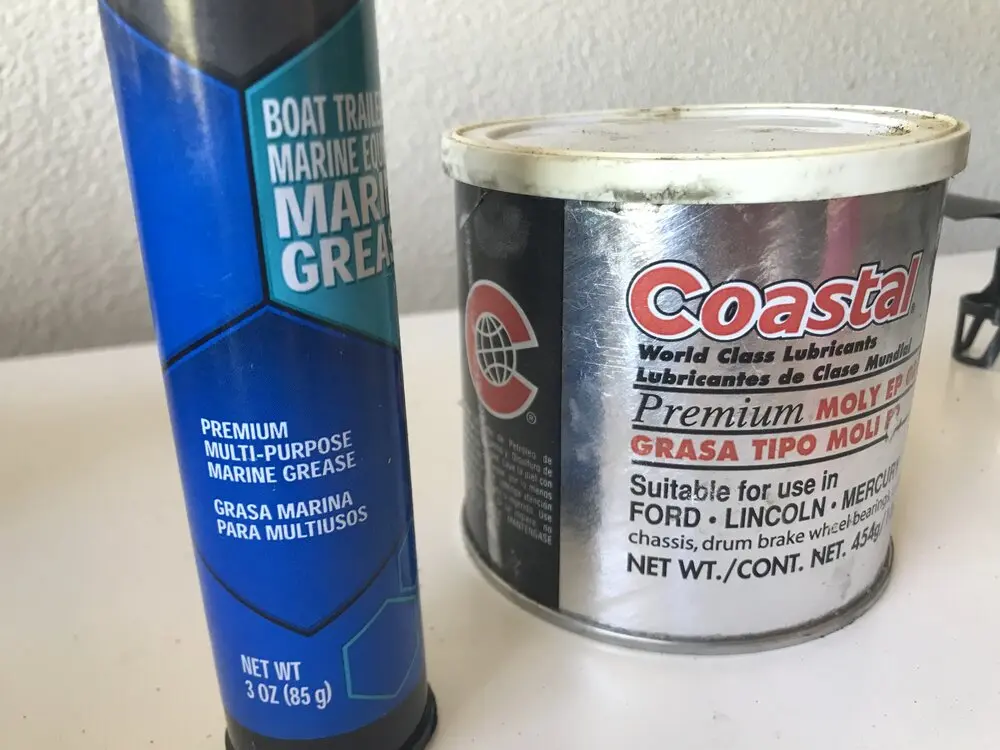

Also, does it matter what type of grease I use? I have something I got at the auto parts store and marine grease. And of course the stuff that comes in the kit

Put the 10k in the center if you don't have enough of the 7k left, try and use 7k in the front if you can.
Diffs can be built and tested dry, don't install them and run them dry, but do the screws up dry and then you will feel any binding or if they are too loose, once you shim them and are happy with the feel dry fill them.
Marine grease is usually pretty good quality and should be fine also. The motor grease may be a tiny bit stickier and leave a thin coating on the gears even when the majority of the grease has flung off, where the marine grease may not hold on over time.
