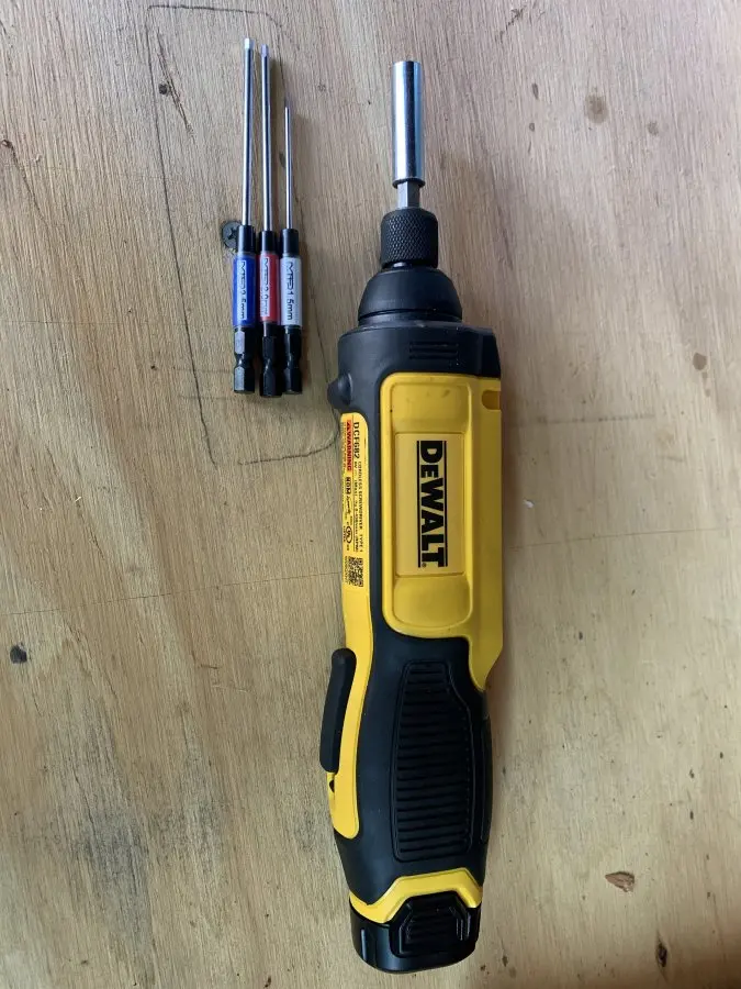

I'll start, best buy this year: electric gyroscopic screwdriver with MIP tips.
This thing is awesome! Cuts your wrenching time by half. It is that good!

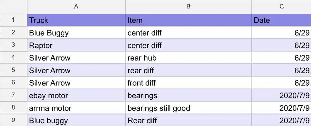

Second tip, start a Maintenance Log.
Allows you to have a way more factual approach to your maintenance. Reduce the useless work. Track maintenance on a growing inventory of trucks and parts.
