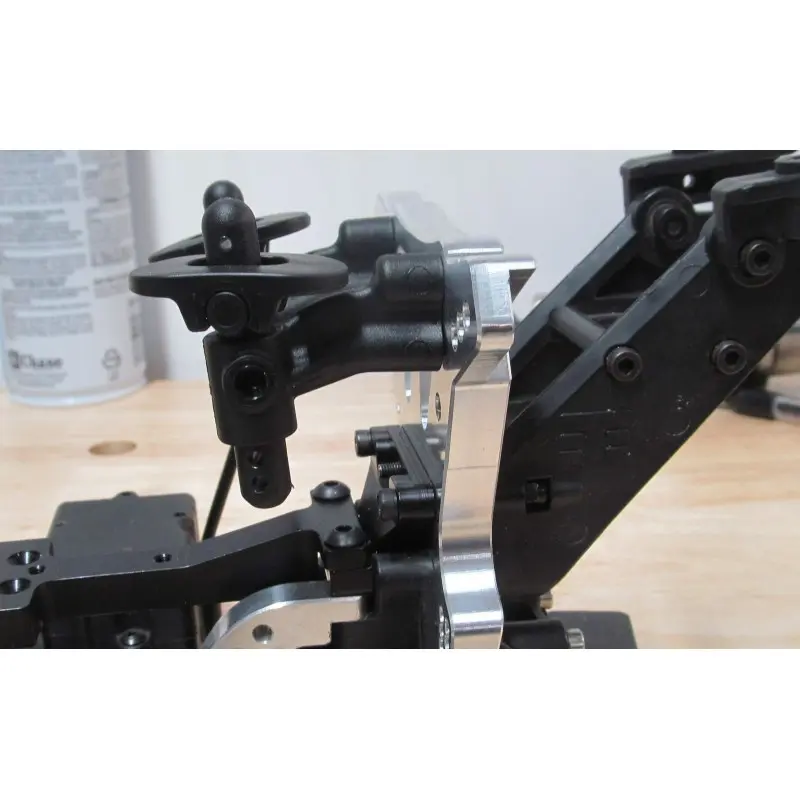

I just bought a MT410. I am ordering a M2C Game Changer wide body and their new shock towers. My question is, since I am getting the new shock towers and the chassis and they both are solid, do I need to buy any extra braces?
M2C6755 Rear Center brace
M2C6973 Rear Horizontal Brace
Any thing else I need to consider since I'll be flying this car and not worrying about breaking it, which my Traxxas does.

My recommendation for an efficient and very driveable basher: use your m2c chassis with the stock plastic braces. This is how IMHO, you will make the best of the m2c strength and at the same time safeguard some of that Tekno racing DNA. Exception, use the m2c rear tower brace v3 since I think it does an awesome job at strengthening the rear end.

The m2c shock towers is made to be used with the arrma body posts and mounts, they are mounted on the tower rather than in the plastic braces that is stock!
