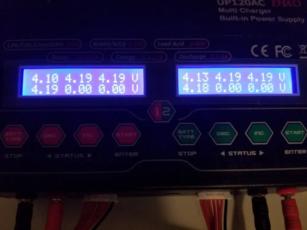

I am seeing the same thing on 2 of my 4s batteries. This is after I did a balance charge on them. Wondering if I should be worried about failure and or fire.

Were they actually done charging or did they time out because of a setting on your charger? Those numbers look like they still have some balancing to be done. If your charger is working correctly they should all end up with the same voltage no matter how far out they are from each other. The thing is is they are really far out it will just take a long time to balance. A lot of chargers have timers so they don't over heat a battery too much. You may just need to run the battery for another charging cycle to get them all balanced up.

You know thats a good question. I just ran one of the batteries, but will throw the other one on again and see what happens.
edit..pretty sure my charger had timed out. two are now at 4.20 and the other two are making thier way up.

If you find your batteries are going out of balance and you don't balance them fully then they will become even further out of balance if used like that. I would suggest you get them all balanced correctly before they get too far out.
Thanks, doing so now. I had always assumed that the charger had gotten the cells to the best balance it could do. The first cell always seem to be much lower than the rest, and as it drops while out bashing around, sometimes I only get half power (right before hitting LVC). Assuming this is that first cell dipping below that cut off and the esc shutting the motor off, then back on as the cell reads a bit higher? This only occurs on one of my batteries, and never when it is fully charged, or even half charged it only happens at the end. My other battery will ride full force up until it cuts off from LVC.

These are HobbyStar batteries, not super cheap but much cheaper than the top dollar ones I've seen. I appreciate all the information here, all this battery stuff is somewhat new to me. The charger stopped and called the battery Finished. The 1st cell charged up to 4.19 I waited 10 minutes and started it again. After a few minutes the charger called it Finished again, the 1st cell was still 4.19 Looks like that's all it will take, still better than where it was and where it was going.
edit...my second battery ended up balancing perfectly!

Time can depend on the charger you are using, but also if the voltage to the cells are off then it will take some time to get them balanced. There is a little back and forth with the voltage when the cells are balancing. It sounds like you need to just leave the battery on until its finished its. Let the charger do its job and run the full cycle.
Ok I'll try that next. Thanks.
