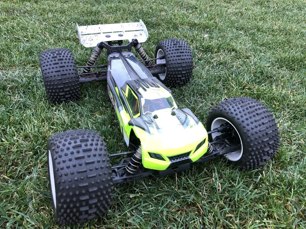

New to the et48 and trying to get a slightly larger steel spur gear. Can anyone tell me that highest tooth count that will fit?
I am running pretty large tires and I am not able to gear down as much as I’d like. I figure making the spur a little bigger will help. The motor mount doesn’t slide in far enough to let me run 12 or 13 tooth pinions so if the spur is larger it should help with that issue.
45T is about the largest that will fit, but with extreme chassis flex the spur may hit the chassis. In order to go larger, you would have to space up the motor mount/cd mount/top plate/brace or cut a slot out in the chassis for the spur.
