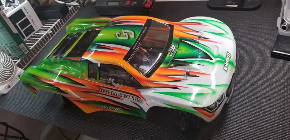

My 3rd racing rc...have a Tekno ET45.3 and a Tekno EB48.3 both with HW XR8 Plus and HW 4274 2250kv motor.
Just added a Tekno SCT410.3 to the stable and plan to install HW XR8 SCT Pro ESC and HW 3652SD G2 5100kv motor. Yes, I am partial to HW. Not sure which servo I will use yet. Have 3 to pick from SAVOX SB2273SG-CE - Ryan Cavalieri Edition, Pro Amp BLS358, or KO PROPO RSX2 Power. Any recommendations? I noticed the first 2 mount higher than some other servos so not sure if I need to add a spacer or another servo brace to raise the mounting points.

Oh and I forgot to mention... the paint job on your rig is AWESOME !!
I agree with GD, if the KO is proven it might be better for your piece of mind.... and it’s FAST!. I admit to some bias as I run Savox in 4 rigs and have never been let down. As far as mounting goes, I’m not sure.... based on specs the the 2273 is only .7mm or .027” taller overall than the KO. Could be a difference from bottom to mounting flange???
