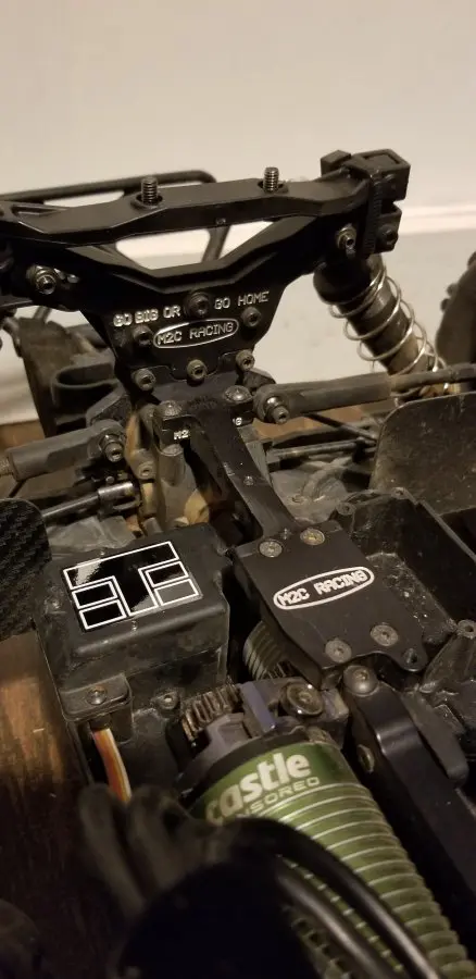

I feel your pain. I'm running this. Proline thumb lock slash mounts. They line rt up and give a lot more. So far it's lasting twice as long. ?
I like those proline posts, I had them with the Apocalypse body. But now with my new body I'm going to use the stock posts. Hopefully they last a bit longer than mentioned here.
