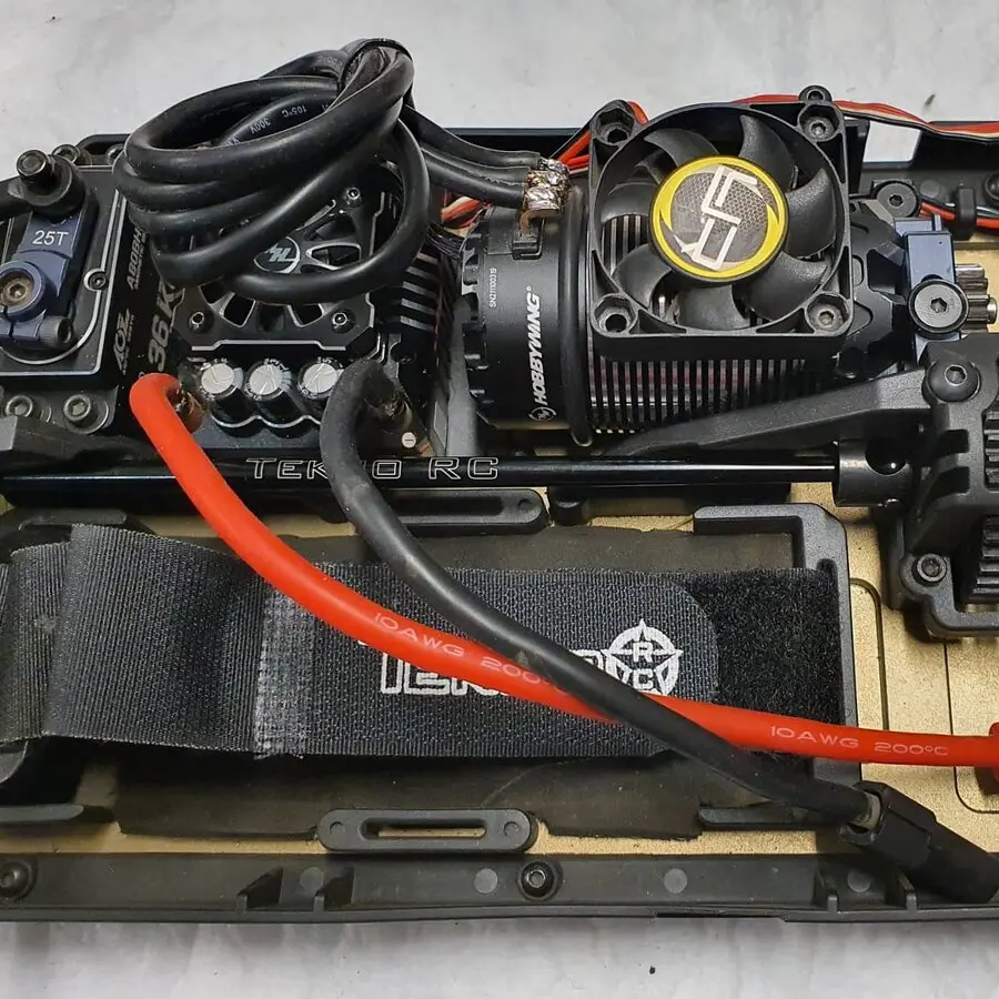

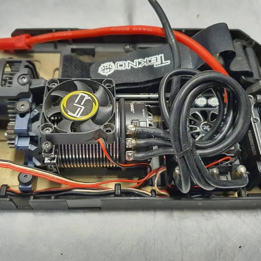

Yeah I don't know if you noticed the extra hole in the plastic on the servo/esc tray, but when I mounted it straight the sensor cable was too close to the box mounting hole and it was touching. The easiest solution was to skew it to get the extra clearance I needed. I also mounted the esc on an angle to get as much of it on the chassis as possible, I wanted to have as little overhang as possible.

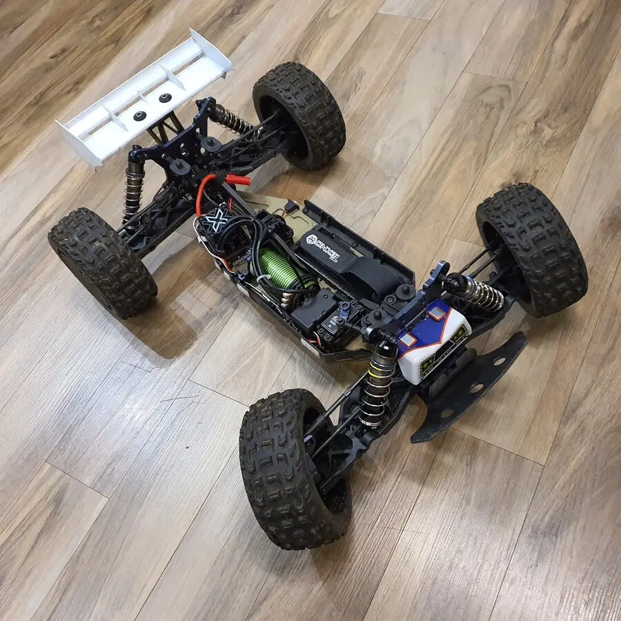

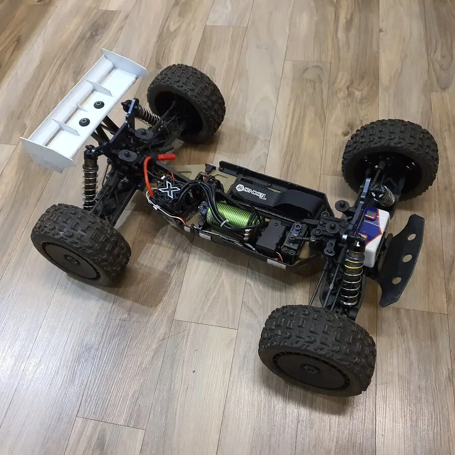

Went to the track last weekend and the truck ran well, I've removed the Castle combo and put a hobbywing system in now and I'm going to lighten the shock oil, I think I might even need lighter springs and sway bars. The diffs need to go lighter too. It's winter here and the track is very bumpy and loose, we have trouble with extra bounce and the car was clearly bouncing around. It was superb of the jumps and it was a crowd favourite that's for sure.

It is straightened up for you now, though I can't get the esc straight due to the chassis. I've got my diffs and shocks set for bash and the initial run was good. Did a quick speed test on 4s I got 64km/h 40mph on 6s I got 92km/h 57mph out the front of my house.
I love the way this truck jumps and it likes to land on it's wheels somehow?

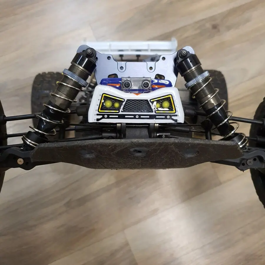

I fitted this old bumper I had lying around after the run, but I'm hoping to get out for a proper session tomorrow.
I fitted a 22t pinion so I can see how quick that will be tomorrow. I want to avoid 6s as much as I can, hopefully this will get me the speed I want on 4s.
