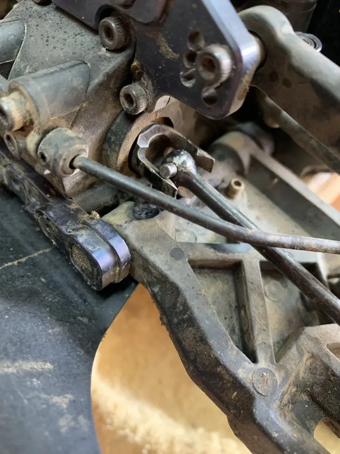

  • front left outdrive broke and that is probably it!

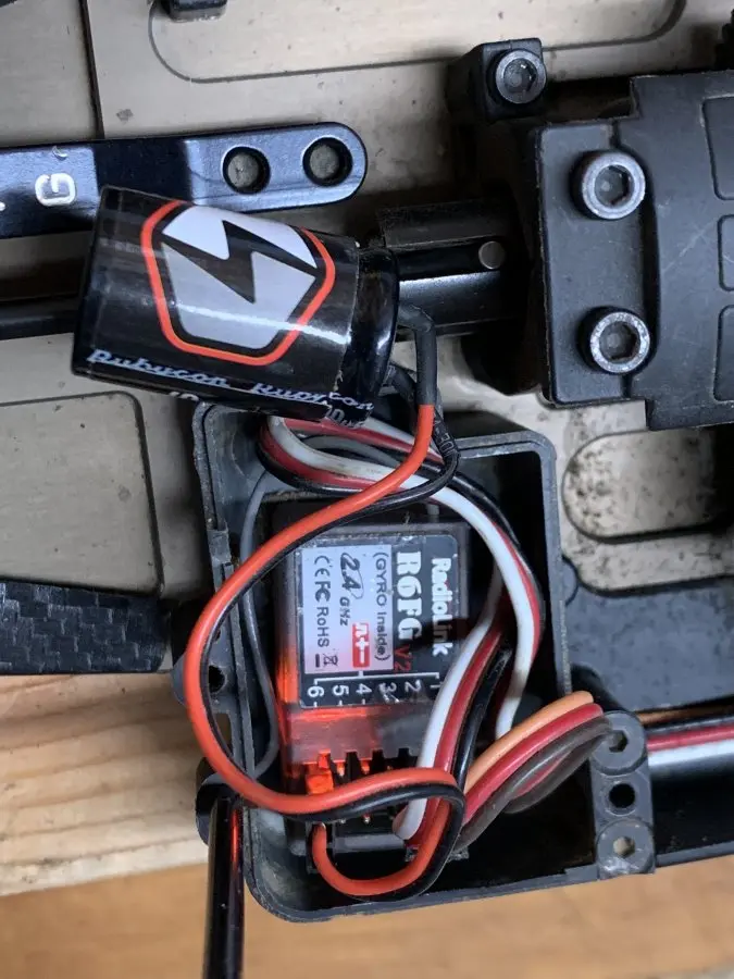

I immediately took it home and checked contacts at the Rx. Nothing obvious was discovered.

Just checked the fail safe setup and it is all zeros. No throttle or steer.
Also, switching off the Tx doesn't reproduce the reaction observed yesterday. Which makes me think it must have been some sort of interference.

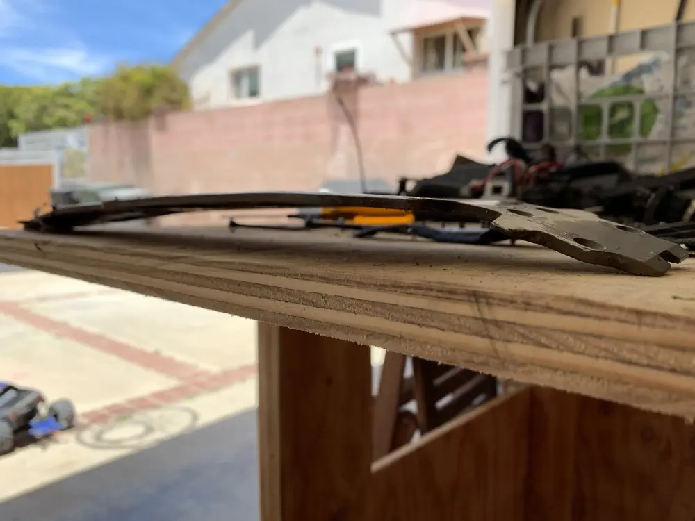

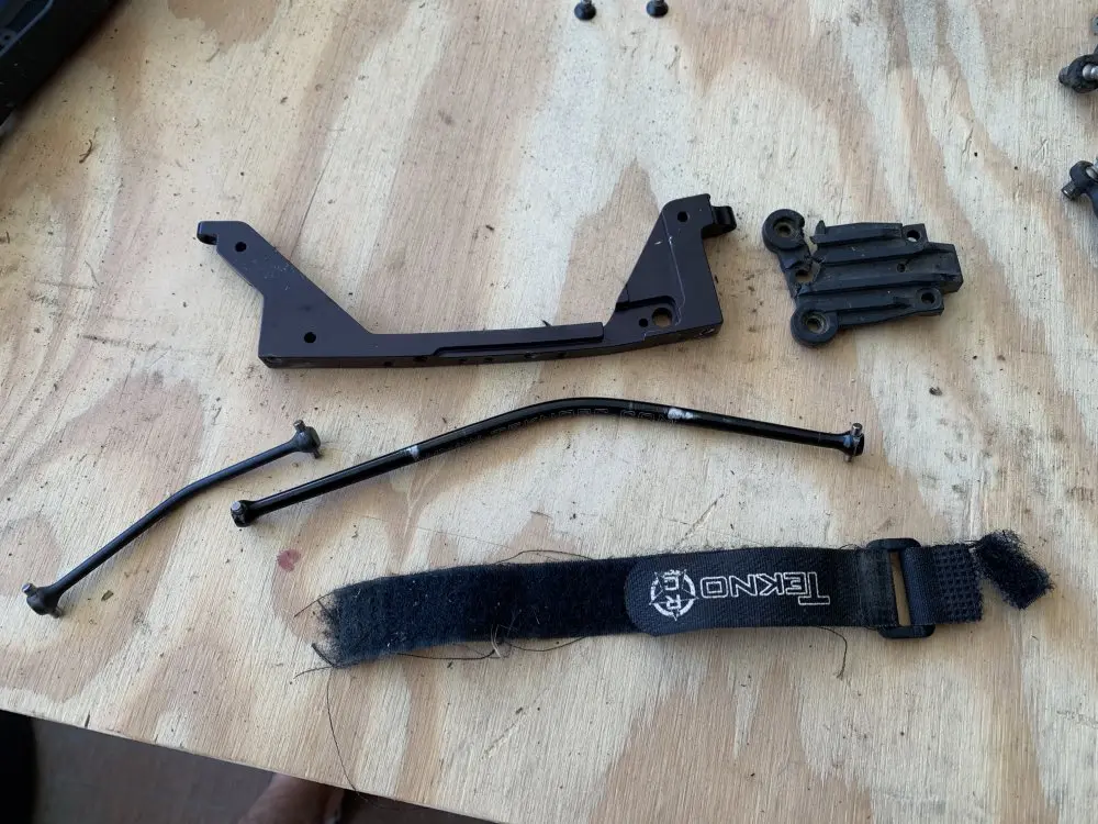

Did a full reset of controller, checked fail safe... run the truggy again today and crashed again. This time the crash left me with almost everything bent (chassis, M2C brace, drive shafts...).
Lesson learned. Fixing the rig AND changing the radio.
