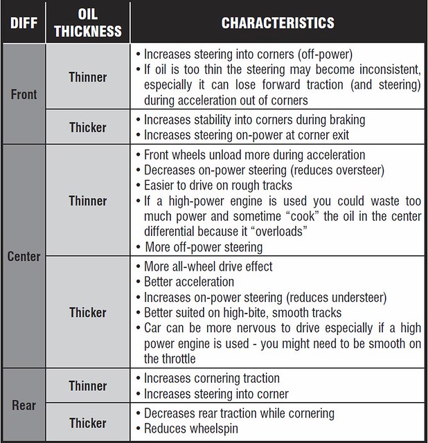

60m = 60 million? Yeah that's way too high for the rear, but assuming you meant 60K even that is high IMO, if you have some 20K that is a much better starting point. You'll know immediately if you need to drop down to 10K on the rear if the back end is too squirrely on power.
More info here from the Hudy Tuning Guide that may help you with your diff tuning:
