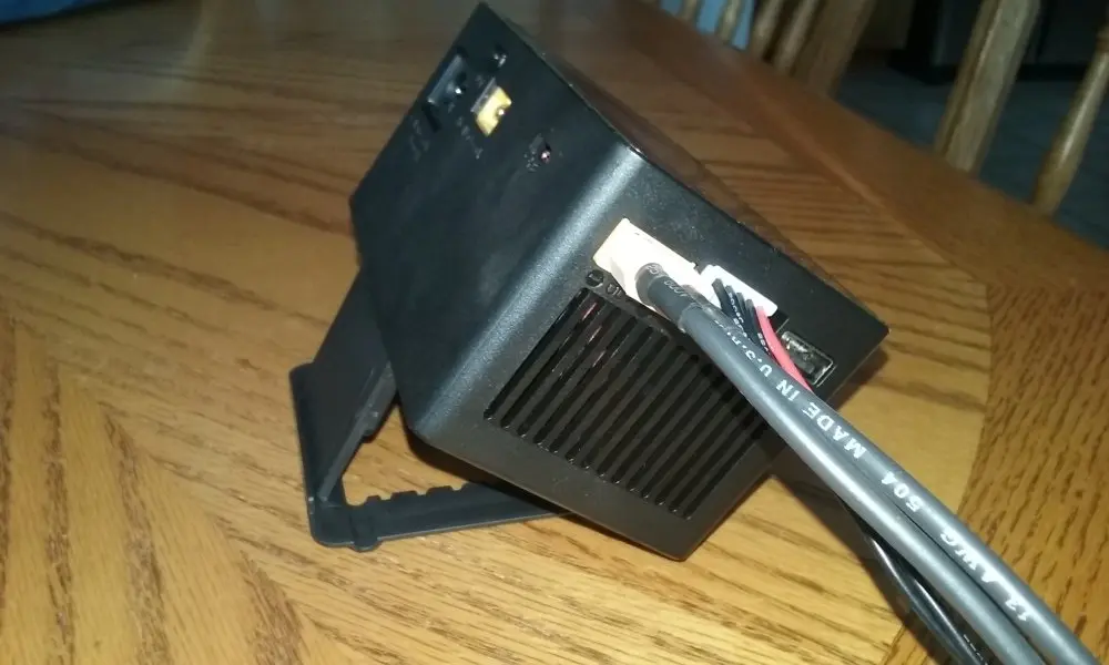

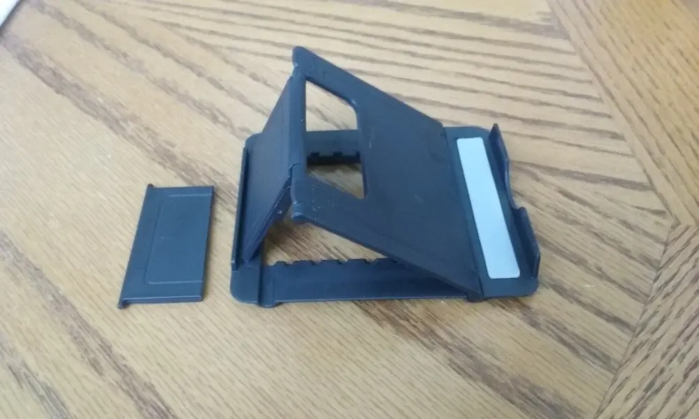

The only thing that would make it better would be the ability to angle the unit with some built in feet, or something. I used a cheap phone stand; cut extra material off stand to match angle of other charger's face, and secured it to the case with double sided tape.
