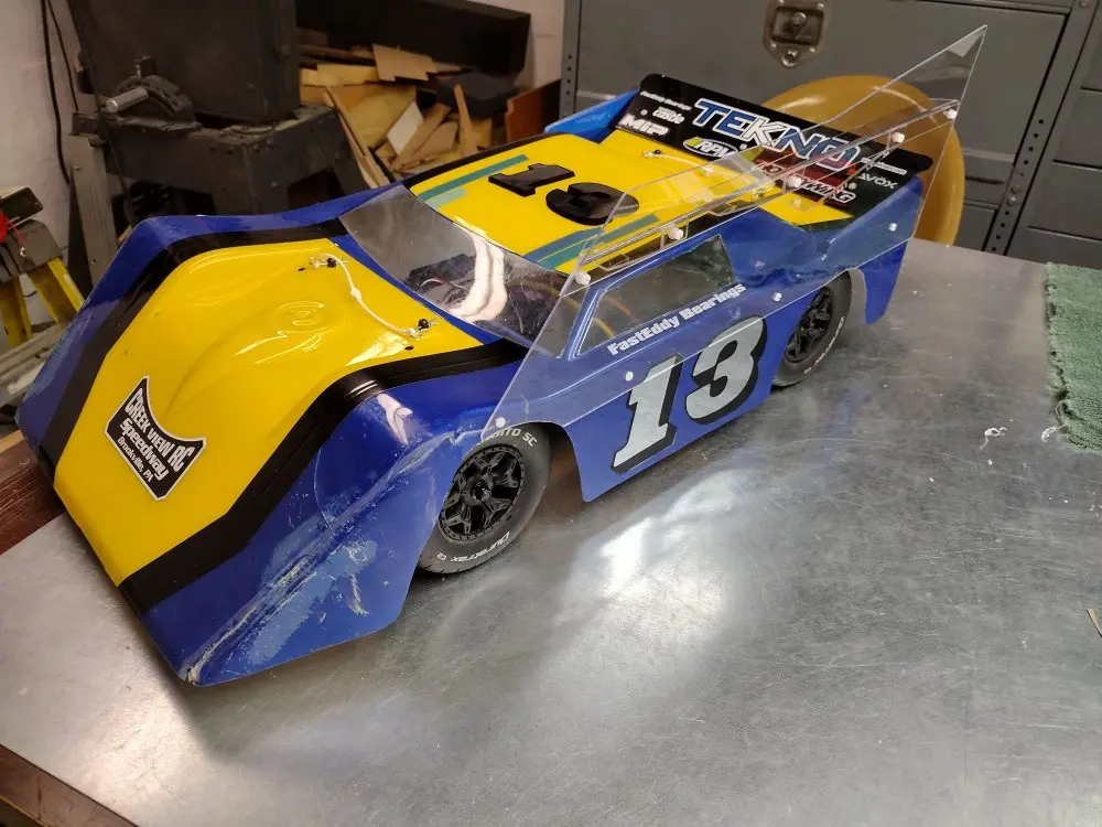

Hi guys, maybe someone can shed some light on what I have going on. First off I am Completely New To brushless stuff. I Just got back into RC after a 23 year Break. I built this SCT410sl To race at my local dirt oval, they have a 4wd latemodel class. I am running 8000mah batteries. The first battery I ran I checked about a couple minutes into the run and I found that my ESC fan had quit working. I ordered another one and a few days later I gave it a try. This time I made it to the second battery before completely shutting down. No ESC fan and the ESC shut down. I'm guessing a temp sensor shut off the ESC when the fan quit.
The motor/ESC were recommended by the hobby shop owner but I'm sceptical if the size of the ESC is adequate. Let me know what you think, Thanks Jason
