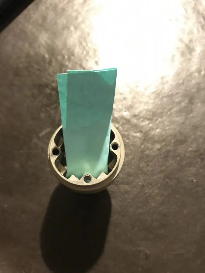

I believe I have figured out what the problem was and it seems that the screws holding the diff together had come loose cause there was some diff oil in the threads and I think it affected the thread lock from working...One thing I have noticed is that the aluminum cups have screw holes that go completely through to the inside of the diff and the stock ones have closed of screw holes so that diff oil can not mix with the thread lock.
Let me know if anyone has any experiences with thread lock not working properly when in contact with diff oil?

Looks like a design flaw of the M2C cups?
On the stock plastic cups the oil can only touch the threads if the diff is overfilled.
Try filling the diff to a slightly lower level and clean the screws using brake cleaner or isopropyl alcohol and a tissue.

I use the M2C center diff case and have never had this issue. I would clean out the screw holes really well, clean the screws, use 243 blue loctite which has a better oil tolerance, and let it sit up right for 24 hours. On a side note, the new Tekno steel center diff case does not expose the screws to oil.

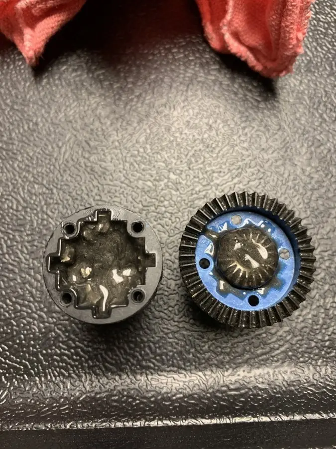

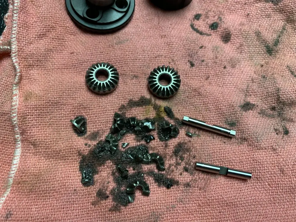

By the way I just grenaded my rear diff on 6S, after 4 runs. Upgrading diff cases should help with 6S?
3164
3165
WAS old diff case destroyed as well? I can see the destroyed spider gears, but it's hard to see damage to the case in the pics.
Yes the inside of the diff cup was all chewed up from the gear explosion. Some spider gear teeth where actually stuck in the cup walls. The cup in the pictures is the stock plastic one that came with the kit.
