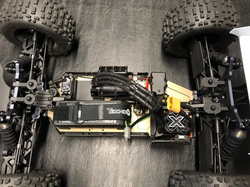

Yeah for sure -- I'm planning on making a full build thread once I do a couple more things to it, but here it is as of now.
Castle MMX8s
Rocket RC 4092 1650kV Motor
Turnigy Graphene 5000mAh 75C 6s LiPo
MKS HBL550 Servo
Dboots 6s Backflip tires
18/44 Gearing
LFR Strife Body for the NT48.3
YR dual aluminum fan/heatsink combo
It's geared for 75mph. I run it really hard. I like to let the motor cool down between runs since it still gets pretty hot even with the dual fans. I'm considering a TPpower 4070. The ESC runs cool, max temp according to the data logs was 160F after the third back to back battery, ambient was 80F and I'm running the stock fan, avg temp was 130F. I have a 40mm HV, 28mm tall aluminum case fan I'm going to install and keep running all the time to keep the ESC really cool. I also made some bumpers myself and will install a TBR wheelie bar. M2C said they're going to make upgrades so I'll definitely try to grab some chassis braces once they're available.
waiting for the motor to cool down is what I had been doing for about a year now, but no more :) love that 1520 motor for bashing ! ! ! don't even think about getting a 1515 can for bashing, it'll over heat in 15 min or less.
