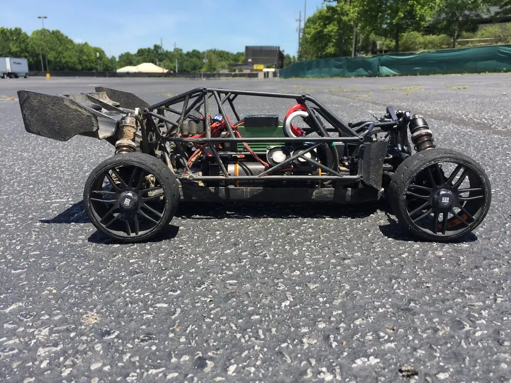

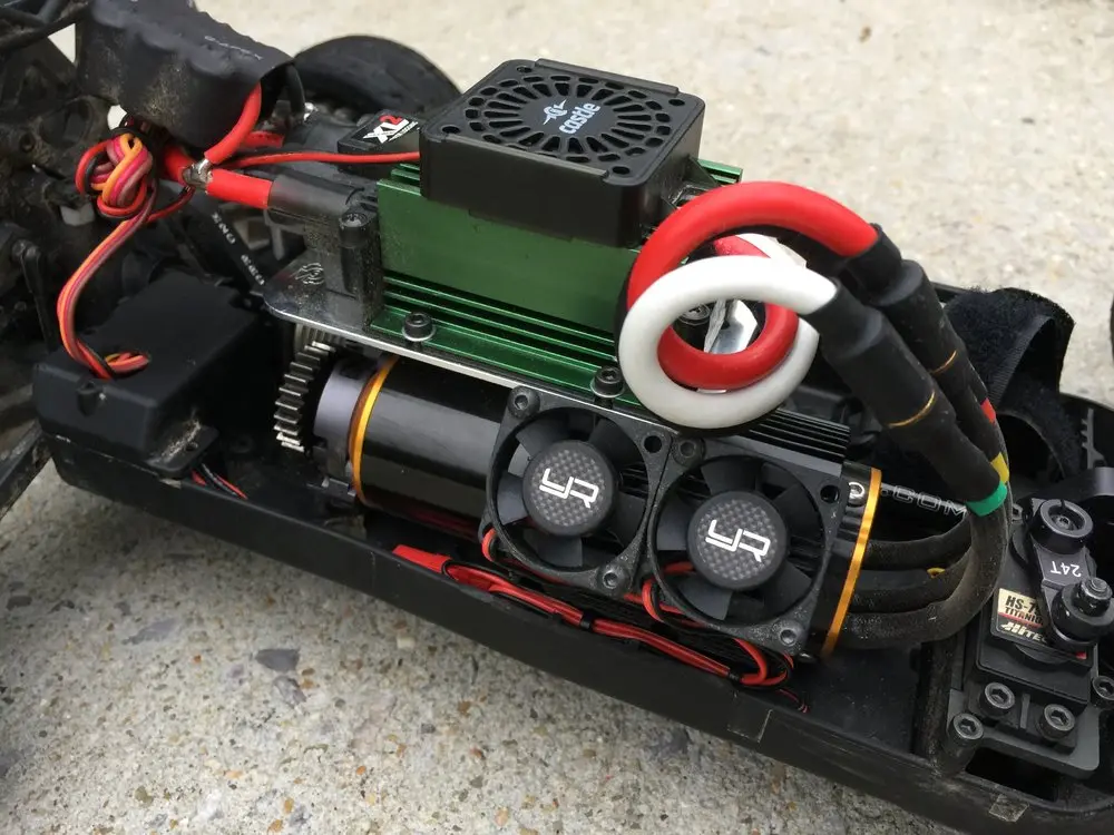

The steel spur isn’t necessary for what you’re doing. If you want a smaller spur you can use the Fly Ratio 32T which is a direct fit on the Tekno diff case, that will allow up to a 37T pinion. I use the stiffest low frequency springs they offer which is TKR8767 and TKR8776.
This is my EB48.3 buggy. I’ve gone 118mph with a smaller motor on 6S, haven’t made any big motor 8S passes.

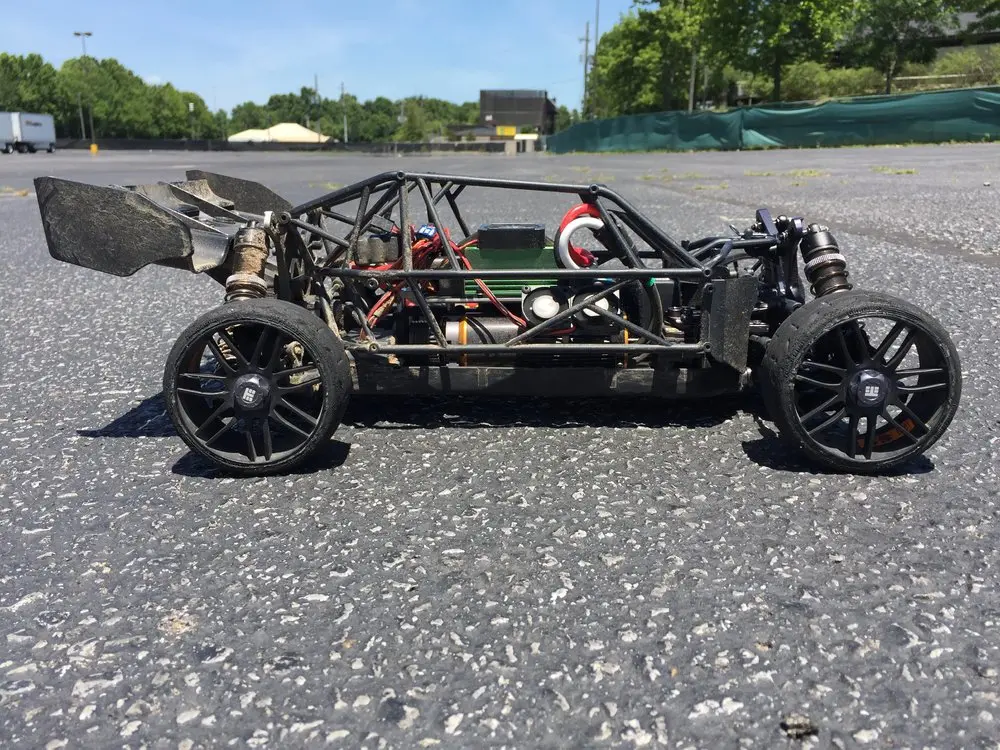

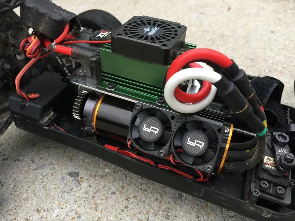

What cage is that
