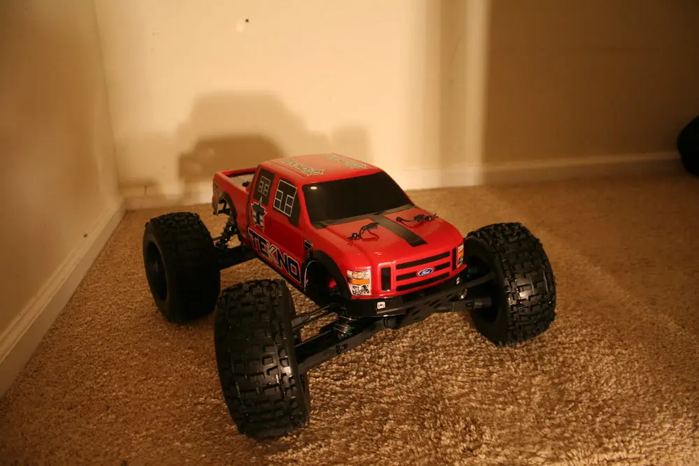

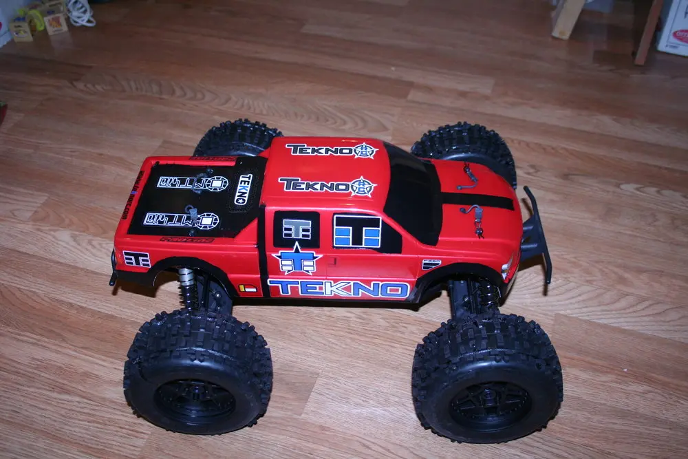

Hi All,
My First Tekno Build! This was fun. Have some questions about suspension/wheels and tires.
Took truck out for the first time, drives great, but rolls over easily on either side (rolls more easily on battery side). Any suggestions on how to stop rollovers?
1) Shocks are in stock position, adjusters cranked all the way down to stiffen springs.
2) Running Arrma outcast Dboots Backflip Tires & wheels.
Don't Know what the Ride hight should be either
Not sure if wheels are 0 degree offset or not. Any help would be appreciated.
THANKS!
Truck looks great. It already has a high center of gravity, so it is prone to rolling over. I suggest you back off on the springs to lower the CG and give the vehicle some suspension movement. Aside from that, practice turning under power to get the truck to rotate without "hooking" and rolling over.
This! Lower ride hieght and get to know the truck. It's more of a box than anything, carefully applied throttle will slide rather than flip. Its actually one of the harder trucks to traction roll that I have.

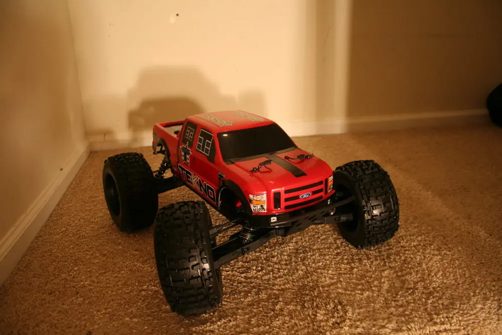

Hi All,
THANKS!
View attachment 2065View attachment 2064
Backflips are zero offset have tons of lateral grip. They are also quite tall.
You could stiffen the suspension with thicker oil and harder springs while limiting the ride height since the spring collars won't need to be as much down.
