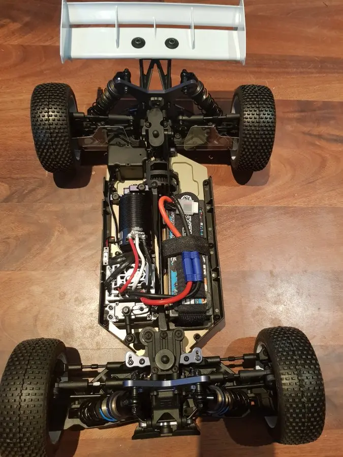

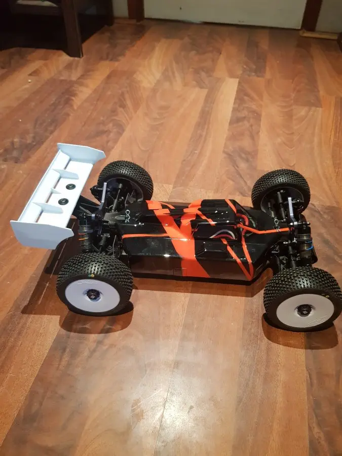

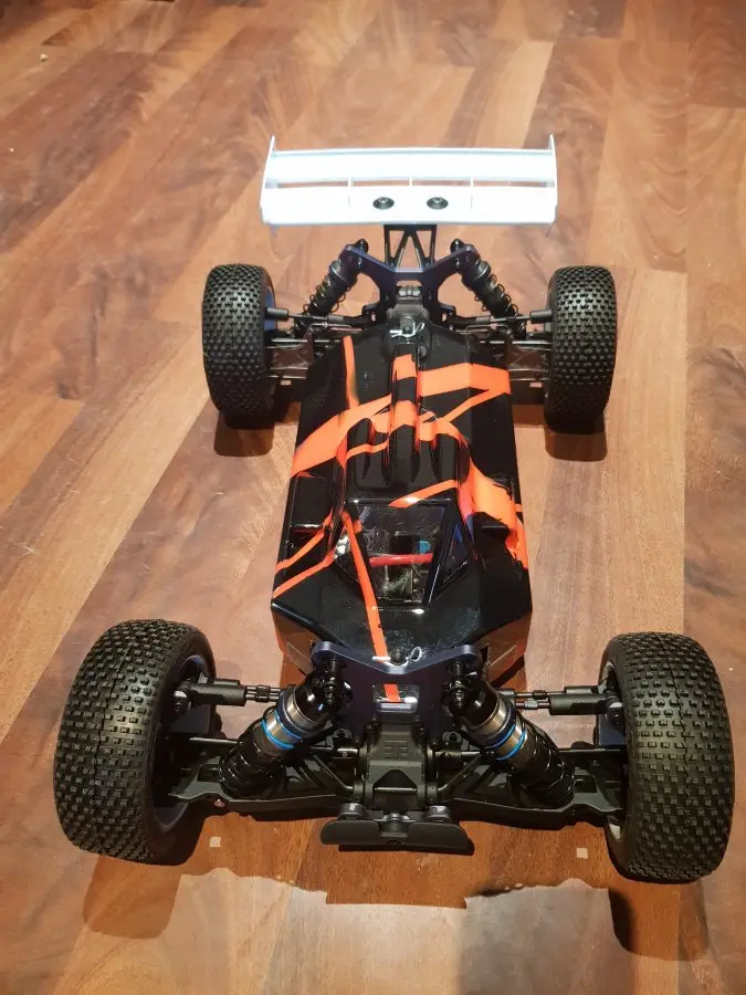

48 2.0 First ever kit completed: EB48 2.0 :D

Got it to get into racing. Competed today for the first time and had an absolute blast! Great day out :)
I'd suggest watching all the YouTube vids you can find. There are a couple specific to the 48 2.0 that helped me out and definitely made it easier. This one is great:
Otherwise, just take your time and be careful following the instructions. The book is great and very straightforward/easy to follow.
I went with a SANWA MT44 transmitter, Tekin 1900kV motor/gen3 ESC combo and Tekin T300 servo. A couple of 6500mAh SMC LiPO 120A battery packs power it up very nicely indeed :)

I have indeed! I've had it at a couple of club days and absolutely loved it.
No racing for the foreseeable future though with the whole covid-19 shutdown :(
Trying to pick a nice crawler/trail truck so I can a: build another kit (I'm hooked); and b: get out and enjoy some alone time away from the rest of the world lol :)
