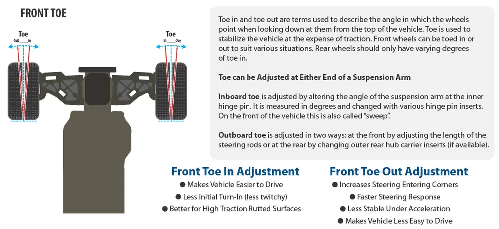

Hey all, I built a new et48 over the holidays. I built the front links using calipers to the size specified, as accurately as I could. The front wheels have a bit more toe out than I am used to. What is the right amount of toe out for stock setup?
on a smooth prepped race track I like to run about +1° of front toe just to get a little more steering, but for a first run out of the box setting, I would go with 0° front toe to play it safe.
Pretty good manual here worth a read:
https://www.teknorc.com/wp-content/uploads/2014/06/Set_Up_Guide.pdf
