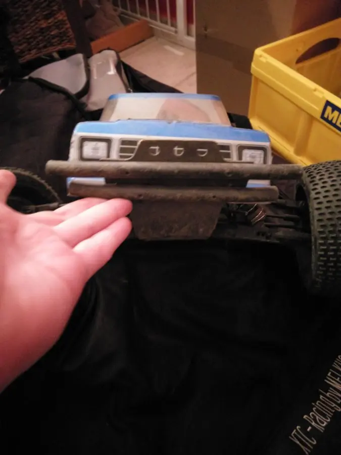

I do use the MT410 bumper from him. This thing took a good amount of abuse so far.
100% recommended.

By the way, for simple bumpers (1 piece), just buy one made for arrma and make 2 extra holes, that's what I did for bashing my eb48

I'm not home until friday otherwise I'd take picture and double check on the MT410, but the 2 outward (so front in the front, rear in the rear) holes are further apart on the Teknos, the inward ones are in the right position on the EB48.4 at least (front and rear tbone bumpers from the Typhon fit that way).
I have Talion, Outcast, Typhon bumpers and MT410 and EB48.4 to check what fits on what if you can wait.
edit: the most "difficult" is tapering the holes, I did it with a dremel conical grinding stone but I suppose there are better ways.

The screws under the car (into the diff) are fine, just needs two new holes, the distance / position of the bumper is fine too, but if you have a bumper with some second part that attaches to the hinge pins like this https://cdn.shopify.com/s/files/1/2135/5155/products/Talion_Basher2_1800x1800.jpg?v=1525907995 that's not working without quite a bit of work which I did not attempt. Nothing you can't do with a dremel, but not as straightforward.
So, perfect for single part bumpers (like on the Typhon / EB48 which is what I did), but only the main bumper part on the heavier / bigger cars unless you have much patience, or skip it.
I'd get a POS from POS as they offer 50% off on replacements, and I might just have been unlucky with mine.
