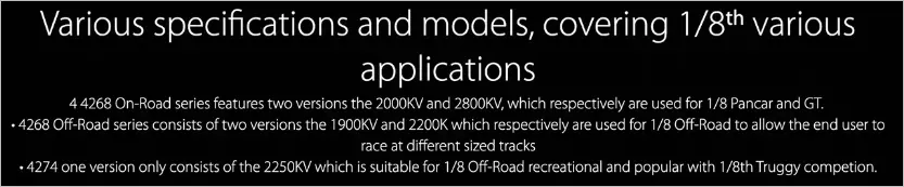

What size is the 2250 motor, if it’s a 4074 or similar then it would be a truggy motor. If it’s smaller it would likely struggle a little in a truggy due to the weight and increased rotating mass in the tyres.
Hobbywing's G3 2250kv motor is a 4274 sized can... perfect for 1/8 scale truggy...
