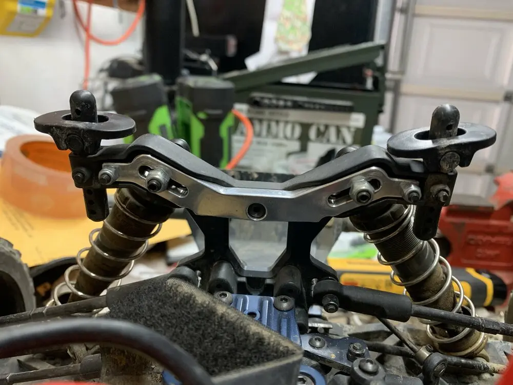

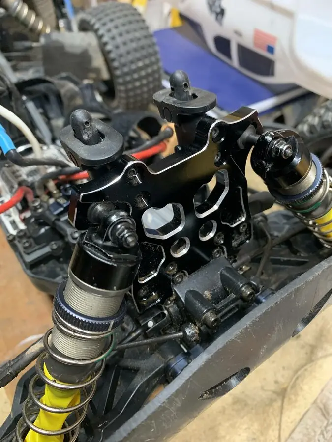

Second option: the Go Big kit (and tower braces) from m2c (here a picture of the front)
Here is the rear:
While m2c (https://m2cracing.net/) and mmm (https://www.mmm-germany.com/) have moved to a stronger towers options (see below), this is kit is still a great solution!! It will dramatically improve the situation and will be more than enough to handle up to medium bashing.
I would mainly do the back tower and possible front as well. This kit is mainly a chassis brace kit but will very well work for helping body mounts as well.
Front brace: $26
https://m2cracing.net/tekno/263-m2c-6760-tekno-mt410-front-upper-shock-tower-brace.html
Rear full kit: $84
https://m2cracing.net/tekno/304-m2c-6970-tekno-mt-410-go-big-rear-tower-chassis-stiffiner-kit.html
Note that the above kit also includes this tower brace: https://m2cracing.net/tekno/305-m2c-6971-tekno-mt410-v3-tower-brace-.html
This part is totally underrated, it is critical! It makes no sense to install a beefy tower on the gearbox with 4 flimsy screws. This brace solves that problem.

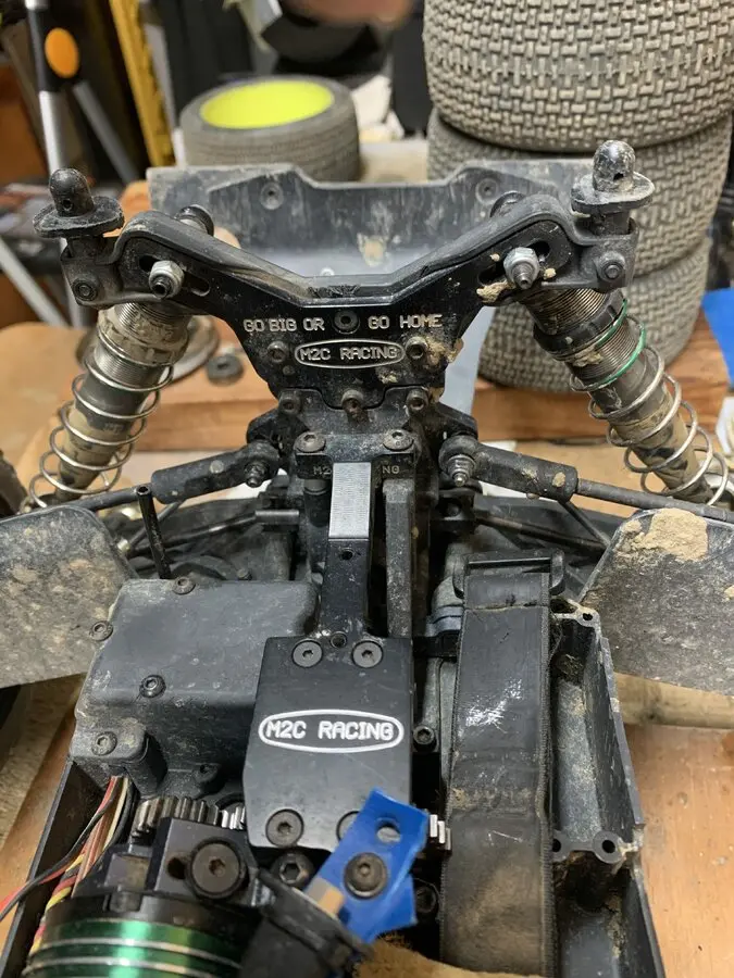

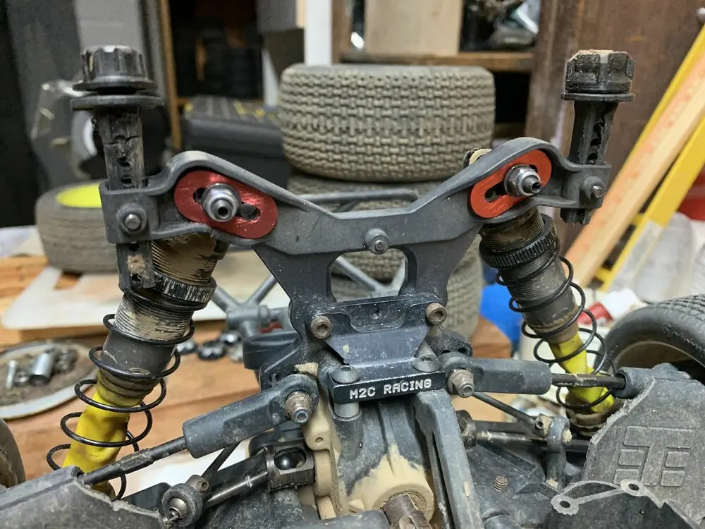

Here is an example of doubling the rear plastic brace (the an NT48.3 second brace):
Note: this truck also runs a stiffer M2C chassis
This is a chassis stiffener from MMM: (yes that little metal part that sits between the two plastic braces). Great way to reduce flex without removing it completely.

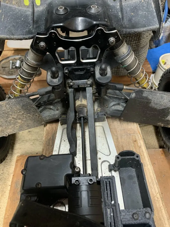

And of course the full aluminum bracing:
You can really tune your build for what you want to do with it.
Pro of full bracing:
+ driveline is safe
+ makes a very "precise" truck to drive (I like that feeling on the SWB MT410)
Con of full bracing
- there is no more flex at all, parts will resist heavy crashes until... they don't. That is when aluminum starts to bend. Can this be counterproductive? Yes, if you're bending a part that is more expensive than the driveline that you are trying to protect.
- in order to save some flexibility, you need to invest in more protective aftermarket bumpers
