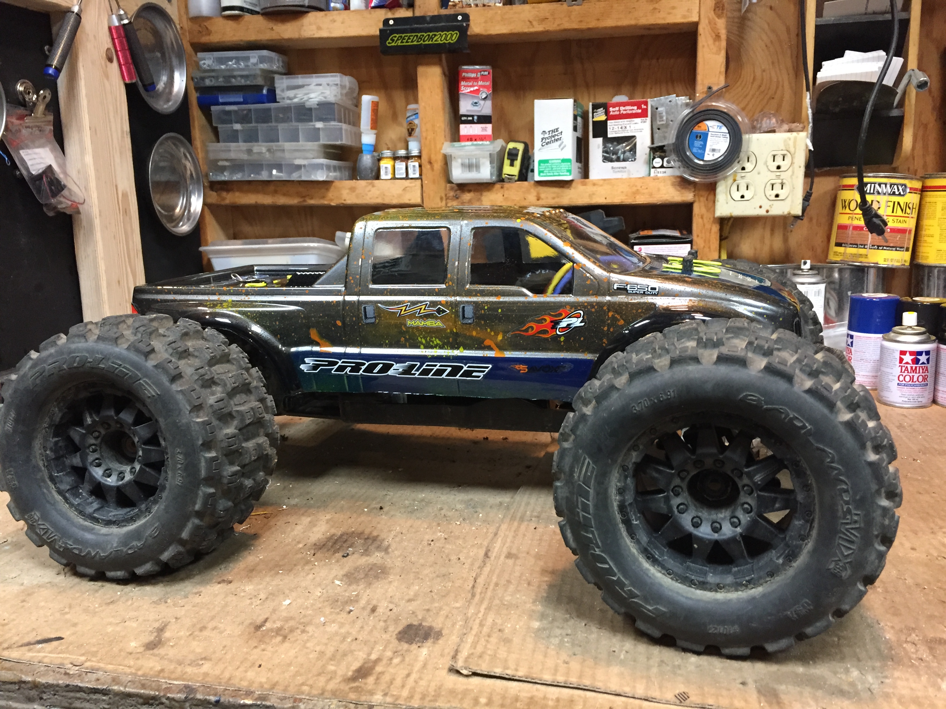

I have a Proline F-650 for my et48 monster. But they are hard to find.

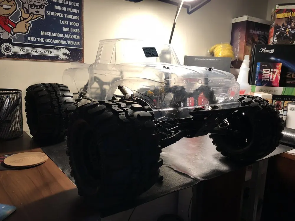

I'm wanting to do this conversion too. A savage XL body fits pretty well.

I got a proline topkick body that's made for the savage xl. I thought it would fit but its not even close.

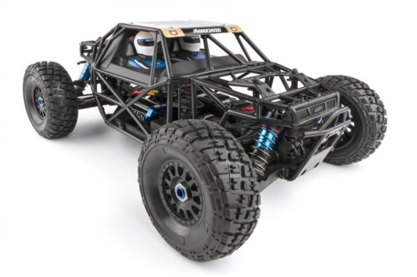

The team associated Nomad DB8 cage will fit the long chassis. It’s the right length /wheelbase. Guys use them for lengthened sct410 to make db8 buggies

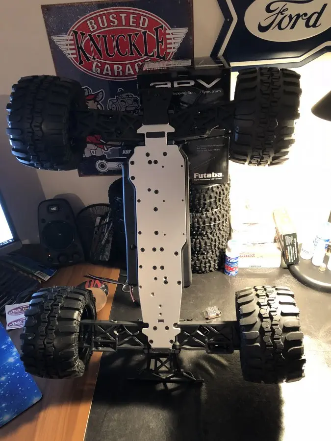

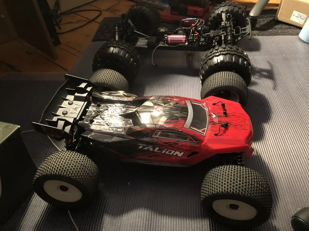

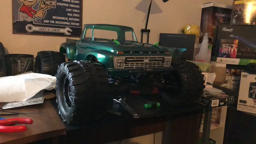

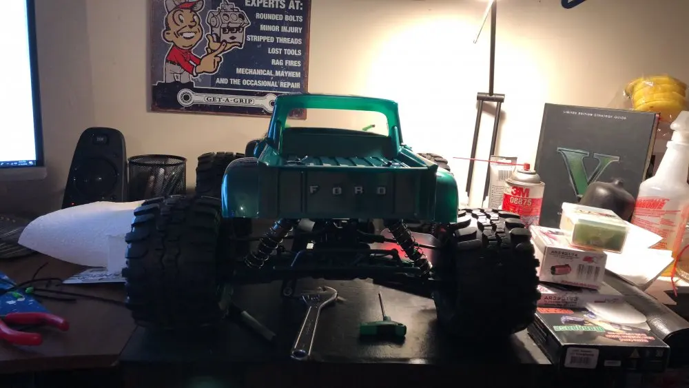

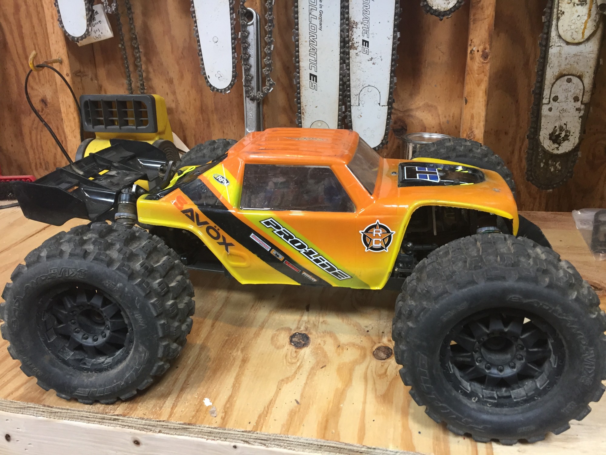

Here’s another body that I have for my et48 monster

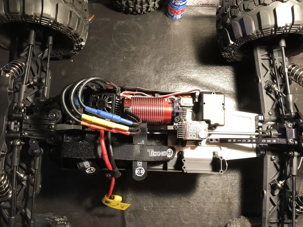

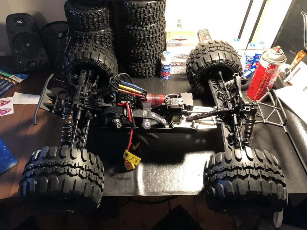

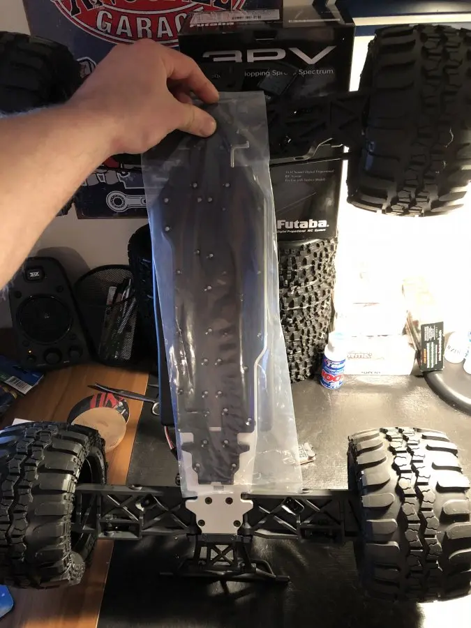

I am going to do the conversion soon. I have the chassis from my ET since I put an m2c chassis in that. Have the cage and a 1/8 VW body to play with., We'll see what developer, lol. The long chassis handles better but less wheelies.

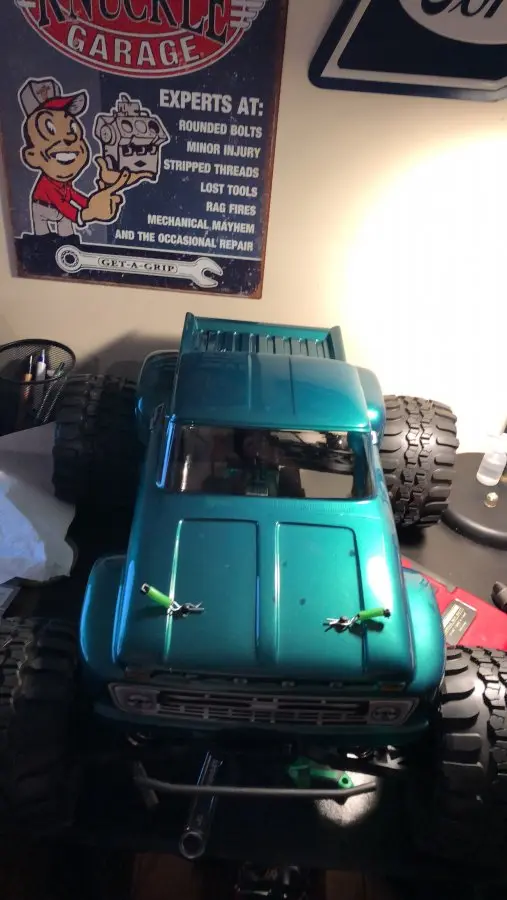

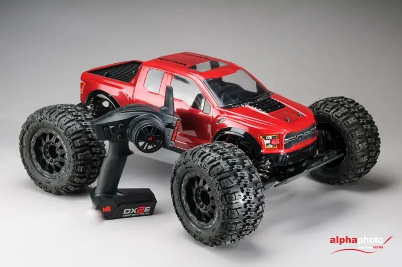

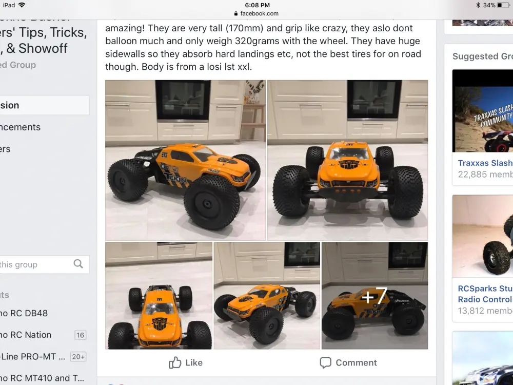

Here’s another very nice body option for the long chassis MT410
This is a screen shot from FB

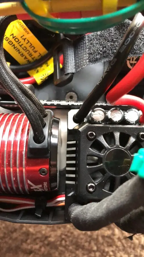

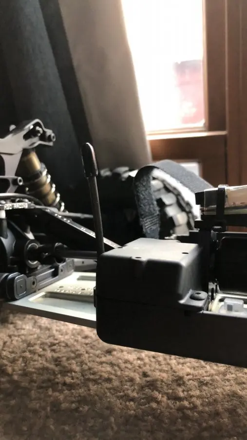

How do you like this motor ? I have the same in my et48.3 and it overheat end cog at low speed
