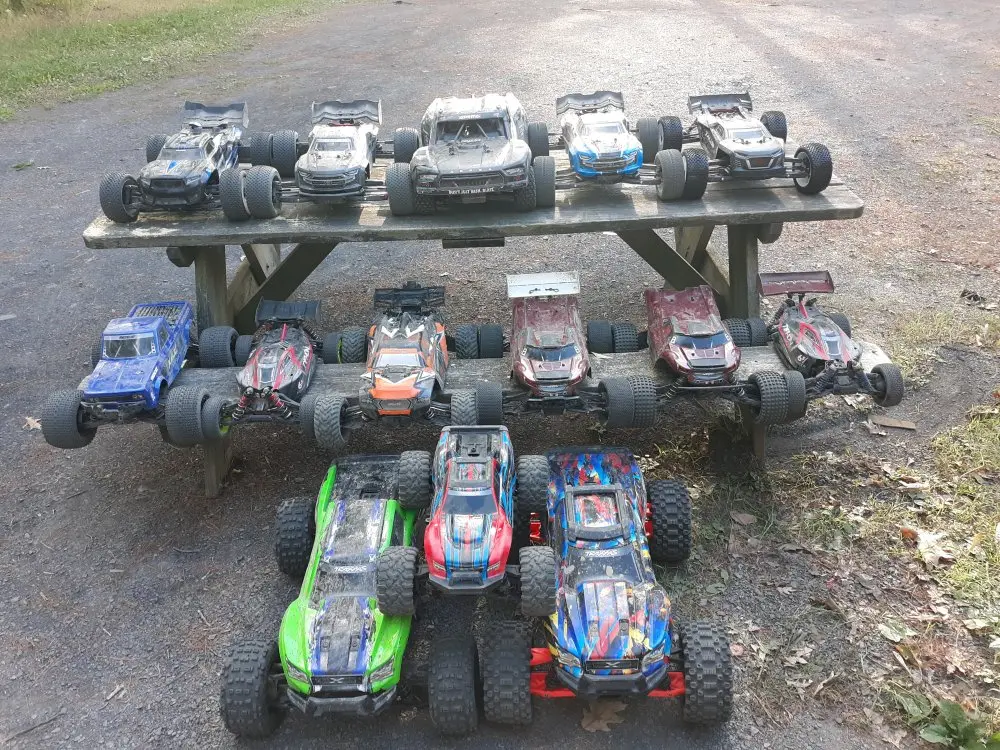

My brother and I are in our 50's, both empty nesters. Kids are all grown,now it's feasible to have a fleet of rc's. We don't do the stunting thing either, I'm over it already. We made a track on my property that we "race" on..sometimes it looks more like demolition derby,lol. Here's a pic of some of ours.

Cool, nice rigs! Wish I had room for a basher track. That would be so fun. I have a nice bash spot though. No one bothers me there.
