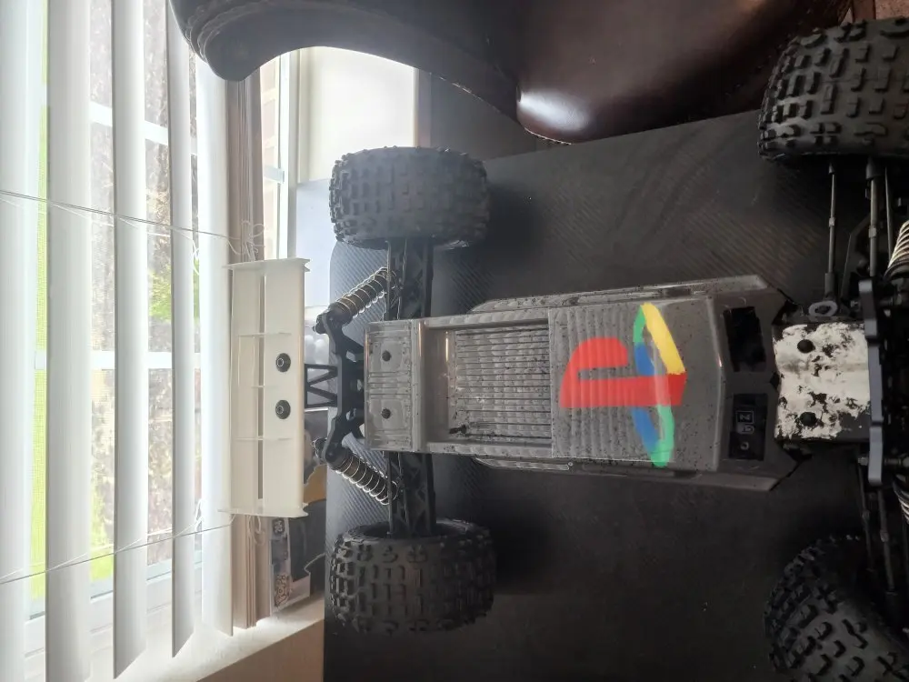

I am between 1515 or 1520 from castle and I have been going back and forth, haven't yet pulled the trigger!. I would like to be able to run 4s for club racing around and/or 6s for light racing with my friends (no motor limitation requirements as it will be on tracks and motocross tracks for fun) and some light bashing around.
Putting aside making adjustments for gearing changes between running 4s vs 6s..what is your guys favorite motor that can handle 6s?
