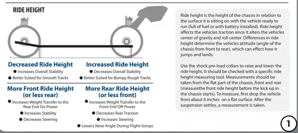

Generally, both the front and rear ride height is the same, but not uncommon to set the rear higher to suit your tuning needs, normally you don't want to go more than 2mm different between front/rear:
https://www.teknorc.com/wp-content/uploads/2014/06/Set_Up_Guide.pdf
