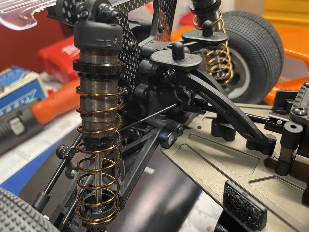

Thanks for response.
droop measured at rear shocks is 107 mm
ride ht set to 23 mm

Wow that looks like you have front springs on the rear???
The shock mount positions are they stock from the manual?
You're droop is measurement is taken at the centers of the upper and lower mounts? The droop doesn't look excessive to me at all.
Another question, your ride height is being measured when you have the battery and body on isn't it?
Sorry to ask these questions I'm sure you've got this all right, but I'm clutching at straws here, the truck looks beautiful though!
followed tekno directions to the tee.
measured center to center shock mounts.
ride ht measured front of droop tabs.

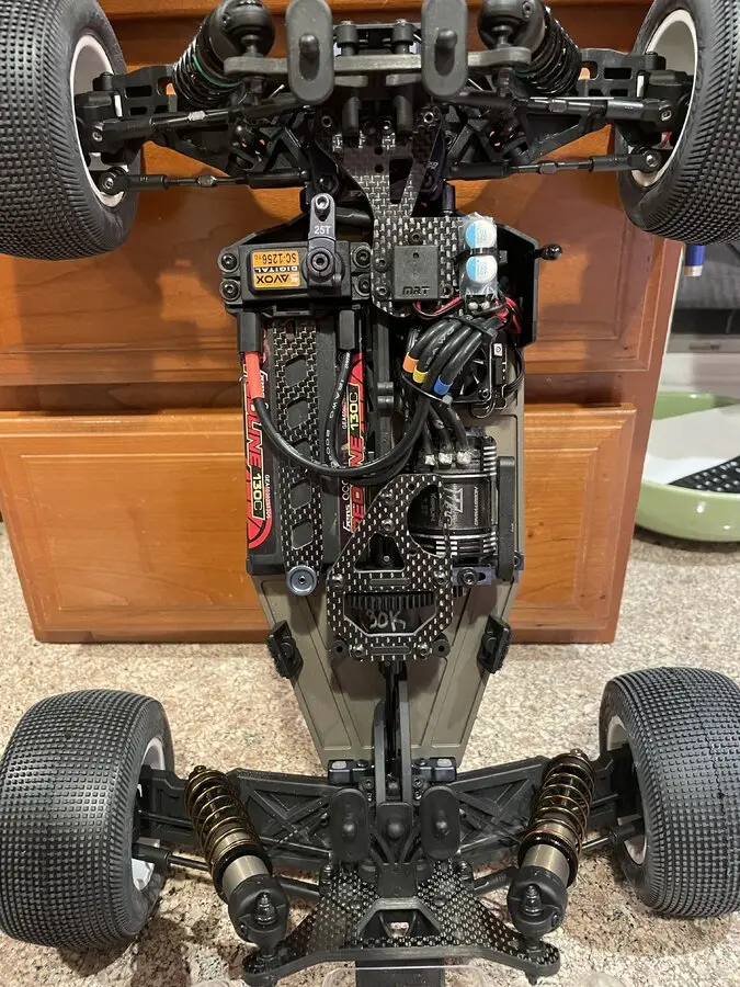

this one was a real challenge to squeeze all electronics in front of esc.
i modified carbon fiber esc mout and added a second level for trans and capacitors.

The steering links looks very close to the inside of the wheels, is there enough clearance there? It may just be the angle of the photo.
The build looks amazing, you've done a really great job!
that is normal, always seen loose springs since I ran the .1 many years ago, never had an issue with it.
