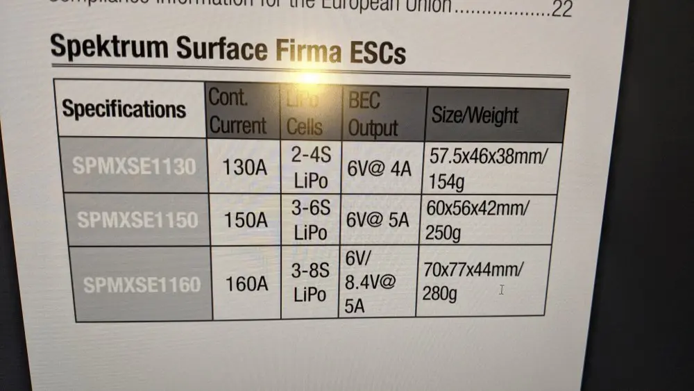

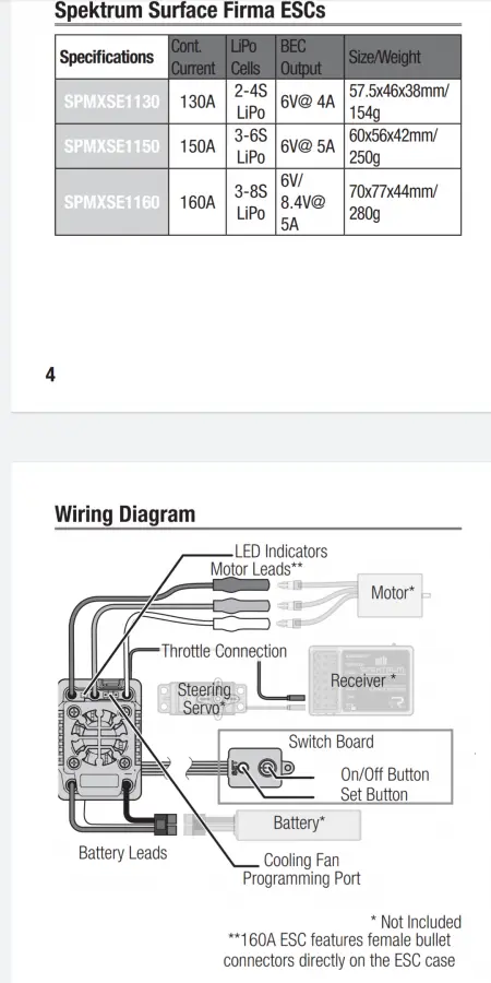

How much space do we get play with for an ESC ? Or does it depend on what motor size we use. Had a look in manual couldn't find any info cheers.

Man I thought the MMX was big....that thing is huge! I just did a rough check (without calipers) and that will not fit in any direction you try to fit it.
Check out the MMX dimensions...thats about as big as you can fit, maybe a touch bigger but you may start having thing touch during flex if you go too big.

You know I just assumed you were talking about the 160a one. The 150a may fit since there is more room, it would be tight though.
yeah was talking about the 160a, manly want to try the spektrum for the smart stuff thought could be interesting but maybe should of just stuck with the hobbywings. Thanks for the help.

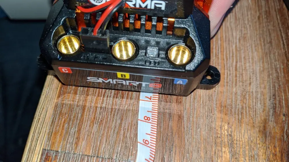

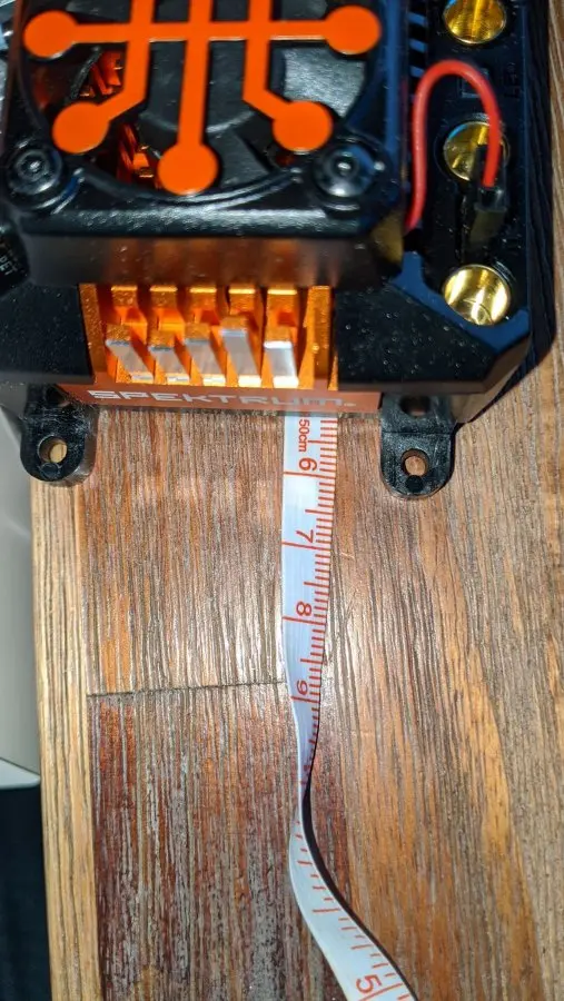

Ok after taking the firma 160a out of box, i still dont think it will even fit the ET48.3 with the M2C chassis. with out screw holes its 52 x 67

I can get a hard measurement for you later but maybe if you cut those little tabs off it wold fit. I will check and report back when I can later today.
cheers thanks heaps for checking that for me, new ESC it is than :) back to drawing board, HW MAX 8 AND TEKIN r8 GEN 3. As even the 150a spektrum will be tight.
