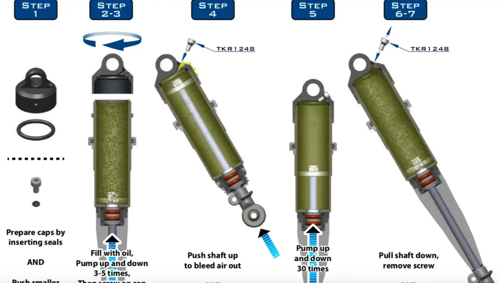

This is a screen shot from the eb48.4 manual.
  1. Step one; insert o-rings into caps.
  2. Step two/three; shows the o-ring in the cap
If there is a side vent on the cap the o-ring needs to be up top.

Thanks this is exactly what I needed. Saving diagram for build. (y)(y):)
