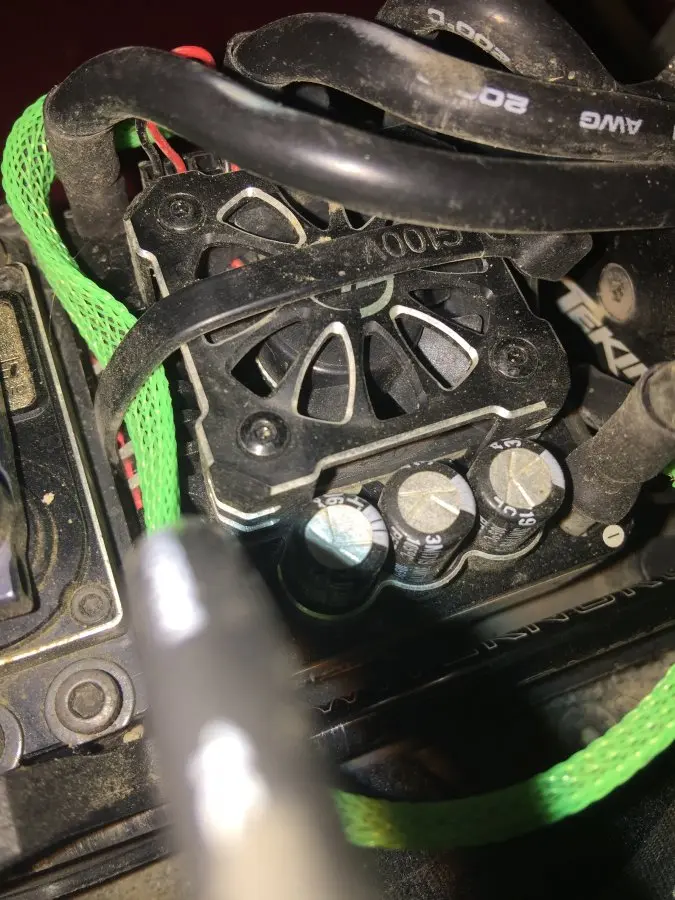

I built my mt410 a while ago, but i finally got my electronics to put in there.
However, I have some questions for placement.
I bought the hobbywing Xerun 150A esc + 2250 kv combo.
It's a big esc. And i was wondering something for the placement. How do you mount it? I know you can attach it to the esc plate from tekno.
But would you place the esc on the plate it comes with first, or don't bother? Could it have it's advantages with regards to being an extra shock absorber?
Or is it useless, and would I just need to place it on the tekno plate?

Dont use the plate that the ESC came with. Some use ,velcro, double sticky tape, zip ties or a combination of zip ties and one of the other two. I personally use double sticky tape (adds a little cushion under it too) then zip tie the esc to the plate.
