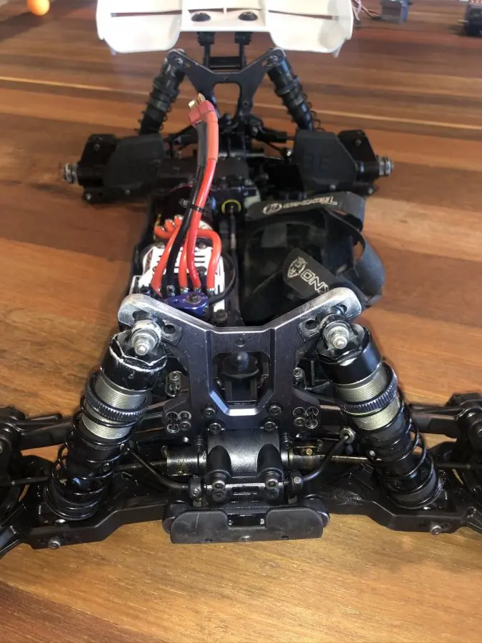

I picked up a new to me EB48. It was advertised as a .2, it came in a .3 box and has an original EB48 manual ??
Anyway, can anyone tell by looking, which model it is? Also, if it's a eb48, what .2 or .3 parts will work so I know what spares I can buy?!

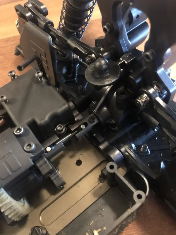

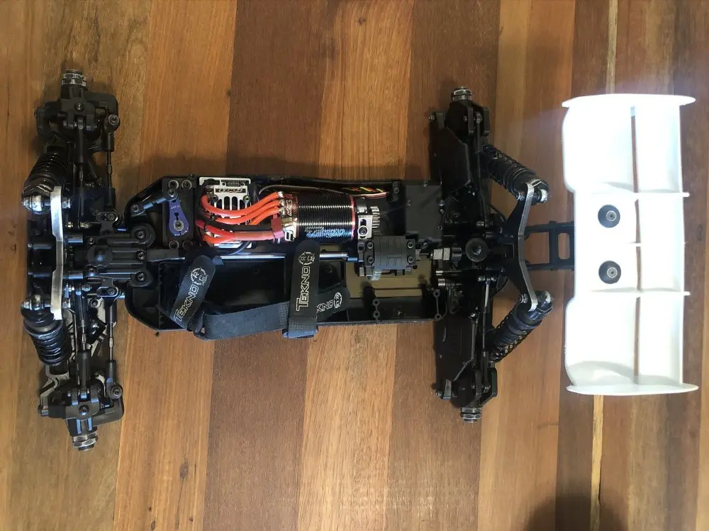

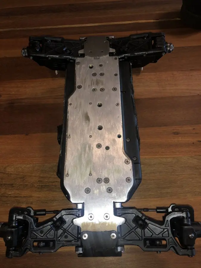

This is the best I can do until I get off work.

It looks like a .2 with those arms, the round pivot blocks, center diff mount and the outdrives, but it's still hard to say for certain.
Either way, if it were me the first things I would start upgrading as needed would be the .3 hinge pin blocks, arms and pills. You cannot use the .4 arms and blocks unless you got the .4 chassis.
Then maybe the center diff mount simply for ease of access for working on in the future.
You can upgrade the shocks and towers to the bigger .3 versions. The .3 uses in front what the .2 uses in the rear and the .3 rears are bigger.
And lastly if you wanted to update the steering to be the .4 geometry that would make it pretty much as up to date as you can with that chassis.
Maybe if you want to experiment with different shock setups get some caps so you can try them with an emulsion set up rather than a bladder.
From my understanding pretty much anything that breaks on that thing can be upgraded to at least the .3 version.
