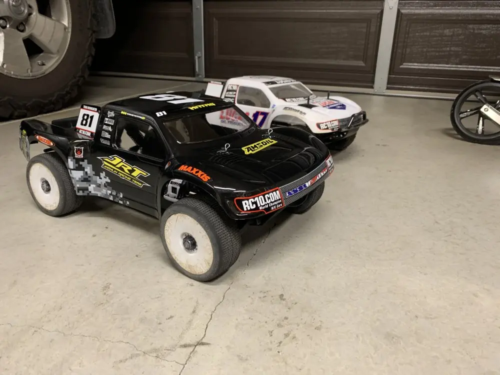

On my EB48.4 SCT conversation
I never tried the side trays. I run the proline bash body it’s nice and strong no need for the side bumpers. And for now to keep the dirt out of electronics I Velcro a buggy body to the chassis
I never tried the side trays. I run the proline bash body it’s nice and strong no need for the side bumpers. And for now to keep the dirt out of electronics I Velcro a buggy body to the chassis View attachment 5687
Very nice. Is that just the regular Flo-Tek bash body or the monster tires version? Looks like a good fit. I might get one of those. Part number? Thanks.
P/N 3498-15
it’s the ( monster slash ) to be used with MT tires
has the lager wheel arches and I have no rubbing issues
