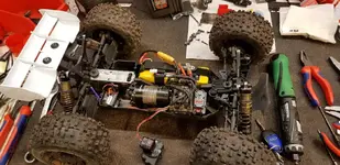

3.8 Badlands on EB48.4.
Not enough clearance to the shocks on full stearing with stock hexes. I installed 25mm offset ones for pictures. Nice wide stance, i will test 15mm offset hexes tomorrow - im kinda positive even 10mm would be enough..
15mm offset hexes with badlands 3.8, still alot clearance on full stearing.
So i am confident 10mm offset hexes would be fine, however i like the wide stance of the buggy and will keep it like that for now.

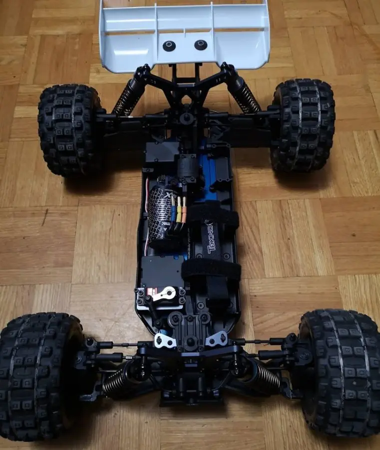

Coming together.
