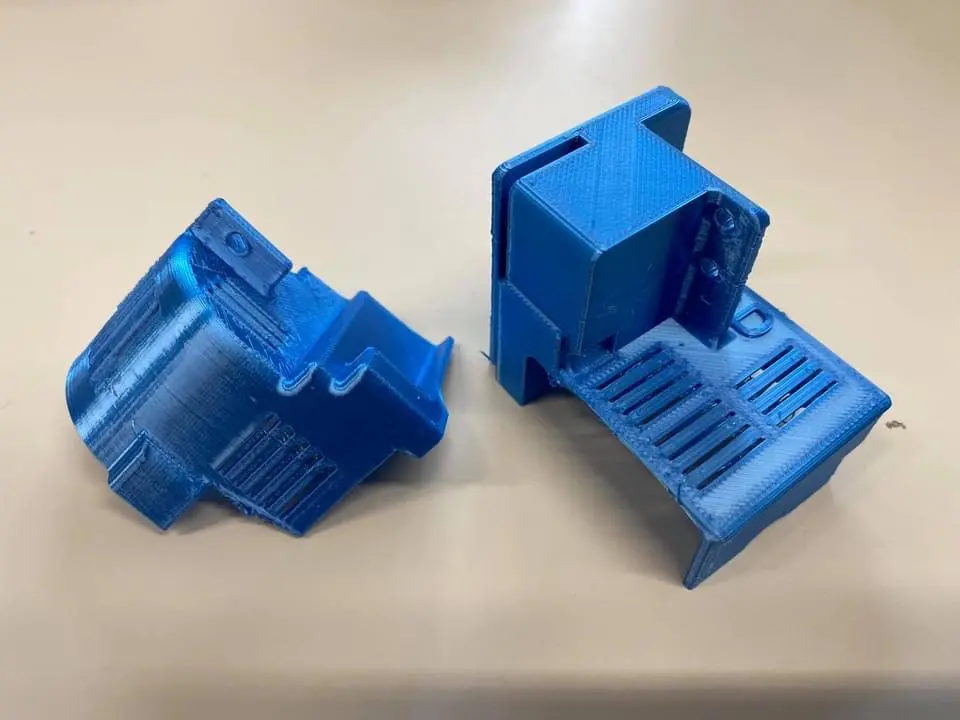

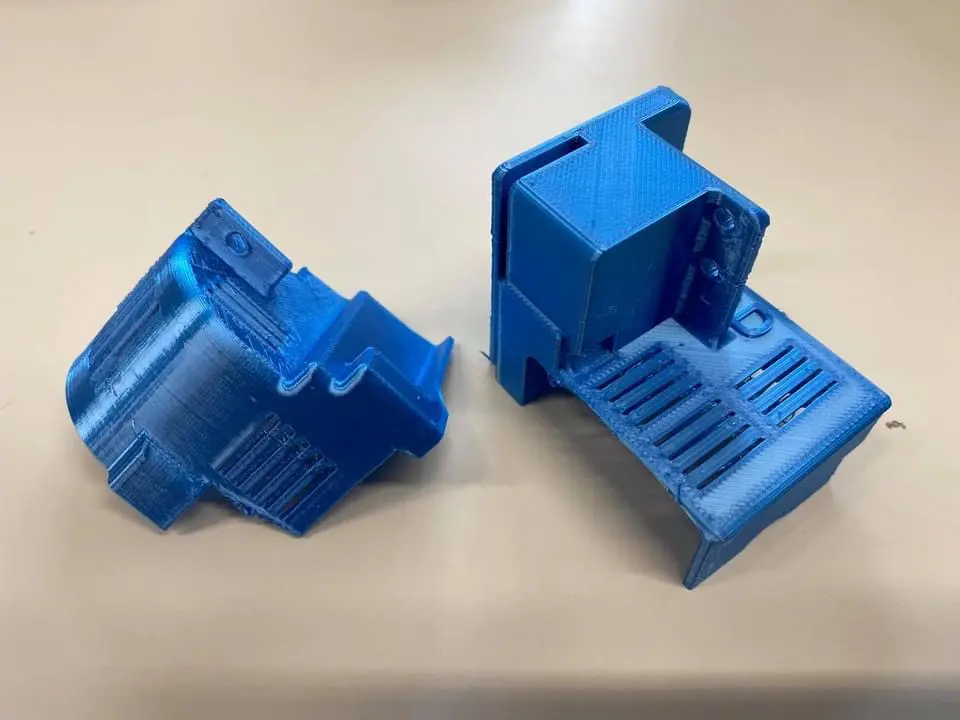

Try to 3D print diff guards. Those ones fit tekno 1/8.

Mann I've been long wondering how come no one had designed a 3d printed pinion and spur cover for de Tekno's. These should be readily available. Good data @Nicochau . Just found it in thingyverse.
https://www.thingiverse.com/thing:3346198
@VRC regarding your issue, a simple solution that might work, if you don't have a 3d printer or nowhere to print near by, could be to cut out a front mudguard out of lexan going from the base of the chassis to the underside of the body. I am considering to do this on my almost finished ET48.3 for which I want to try and avoid such problem before hand. Will need to cut out an opening for the servo horn and tie rod to pass through it. The mud guard could go between the steering rack to the front and the servo case and battery tray to the back. Fixing the piece could be done by bending out a piece of the lexan mud guard and screwing it together with the center screw of the steering plate. Then some double sided tape on the base of the servo case and the battery tray and that should be enough to hold it in place.

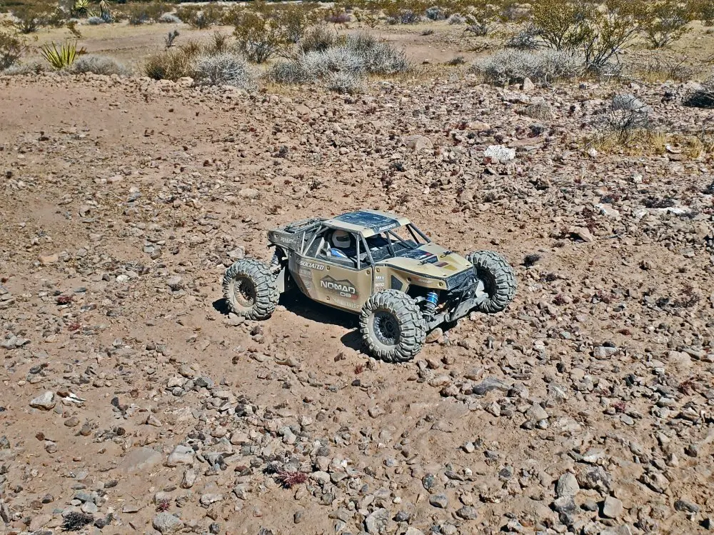

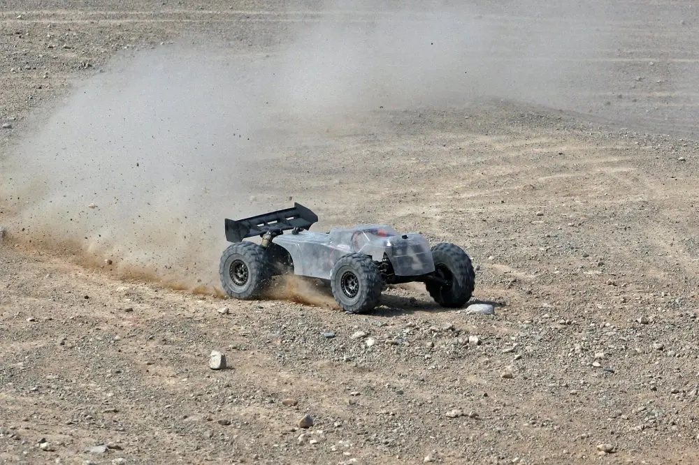

After each desert track session costing me about $100 in parts, I gave up and converted the DB-48 into a grass racer. As much as I like the Tekno, it's not up to the task of our desert racing. As a grass racer, the Tekno can be a Tekno and showcase the precision handling and performance that they have built their name on. On our desert tracks, it's tricky to get more than two laps done without jamming up the drive train.
A slot underneath the spur gear will help, and this guard might also. It still won't solve the rocks getting jammed between the battery and ESC, grinding or locking your front drive shaft. I think to solve this, you need the slot underneath the spur gear, and then a well-fitted dust bag over the entire chassis. In our temperatures of the Southwest, it's not going to work. This sucks because the Tekno suspension is superb.
Snap my fingers and build the Tekno on the Team Associated chassis layout, and it would be the benchmark for desert racers.
I'm very happy with mine as a grass racer now, and I'm really enjoying the handling. It's fast and nimble, and then Tekin motor gives explosive speed.
Topic drift....

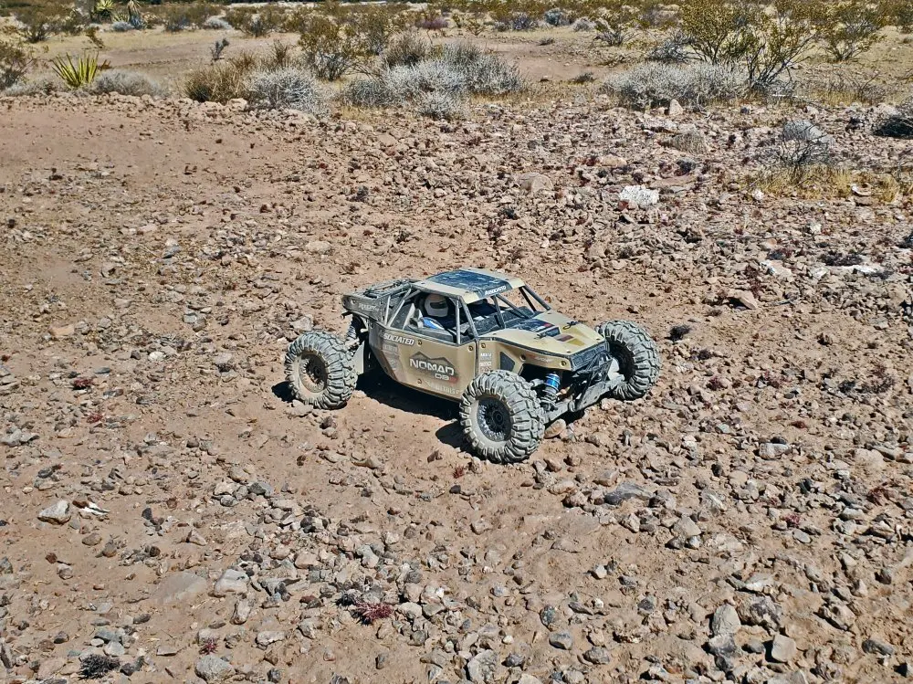

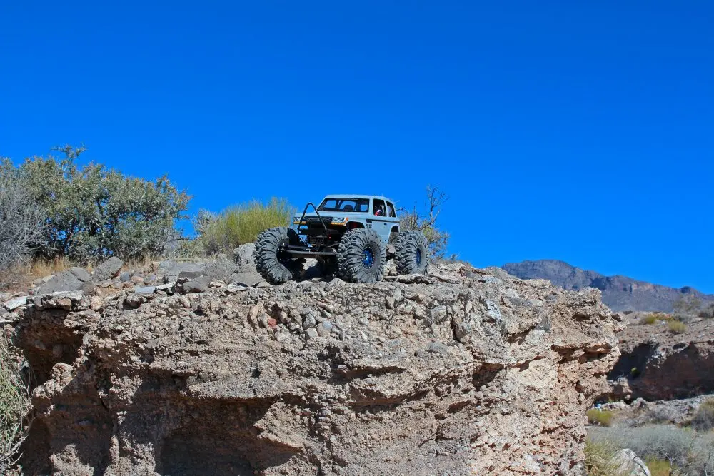

I feel the term "Desert Buggy" is loosely thrown around, but if you look at many of the Rock Racing tracks in So Cal ( which was the birth place of the DB-48 ), those are groomed tracks with some built rock features. As Bill noted, track prep can help reduce the number of loose rocks on the course, but then you have a track and not the desert, and there is a considerable difference.
Oscar jut posted some videos on IG from his U4 Rock Race last weekend, and while it's pretty blown out and dusty, there are very few loose rocks. Some water and that would be an awesome and fast track.
We are building a new desert track, and there is no way to remove the rocks ( nor do we want to ). Raking them aside leaves dust and smaller rocks, and after a dozen or so laps, the dust and dirt is blown out and you uncover the next layer of rocks. That's the composition of the Mojave Desert; rock, sand, dust, and a small bit of dirt, then more rock. We remove the larger A-Arm-shattering rocks but anything walnut-sized and smaller stays.
This is a desert track, and the Nomad is a true desert buggy. That said, I really struggled with the wide stance these beadlocks require, and I switched to a much narrower setup and taller tire.
Anyhow, just my take on the situation.

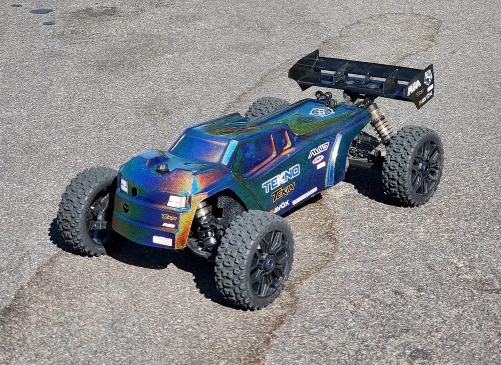

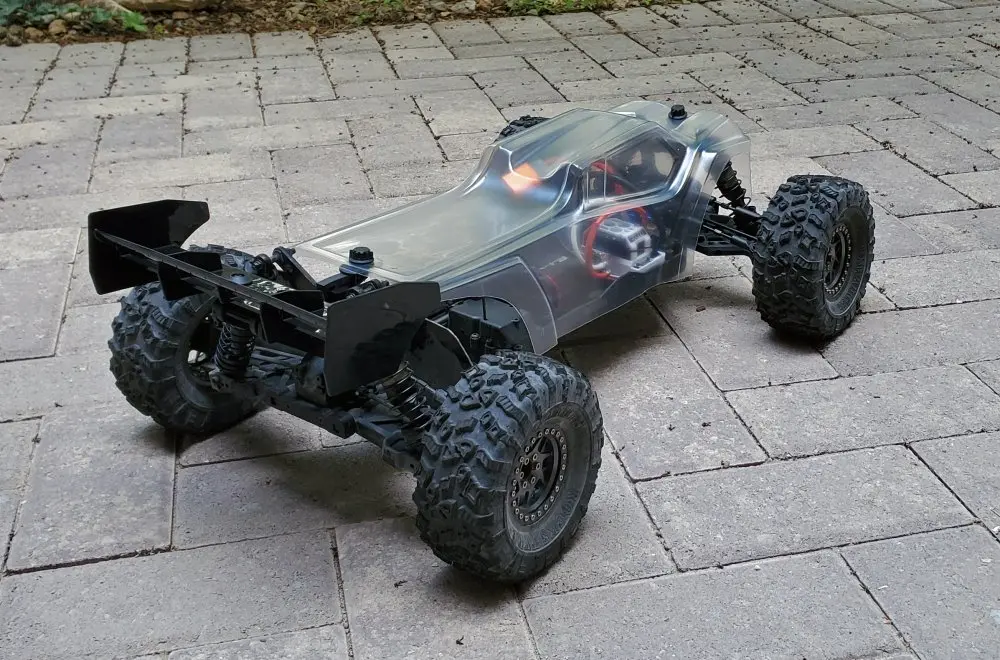

Steve b . I’m in the same situation regarding rocks and loose dirt. There’s no way to get rid of it around Here. Also, there is no grass around me to drive on. I am pretty determined to figure this out as like you said. These Tekno are really nice to drive and tough. What are the widest tires you were able to fit on your db?
VRC,
I mounted up beadlock wheels with Vanquish SLW hub extenders. There are so many 2.2 tires to choose from and the ability to clean and tune the foams was the main driver. Getting small bits of rock and dirt in the tire will ruin the foams quickly, so that was the thought process.
Here is a photo with the wheel and tire setup. I have 6 sets of Vanquish wheels with different tires, but these were just for the initial testing, and I was very pleased with the results. They are Pit Bull Rock Beast knockoffs. Interesting, they are a harder rubber than the real Rock Beasts, and handle the dirt track conditions exceedingly well.
