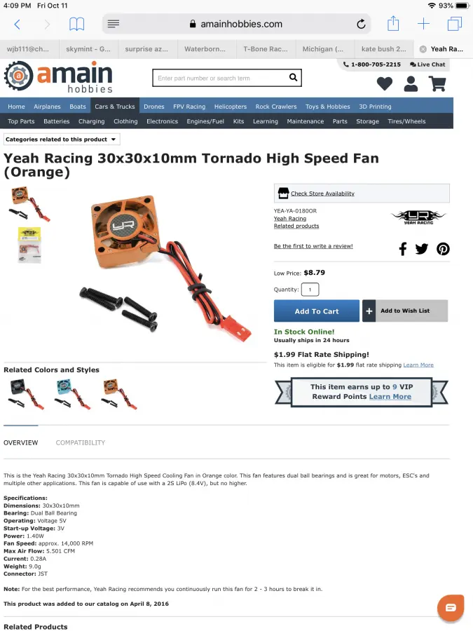

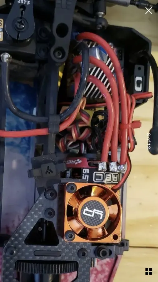

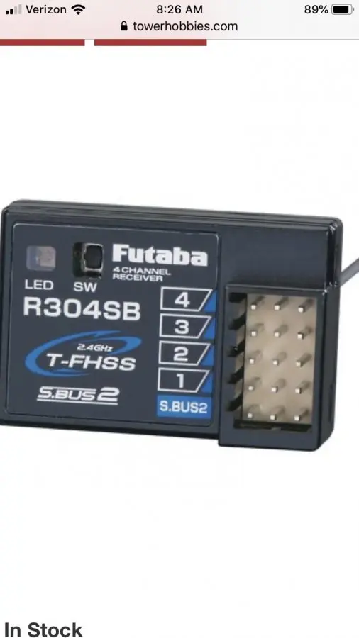

Picked up a nice used EB410 less transmitter and receiver. It has a YR motor fan and I don’t know where to hook it up. I tried ch3 on my Futaba R304SB receiver but started smelling hot wires. ?. The fan is a jst connection. ESC is a Tekin RSX.
Any suggestions would be great.
Thanks
Bill B

normally those jst connectors will fit the servo pins just fine, just need to make sure you have the polarity right, I think the negative lead is the pin on the far outside edge of the Rx
Chances are that’s what I didn’t have quite right. I will try it again but black to the outside.
Thanks
