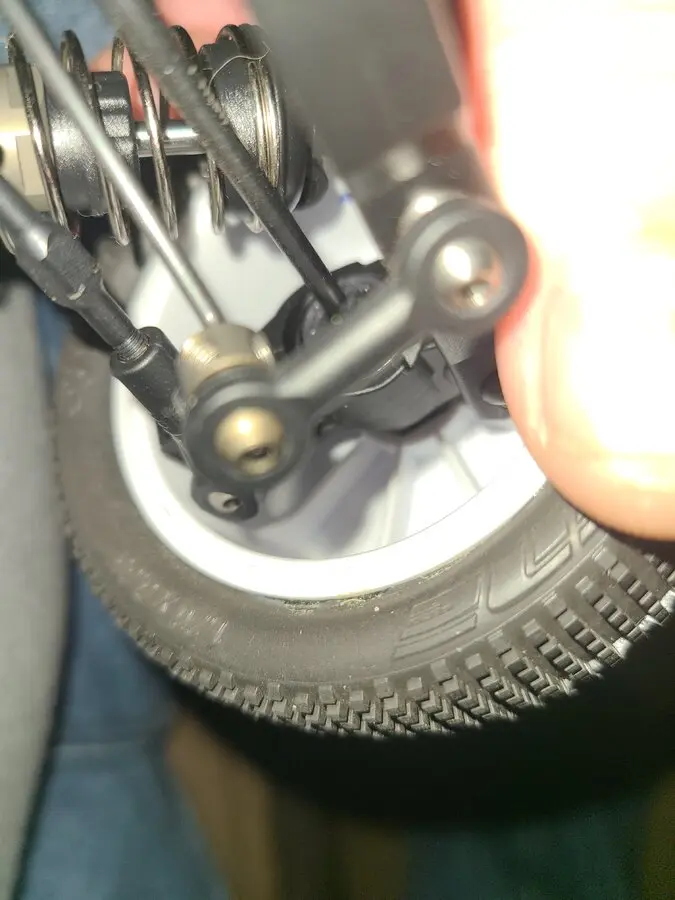

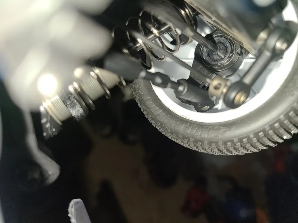

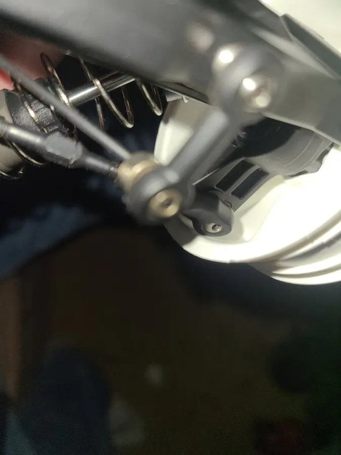

I'm having problems finding the correct wheel for my EB410.2. I have gone to the Proline web page used their wheel chart and ordered what is recommended. Did the same with DE Racing as well as went with the knowledge of my local hobby shop and purchased a set of J Concept wheels. I have no issues with the front wheels only the rear wheels. All 3 wheels have interference from the rear hub turnbuckle end wanting to rub the wheel. Before anyone asks, yes I did go back through the build instructions to make sure I assembled correctly. I also did verify the inserts for the ball end on the hub are in proper orientation. I have included three pictures one of each wheel. Picture with thumb in it is the J Concept wheel, wheel with tire mounted is Proline, and just wheel is DE Racing.
What wheels are you all running for the EB410.2 where I will not have this issue.
Thank you all for the help.

I'm a dummy and my dyslexia got the best of me. Tekno rep returned my call and I have the rear hubs backwards.
